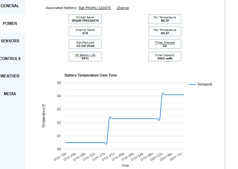

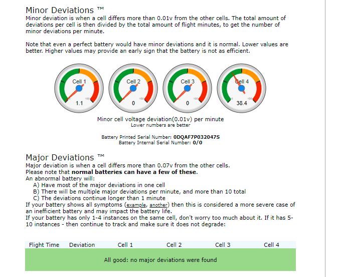

DJI battery?
Myself wouldn't use that battery again in flight,I've had a shut down also which destroyed my p4,used battery just for setting up ,,never trust a battery that's playing games,not cheap either
