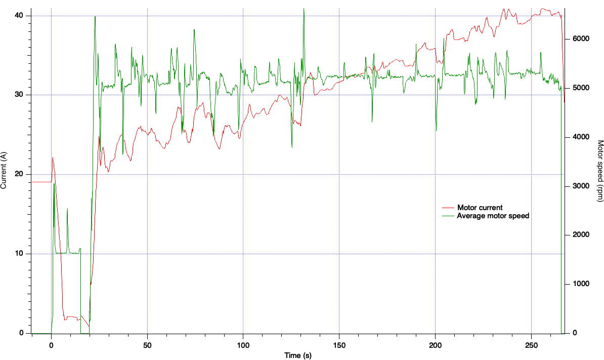

Interesting - FLY232.DAT contained the flight data, even though the txt log indicated a file index of 233. Anyway - this was an icing event. If you look at the motor current during the flight you can see that it rises with time to keep the prop speed constant as the drag on the props increases.
This is the typical signature of icing. Eventually the drag becomes too large, and the motor obstructed messages appear, and then finally ESC stall and motor shutdown:

Yup, icing of the props. I had similar icing with my Air the other day. Likely as the ice accumulated the lift created decreased causing the motor to spin faster to maintain position... or drag was the cause.
Eventually the ESC got spooked with the anomalous RPM and odd movements and shut it down.

As you can clearly see in post #34, it was drag, not increased motor speed, that caused the problems.
