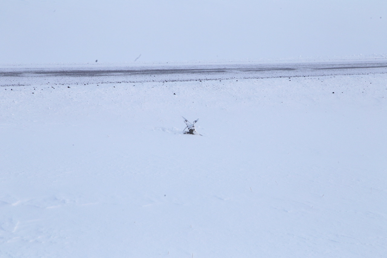

Any further away and it may have been difficult to locate a downed white Phantom.
