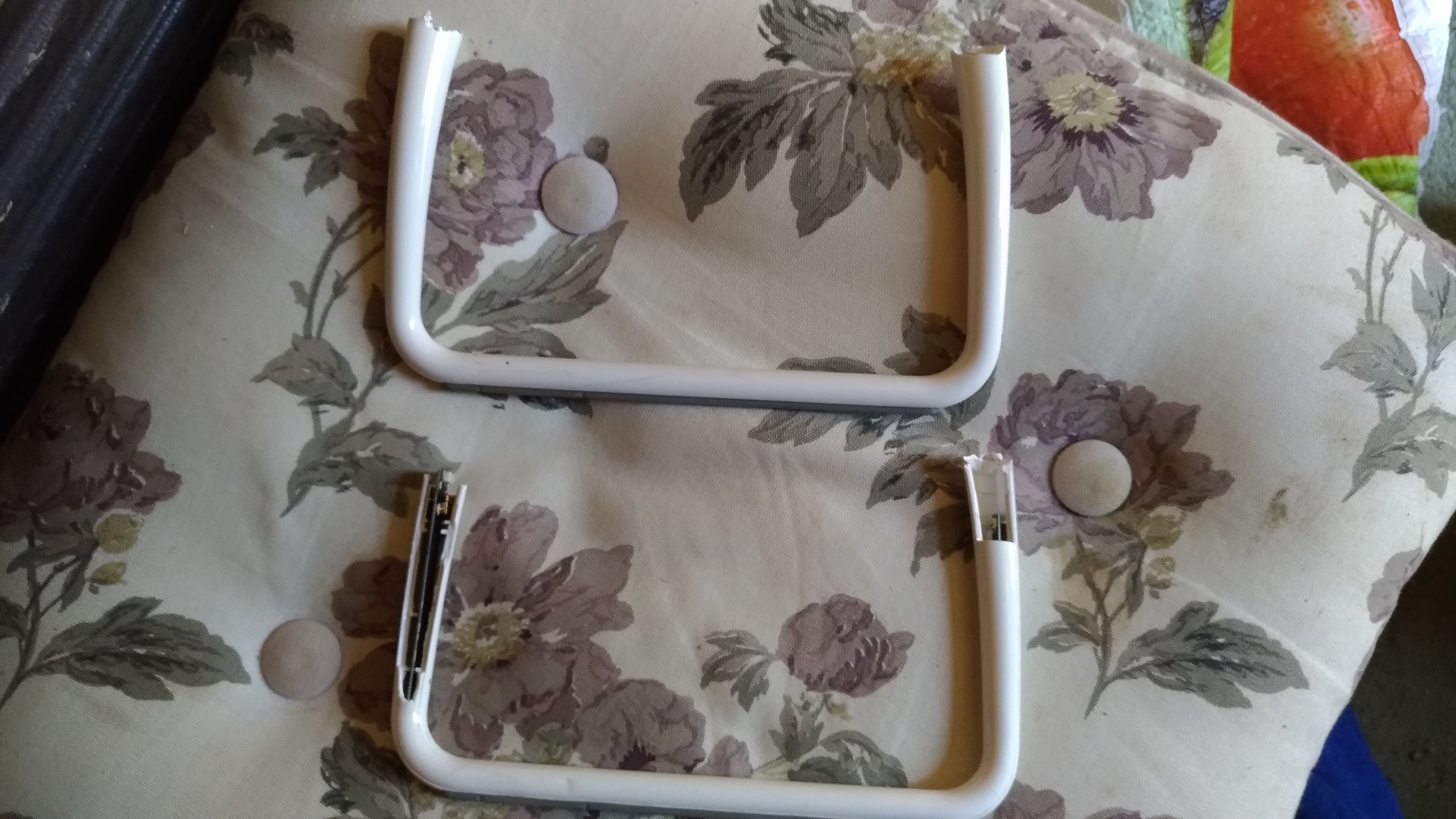

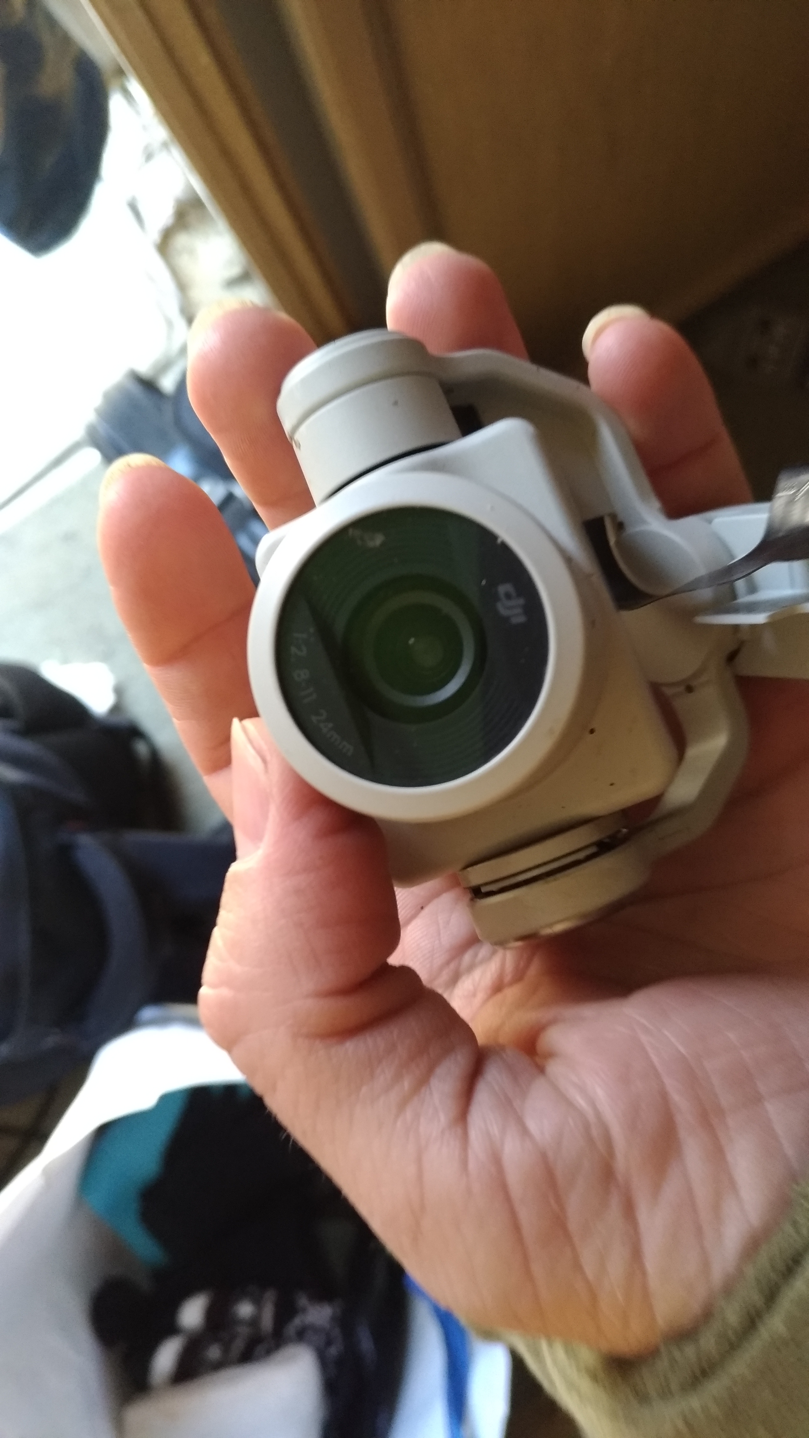

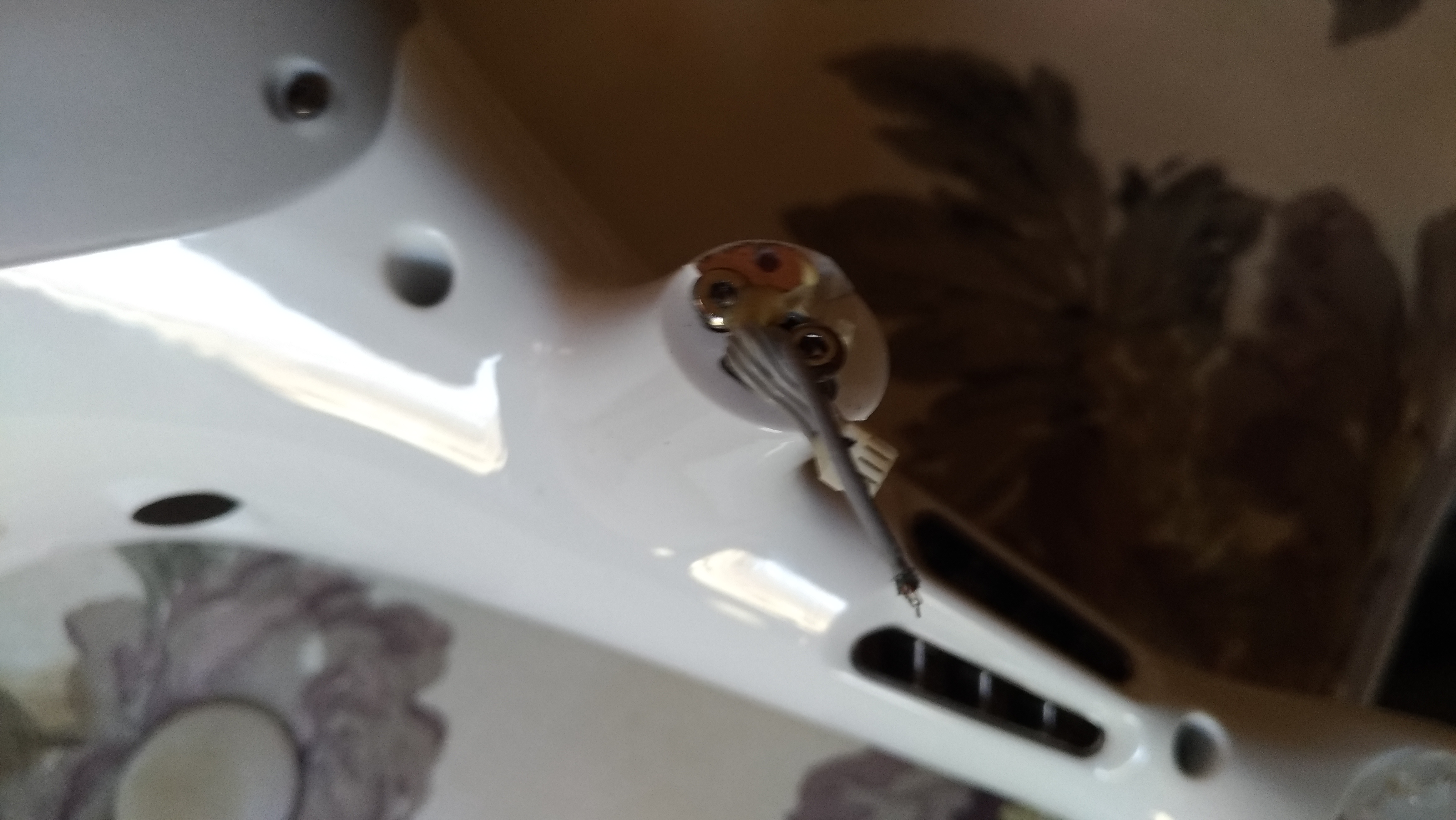

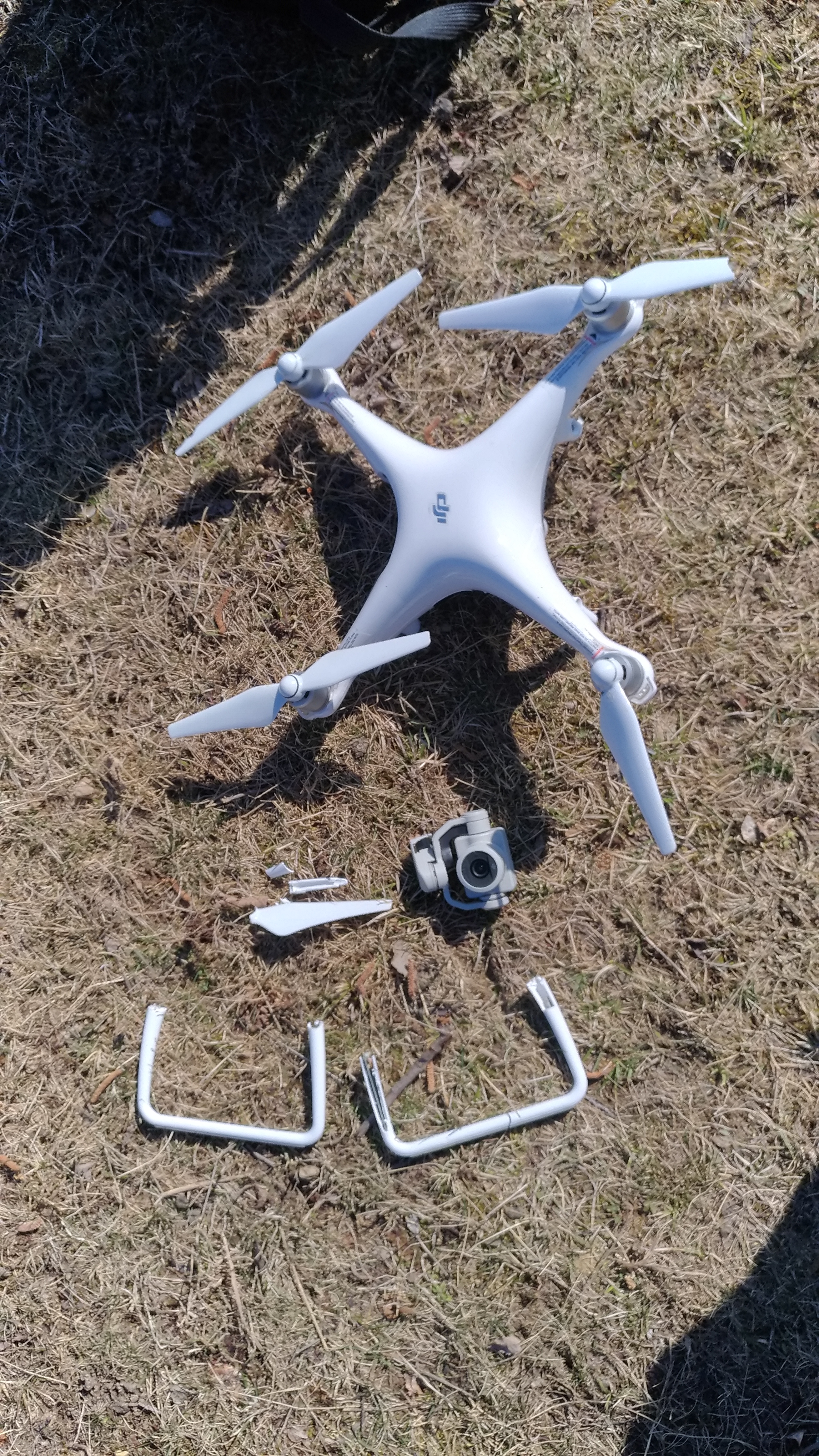

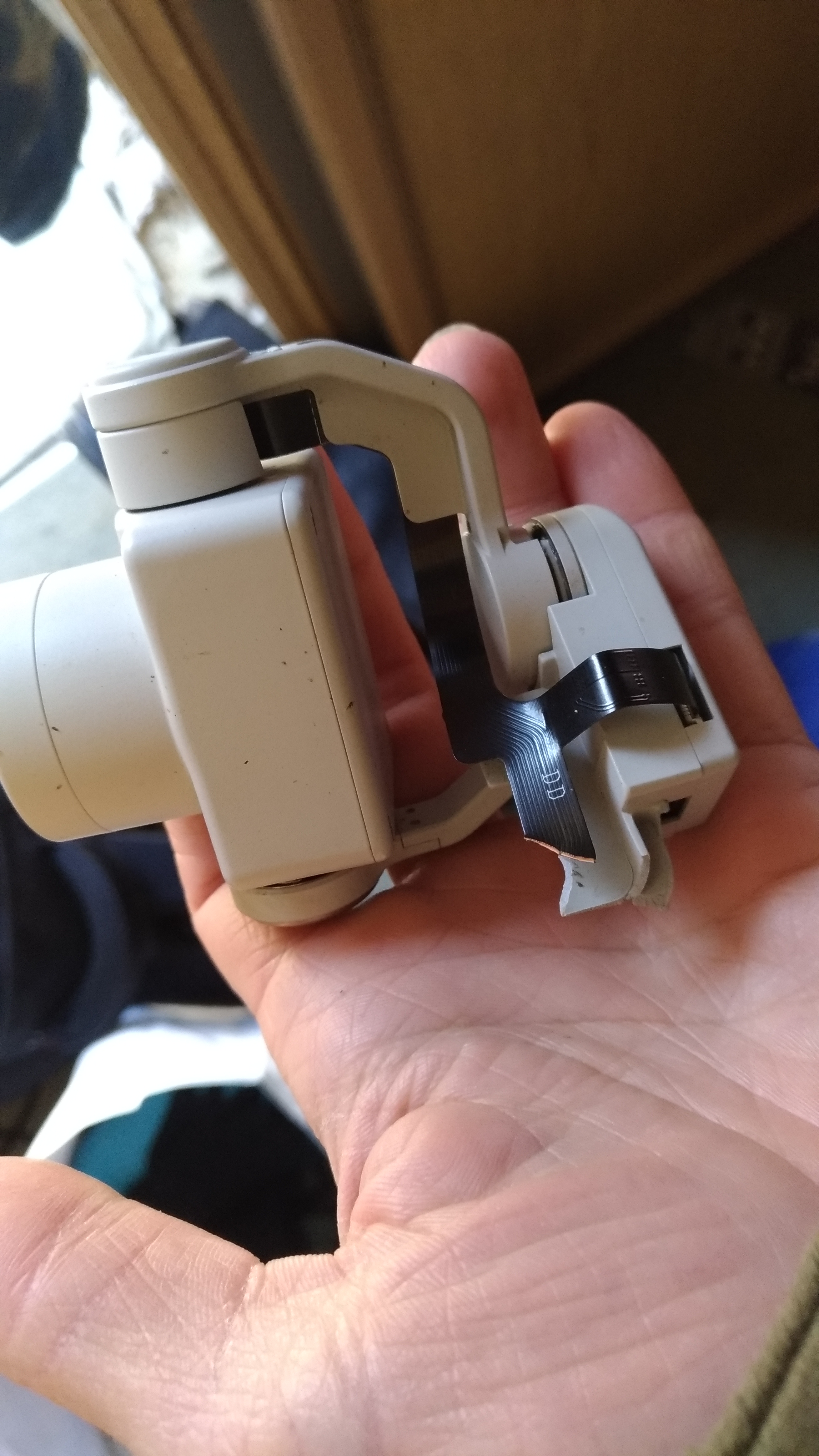

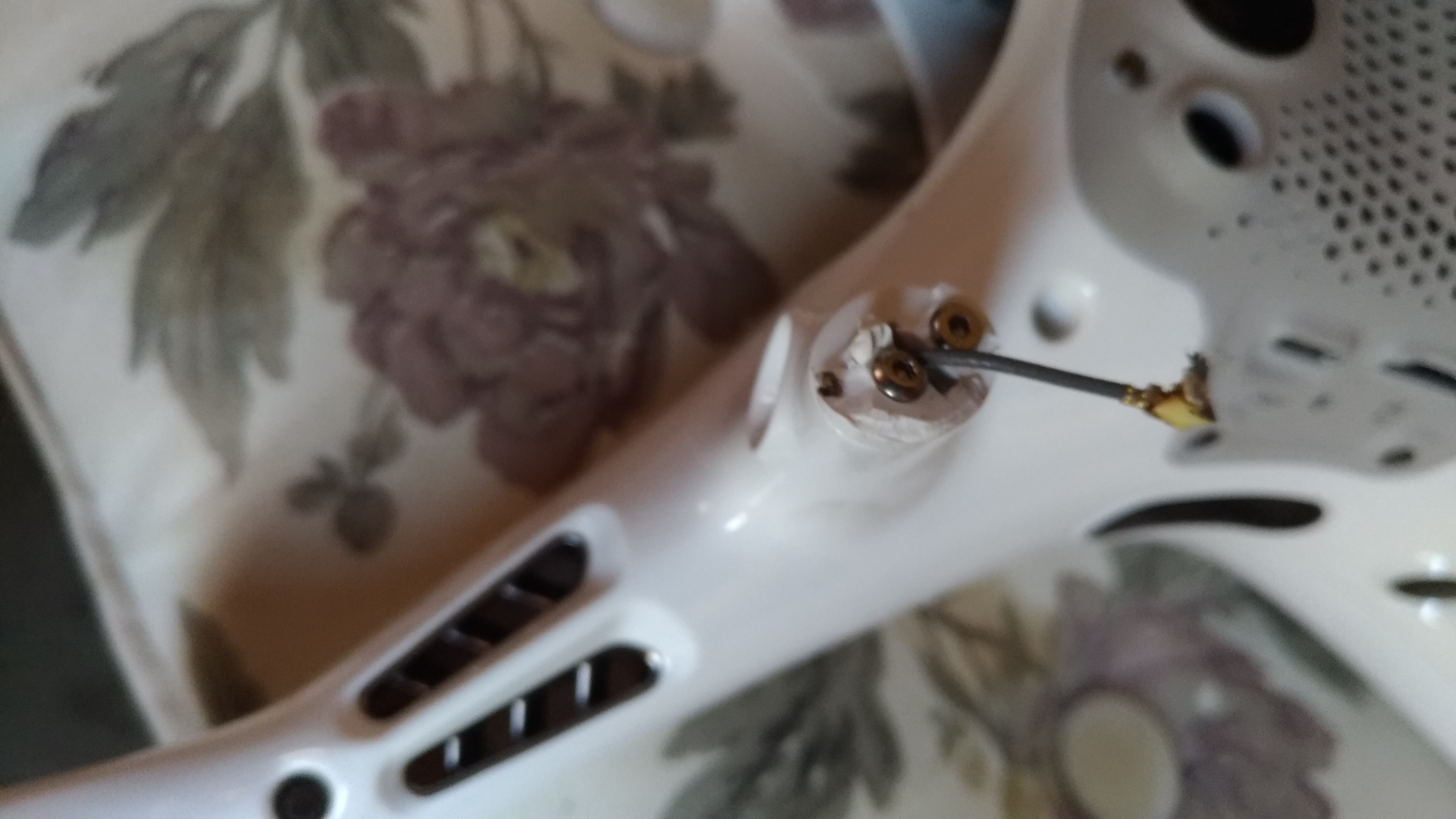

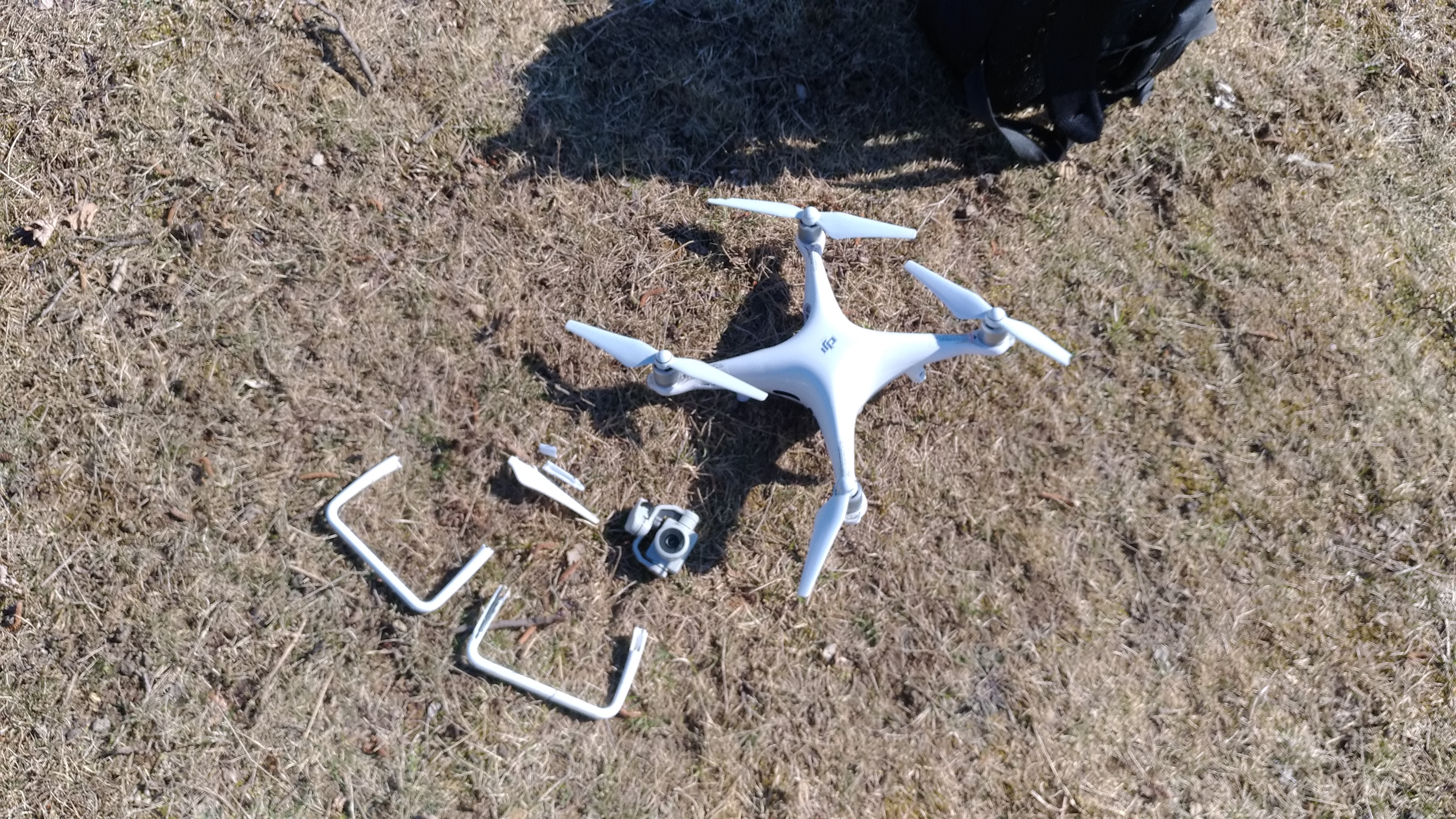

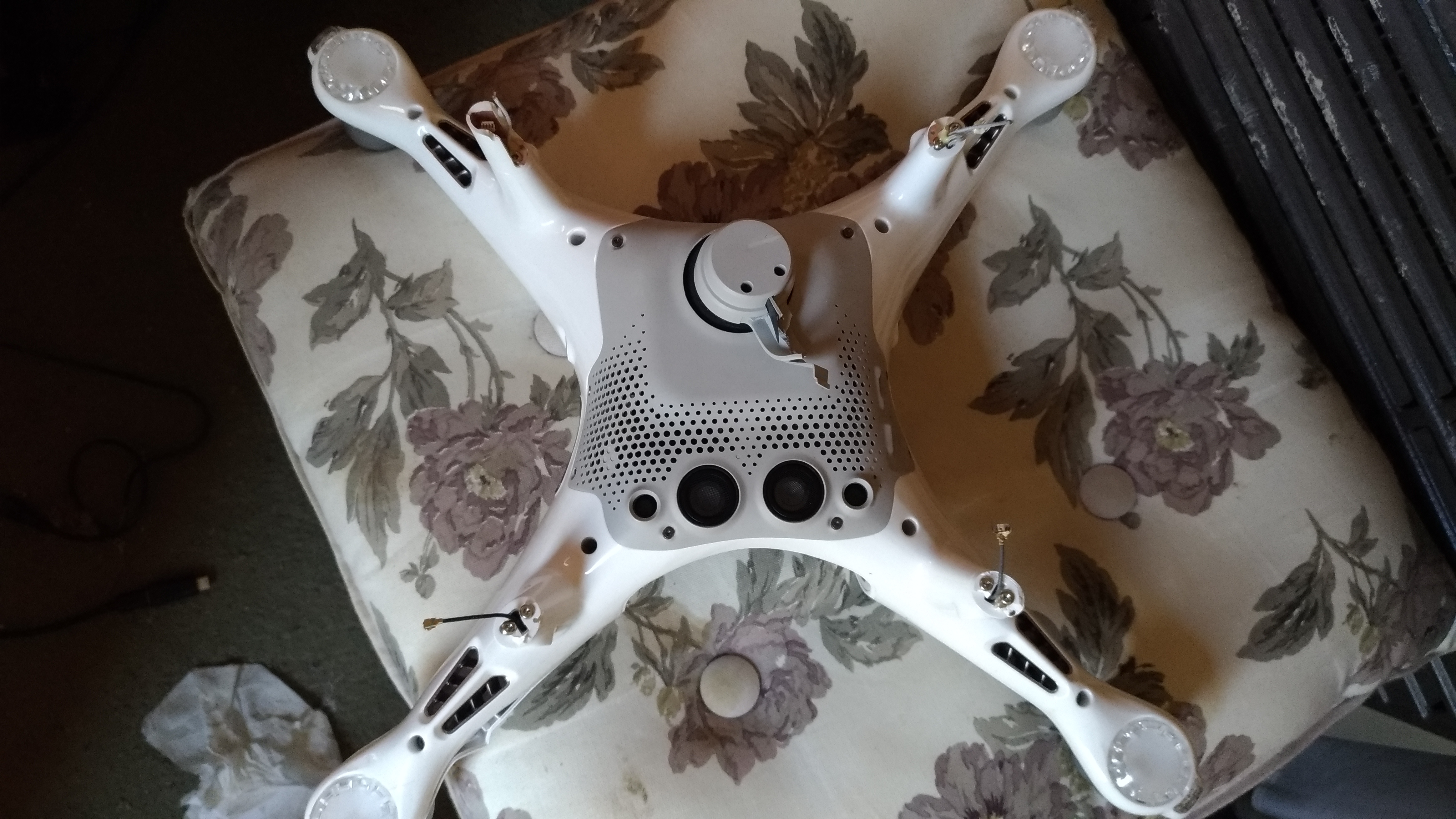

Hi, I am writing here hoping that someone who has experience repairing phantom drones could give me an advice:
I had crashed a phantom 4 pro drone and it is quite damaged:
- one of the drone arm bent so at least the upper shell should be replaced
- both skid landing suports are broken and dettatched from the drone so new replacement for the landing suport is necesary
- camera rippen of and dettatched from the drone so yaw arm replacement and wire replacement necesary
- one of the proppeller motors is stuck (cannot be freely spin by hand more than 1 or 2 degree angle) so new motor for replacemet needed
In order to save the situation, I found on sale another damaged drone this time a phantom 4 pro V2 drone wich has no camera (was rippen of during the impact with a building and coudn`t be found). This drone has the landing suports in good shape, the shell is not bent, and look as a good one to put the camera from my phantom 4 pro drone and to have a good functioning drone.
The only concern with the phantom 4 pro V2 drone is that at start it shows ESC error instead GPS signal ok
Also, when you try to start it, only 2 of the 4 motors spin and on the display shows the error: " Takeoff error. Check the motors and propellers"
You can see a videoclip with tis phantom 4 pro V 2 here:
Can I take parts from my phantom 4 pro and replace on phantom 4 pro V2 to make a good fliyng drone ? I mean propeller motors, the camera. Are these spares compatible between these 2 drones ? (I know that the remote controls are not interchangable, but this is not an isue as the seller stil has the remote controll)
I attached photos with my phantom 4 pro damaged drone
Thank you in advance for your answers.

There are parts of these two ac that are interchangeable. Based on your descriptions, repair may not be worth your time. The V2, if it truly is a V2, sounds like a good candidate for a wall hanger. Based on your pictures, even your P4P would be questionable for repair. The damaged pieces can be replaced, but still a lot of hardware inside that may be damaged also. Hope you get it solved!

If I had the p4p v2 in front of me I would open it up and check the thin ribbon cables on the side where the 2 motors show esc errors. 2 and 4 or 1 and 3. You can buy a cable kit for very little money. If they are ok check the leads to the motors. That is a very nice drone. well worth repairing if it is just motors or the cables. I have seen a lot of ripped ribbon cables after a crash. I assume it also needs a shell. If you try to replace it yourself, DO NOT Cut and splice the motor leads. You have to un solder them from the esc boards. You will need a good soldering station and not a cheap soldering gun. If you like I can advise you as you work on it. I am just sitting here with nothing else to do.
