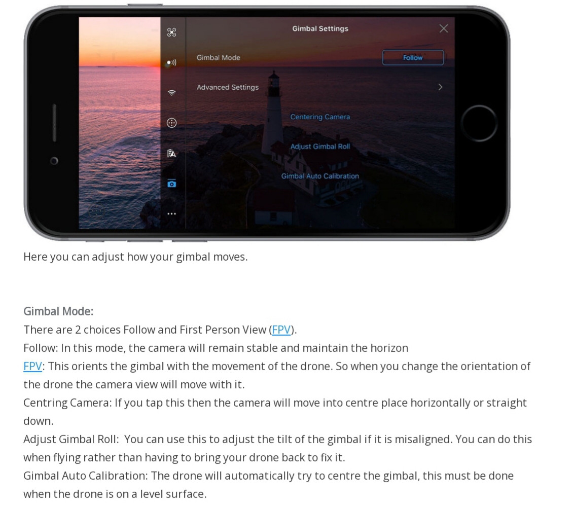

Tryed playing with gimble roll or calibrating

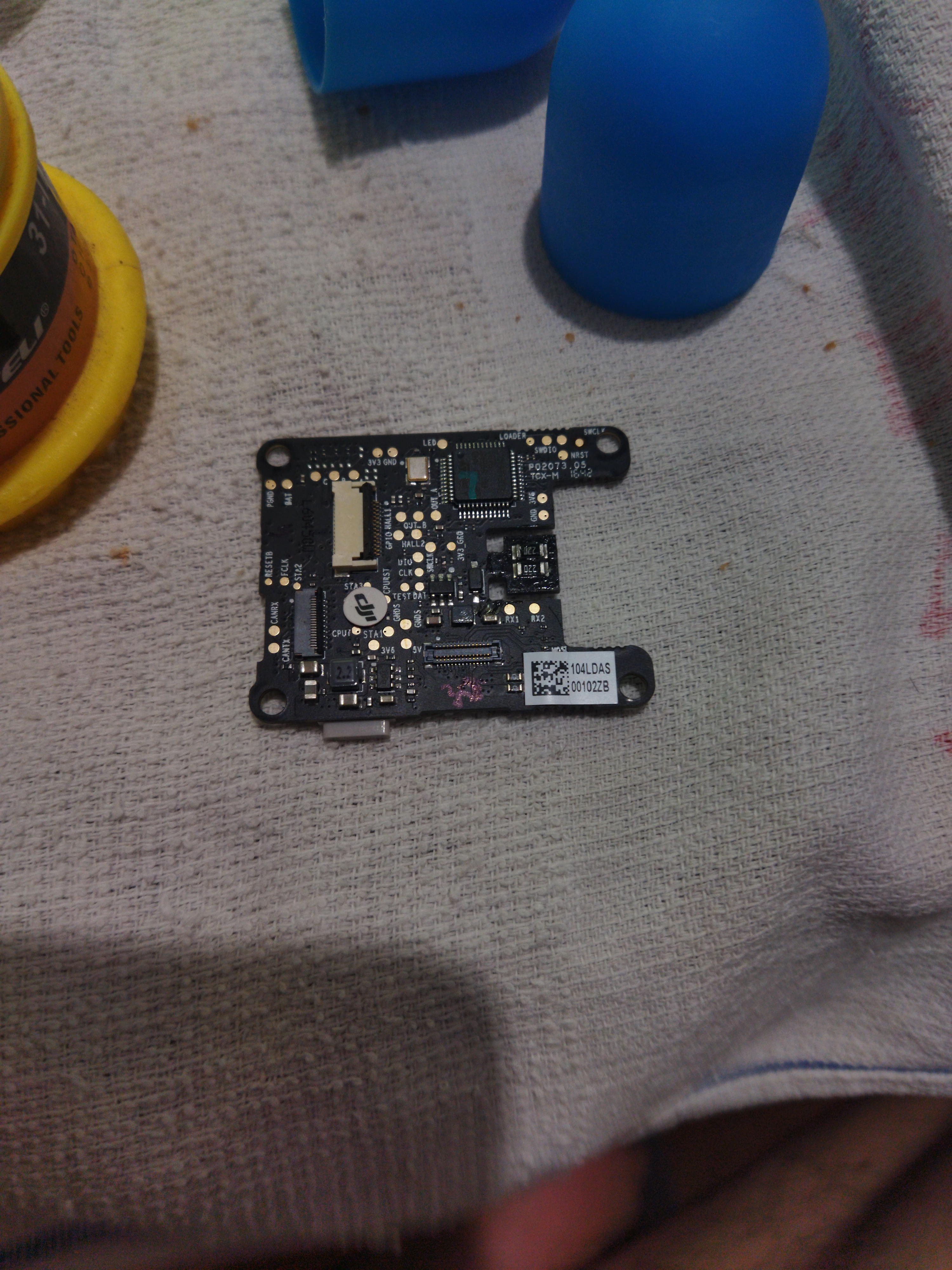

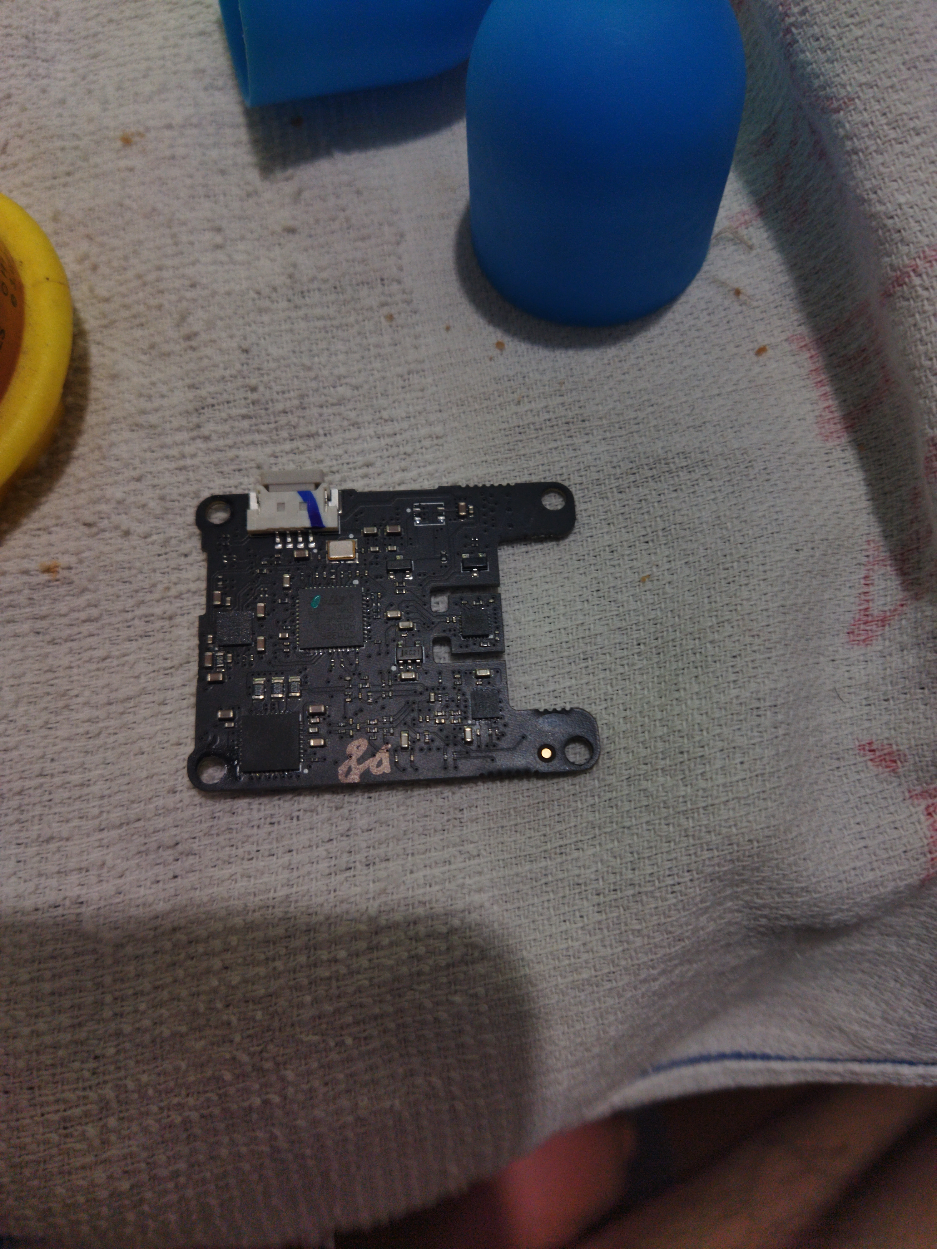

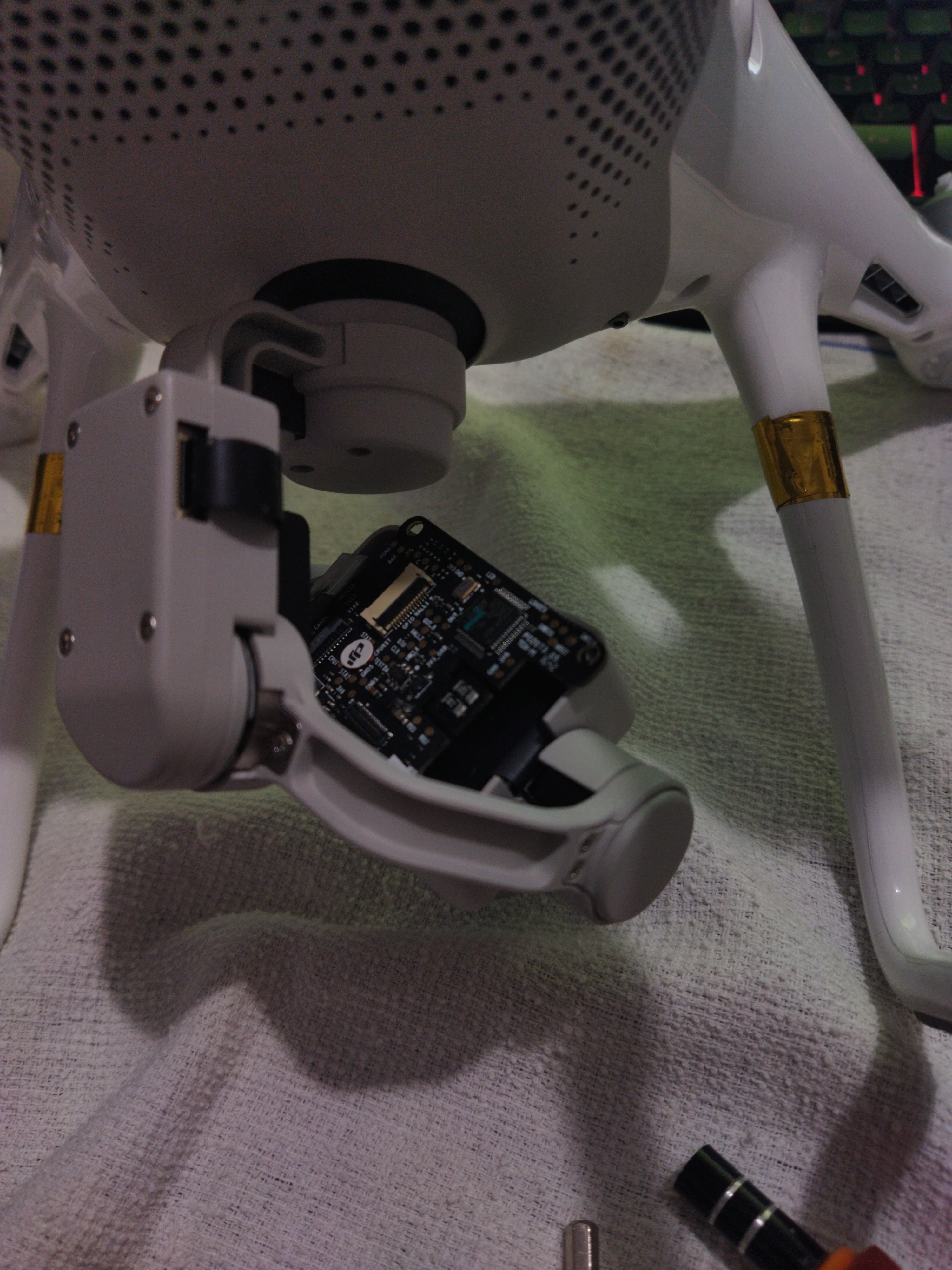

I have already replaced the Gimbal motor ESC board, but it's still the same. I am planning to replace the Gimbal camera IMU board located at the back of the camera case.Please help

I have tried multiple IMU and gimbal calibrations.

Sounds like the camera IMU board
