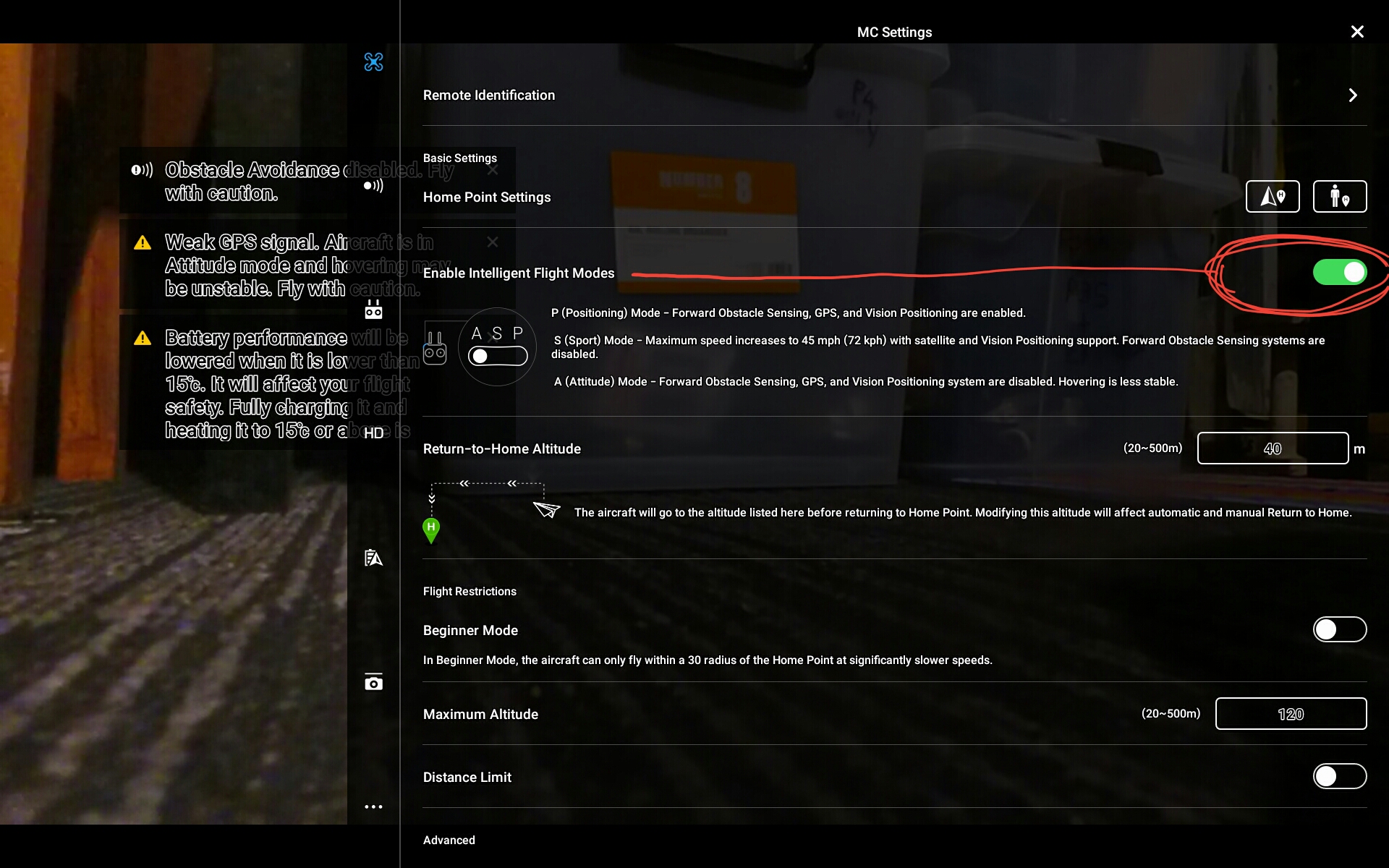

Yeh that's a very odd one,I had a Limp one once but not like that,if gimble calibration or imu calibration not fix it and it's new,I would exchange it,,,,,on the inteligent flight modes is yours turned on,,probly dumb question,but just ask

Yeh that's a very odd one,I had a Limp one once but not like that,if gimble calibration or imu calibration not fix it and it's new,I would exchange it,,,,,on the inteligent flight modes is yours turned on,,probly dumb question,but just askView attachment 101211i
I think the warranty was expired already since few months ago....
And yes, inteligent flight mode was enabled. I always set it on every drone i purchased.
