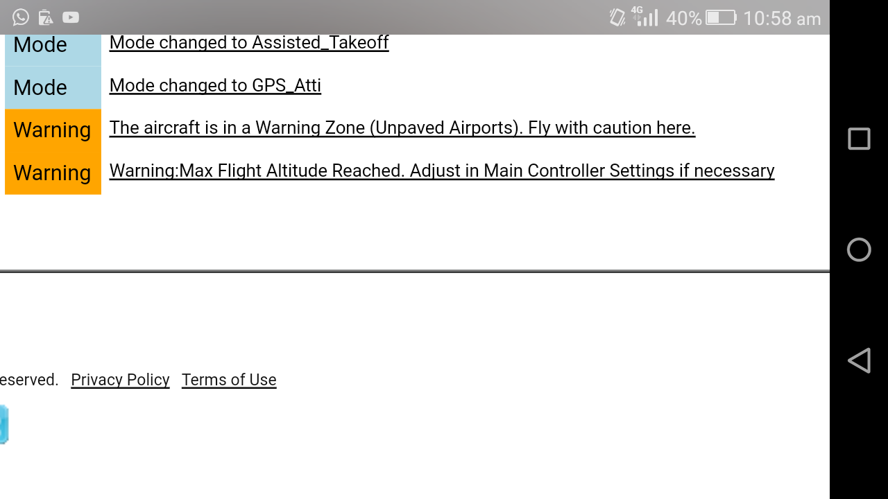

Those new "unpaved" airport messages have been making me think they are or close to the root of the "problem."
I get that message all the time. Seeing as how there is much farm activity around here there are crop dusting "air strips" all over the place. It's never been a problem before.
Yea the unpaved airport has no impact on anything. I live near one too.
I did fail to mention one thing.
Those messages seem to bug out my system, ONLY when homepoint/take-off in class G, then fly into a "warning zone" when taking videos/pictures toggling back and forth.
Something happens during data capture. If I am simply flying/viewing only, no crash (black screen) of the app.
Mostly this happens with my P3S. Maybe something lags too much over WiFi and the app just goes to bed.
