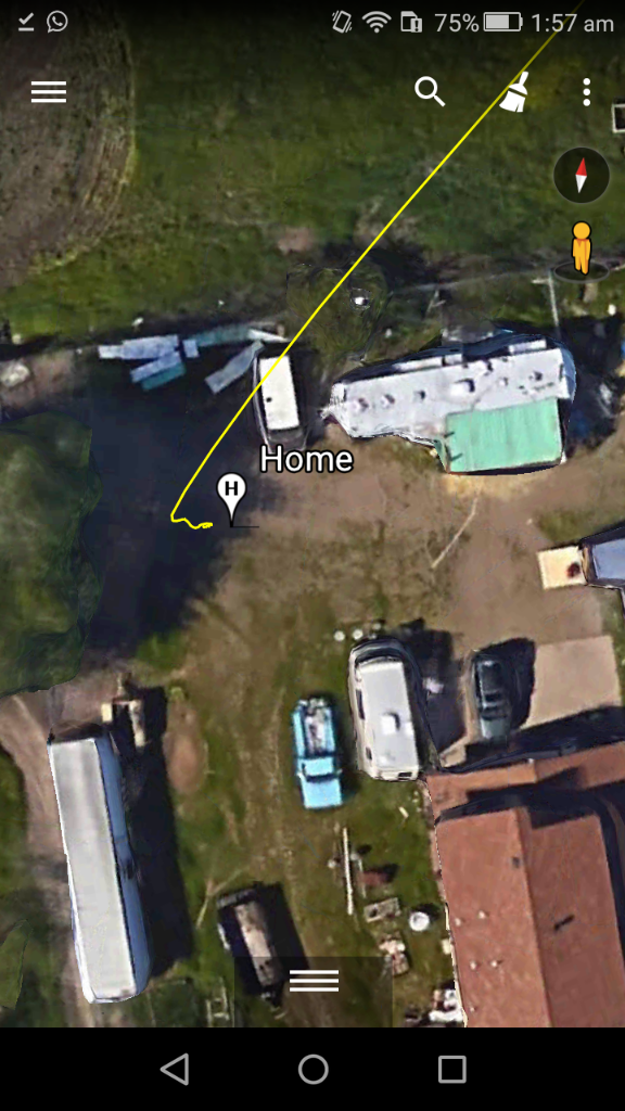

From the screen shot with the H on it, it appears it may be he following. When you hit return to Home it gives you two options. New home or original home. Looks like you may have accidentally assigned a new home.
