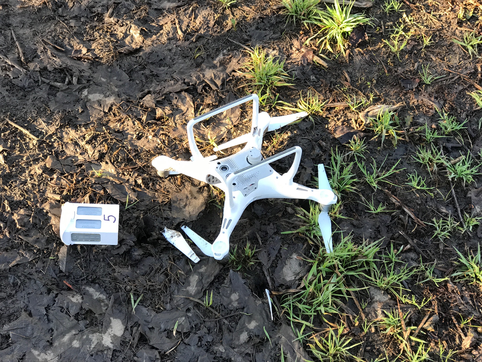

I would contact DJI on this. I would not fly this craft again before doing so. There is literally nothing in the logs indicative of an issue other than instant power loss or some other catastrophic failure. This also concerns me in the logs, not totally sure what they mean.
213.279 : 1182790043 : 12850 [L-FDI][FDI][NS(0)][GPS(0)]: fault on , stuck
213.679 : 1184589442 : 12870 [L-FDI][FDI][NS(0)][GPS(0)]: fault off, stuck
269.279 : 1434789972 : 15650 [L-FDI][FDI][NS(0)][GPS(0)]: fault on , stuck
269.479 : 1435689557 : 15660 [L-FDI][FDI][NS(0)][GPS(0)]: fault off, stuck
292.479 : 1539189732 : 16810 [L-FDI][FDI][NS(0)][GPS(0)]: fault on , stuck
293.279 : 1542789769 : 16850 [L-FDI][FDI][NS(0)][GPS(0)]: fault off, stuck
The aircraft is being sent back to DJI tomorrow. This just verifies what I've thought all along. An instant power loss was the cause of the crash.

So I was a bit over six minutes into my second flight of the afternoon. I had my P4 hovering over a spot where I could get a shot of a passing train. Suddenly my screen goes blank and "Aircraft Disconnected" message appears on my iPad! What the heck????? I immediately hit the RTH button but to no avail. I went searching for it but it was getting dark and the last contact I had with it was over a private orchard so I'll go searching again in the morning with permission of the land owner for certain.
Talk about a sinking sick feeling!!! If I am able to find it I'm dreading the condition it'll be in and if not found I'm really dreading replacing it. Ugh!!
Has anyone else had the experience of the P4 just disconnecting in mid flight? If so any ideas of what may cause it? By the way, before the flight I am certain that the battery was properly mounted in the aircraft.
