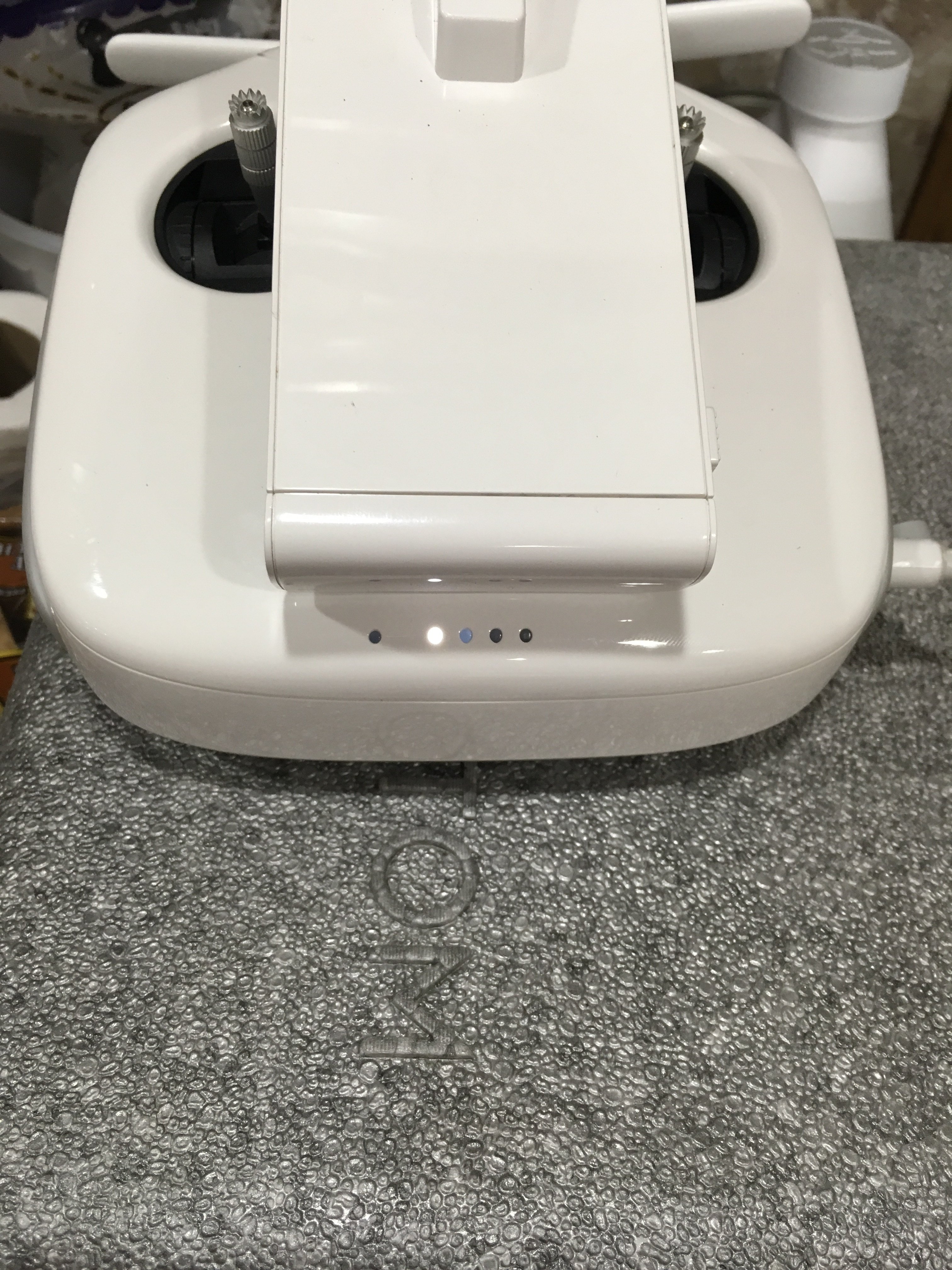

So my charger finally went to low voltage and started beeping the normal red flashing light with the alarm... it's now has been charging for over an hr and still has only 1 of the 4 white led flashing....it seem to be stuck and can't get anymore of the white led to flash...just 1 :(
I think I'm screwed
So as I took this picture all the lights went out...so I unplugged and plugged back in....now I have 2 of the 4 flashing....but after a min the power goes out and you have to unplug and plug back in????
What the hell
Olroy, Did this start suddenly out off the blue, or right after a firmware update?
It's been doing it as far as not letting the 4th led to light up. I thought it was a random deal until I looked on here and to find out it's not... I did leave it plugged in with the lights that go out after about 30sec when your charging...surprisingly its charging back up even when the lights not flashing...although it doesn't look like it will get passed that 3rd led light.
