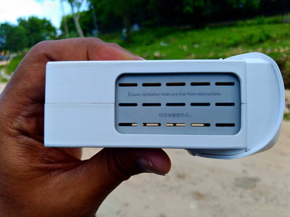

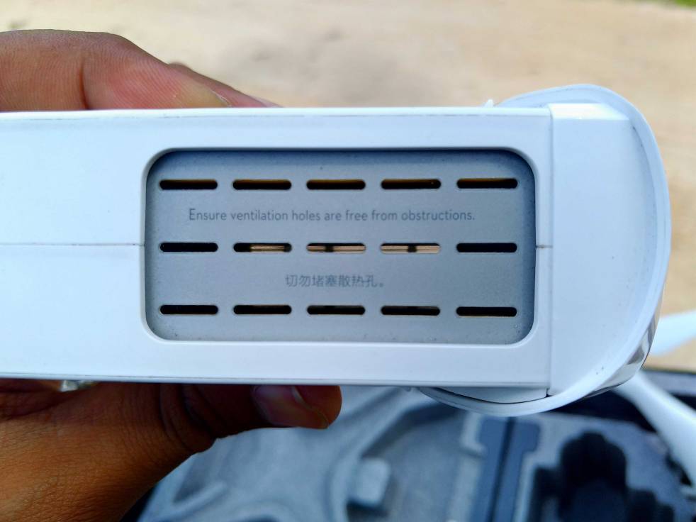

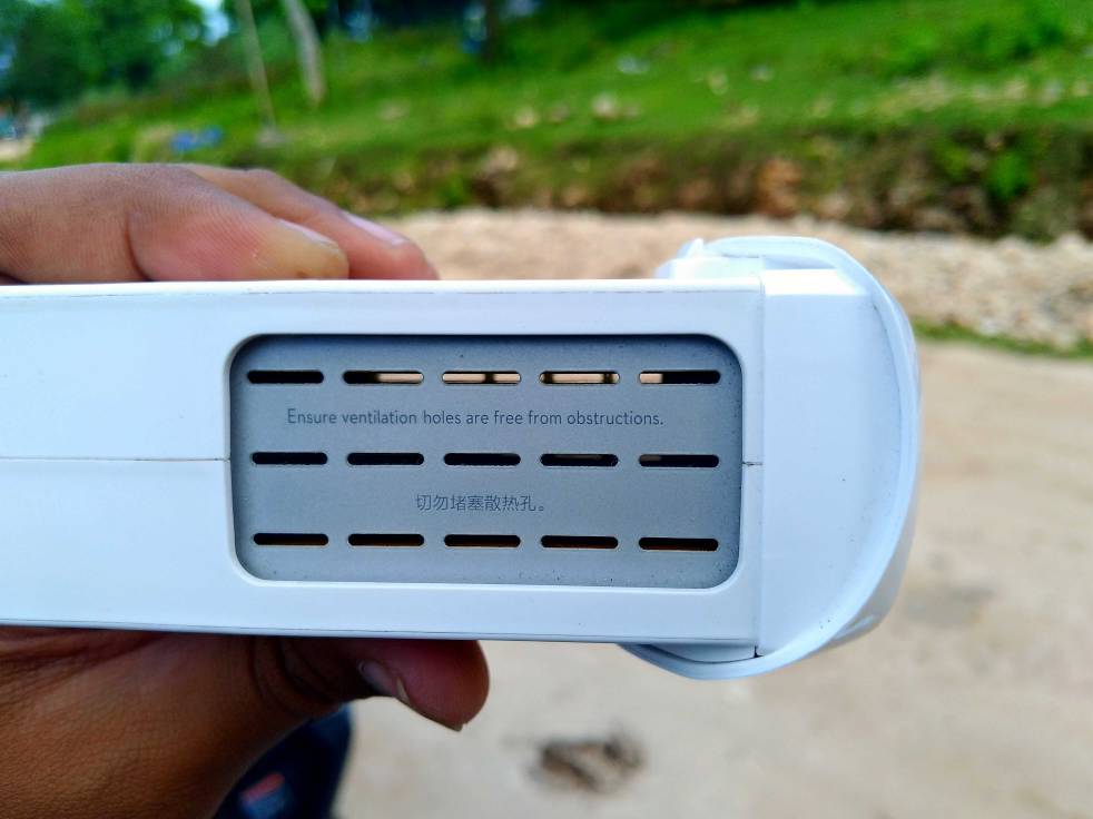

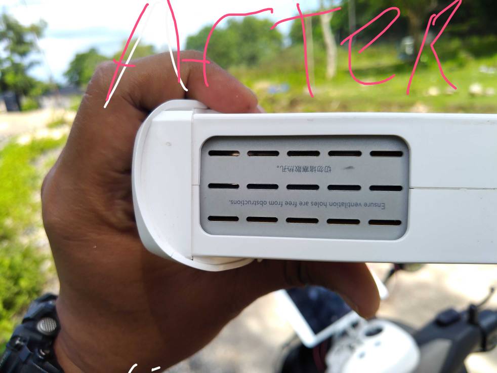

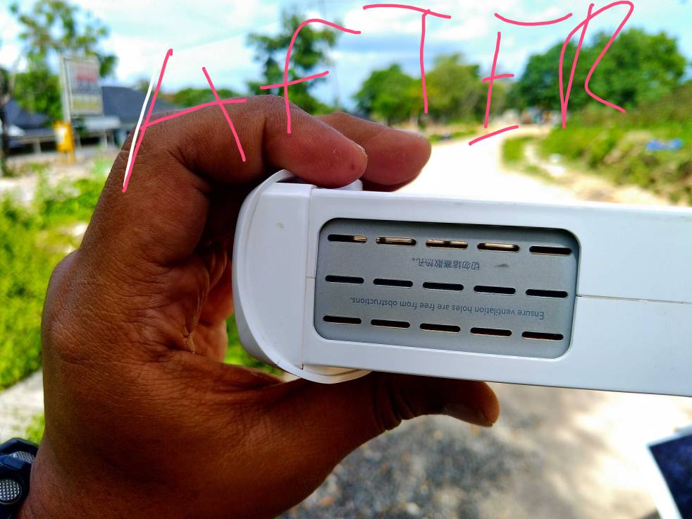

Hi sorry i just have time fly today.
I attach photo before fly , and after fly batt on 35% hot condition
So when cold all 3 air vent hole all can see though. But when after fly on hot condition. The vent gone..
View attachment 108383View attachment 108384View attachment 108385View attachment 108386View attachment 108387
Especialy the middle vent. For battery case no change .. normal. And after cold all back to normal. I will attach tiday fly battery report from airdata
