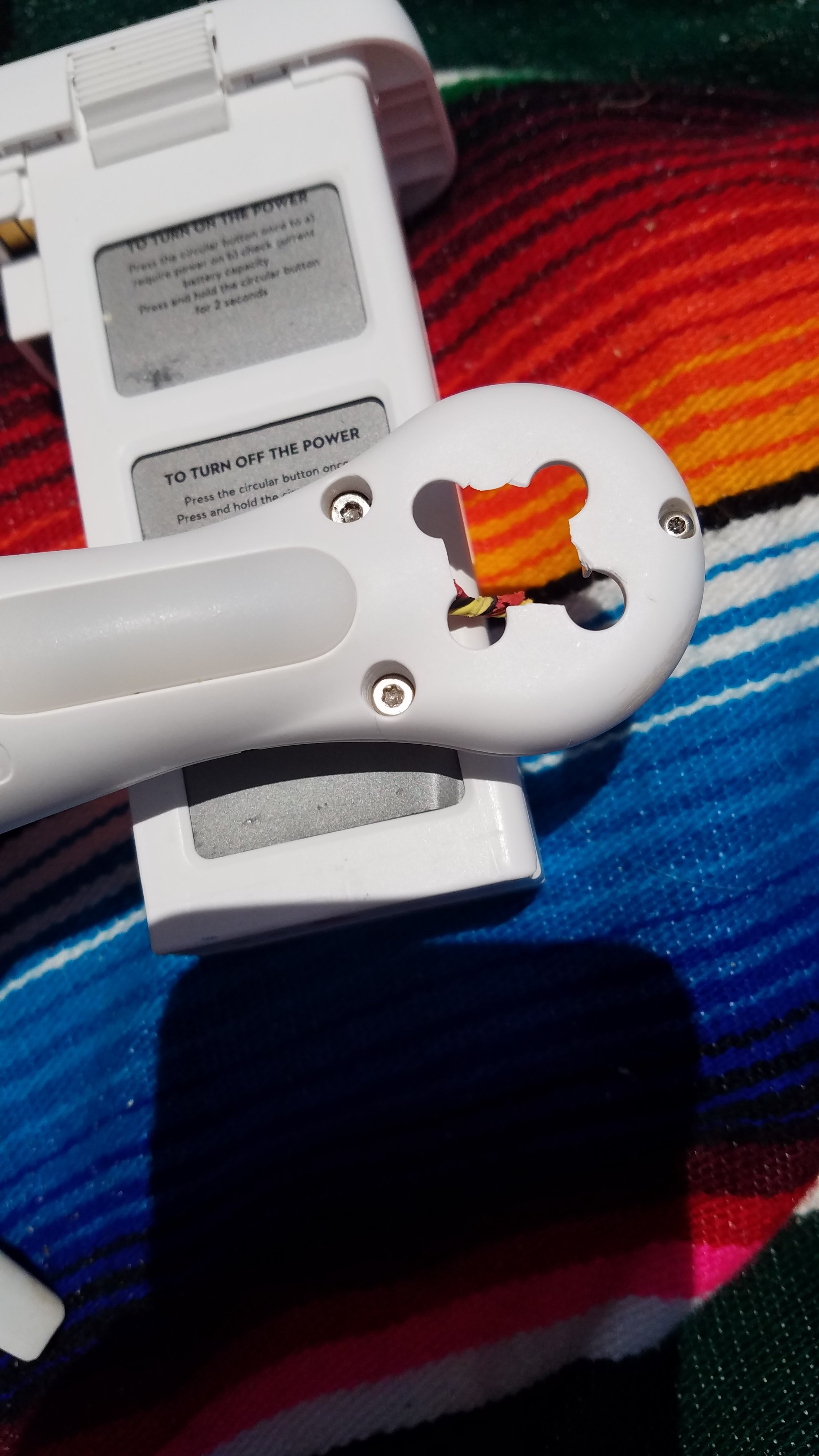

I been flying my phantom 3 pro since November of last year, 35 hours total tiime, 210 flights and over 400 km total distance, with not one issue..ever ..no crashes no close calls, nothing.
This morning I went out to the beach with my wife and kids. Went up, out to the ocean to do a video of a sailboat just cruising, on the way back got really close to the water, right on top of the kids with the camera looking down, went straight up and at about 150 feet, I stopped recording and gained more altitude, to about 300 feet i started to decend, i was looking at the screen since the drone was over my head, all of the sudden the view was rotating very fast and going from sky to ocean, immediately I went to att to regain control, got a couple of error messages and shortly after the drone came down in to the beach really hard, one of the engines was missing, we looked for it and founded about 60 yards from were the phantom 3pro hit the sand, total lose. It was definitly a separation of one of the motors from the phantom, thank god nobody was hurt but this is very very scary to have something like this happen, This morning I did a very meticulous check of the phantom, look for craks, loose bolts, etc all seem to be ok and this happens. I'm contacting DJI service to file a warranty claim for a catastrophic structure faliure.
I need advice on how to contact DJI about this, thanks

The removable blade guards you can purchase have a plastic reinforcement piece that would have probably prevented this because they act as a large washer reinforcing that area. I checked my motor mounting screws and some of them were slightly loose. I guess this is another preflight checkpoint you should do.

have you had the shell apart ? it looks like a crack near the lower screw ?
but maybe caused by the crash ??
looking at the top back screw looks a tad worn but what makes me look at this image is, look at the end of the prop are, the small screw at the end that just nips the tips together, on a mk1 p3p that should be a smaller philipsi screw and not that one i see? also spiral scuffing in the bottom left screw
so looks to me as if the shell has been opened.. dont get me wrong dji should still replace but this is 50/50 but a Pre Flight check would have seen the crash coming

Very good observation Chris, I just looked at the photos again and there's no doubt those screws were tampered with at some point, one in particular appears to be nearly stripped. I'm not convinced DJI is going to honor this claim, even the screws in the arm that hold the frame together show clear signs of scratches indicating they were possibly removed and replaced. Airnuts is likely better off not presenting the piece that broke off to DJI.

looking at the top back screw looks a tad worn but what makes me look at this image is, look at the end of the prop are, the small screw at the end that just nips the tips together, on a mk1 p3p thatshould be a smaller philipsi screw and not that one i see? alsospiral scuffing in the bottom left screw
WRONG !!! Shell is never been open, As I stated before I had cero issues with my phantom prior to this incident, I am a very experienced R/C pilot on both airplanes and helicoptes, and I did a very extensive preflight check that day, looking for loose screws and of course, HAIRLINE CRACKS, none found, this is a very simple case of poor desing, nothin else. PERIOD
