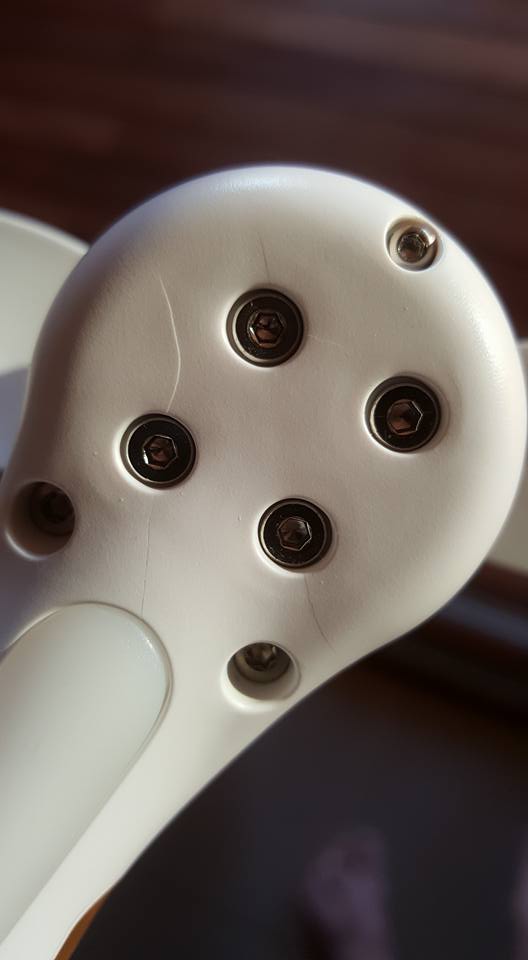

One week old, No crashes, no rough handling and clearly Not a Mark on it except for the stress fractures!
I got this a Week ago today and have flown for about 2 hours. I Only found this today thanks to this thread.
To me it simply looks like the screws have been over tightened from factory but I can not say whether these fractures where there or not the night I opened the box.

First I want to say sorry for your loss. I found one cracked motor mount on my P3P after 100 flights with no falls from air crashes. However I did once break a propeller when my P3P tipped over during a landing from a gust of wind after about 50th flight and there appeared to be no exterior damage to the aircraft then. I was lucky that I found the internal hair line cracked motor mount when I opened the aircraft months later and found that the motor that incurred the broken propeller previously had caused cracks invisible to exterior. So word of caution to anyone who has ever broken a propeller while motor spinning. This can cause internal cracked motor mount not necessarily visible from exterior.
Are you referring to the internal view of a plastic motor mount or the threaded metal flange of a motor?
Did you try UAV Bits reinforcement plates to [hopefully] stop further cracking and eliminate the possibility of a subsequent motor detachment?
I am referring to the the plastic motor mount and surrounding areas only. And yes I have since reinforced all 4 motor mounts with Plast-aid and UAV Bits reinforcement plates.

looking at the top back screw looks a tad worn but what makes me look at this image is, look at the end of the prop are, the small screw at the end that just nips the tips together, on a mk1 p3p that should be a smaller philipsi screw and not that one i see? also spiral scuffing in the bottom left screw
so looks to me as if the shell has been opened.. dont get me wrong dji should still replace but this is 50/50 but a Pre Flight check would have seen the crash coming

When I saw this thread it made check the bottom of my Week old P3Pro only to find that there were cracks underneath one of the motors. I contacted DJI immediately and sent them pictures and invoices etc etc etc.
They were really good in that they said they would replace the Drone completely and it would be on the way shortly.
About two weeks later I received my new drone via courier, only to open it up and find that the Engines had severely damaged threads, one of them being that bad that I could not screw on the Prop without stripping the guts of it out. So I took a bunch a pictures again and emailed my friendly contact and went through the same process.
3 or so weeks pass and I get another Brand new Drone delivered to me ( My 3rd One ) Via Courier Less the Battery and Less the remote as I kept them from last return, Only to find that this MoFkng Drone has got a great big Crack underneath the motor Just like the First one, Only much bigger.
