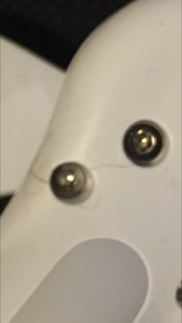

new style shell with a crack, never crashed and always checked for cracks after each flight. Once this one showed up, I did the plast-aid fill of the arms. The arms are rock solid now with zero flex.
Would you please post some close up photos of your best plastic fill job. It would give me a head start on your fill process. I have a P3P with 129 miles of flight and 26 hours of air time. No cracks yet. Thanks.
