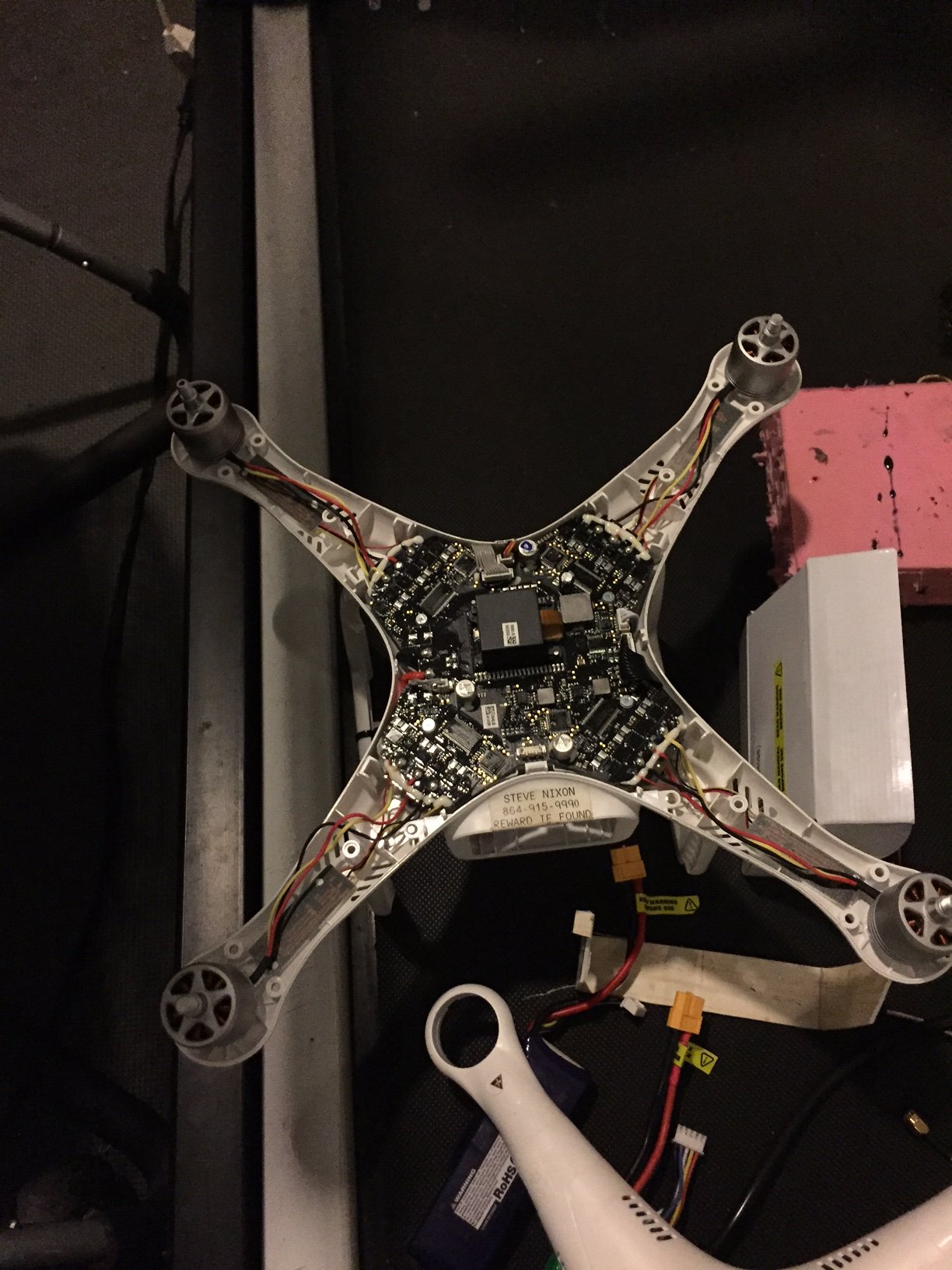

Phantom 3pro lost motor mid flight.....total loss

FWIW, I notice your shell is the old-style shell without the X braces. I'm not suggesting any conclusion from that, but just an interesting data point.
The breakage pattern is as if the force of the motor just pulled it out of the shell. Perhaps the shell was weakened or brittle for some reason. What were the winds like? Maybe a wind gust put some excessive stress on the motor mounting. Not sure the newer X braces would have strengthened the shell enough to withstand whatever happened, but worth pointing out to DJI that you have the old-style shell.

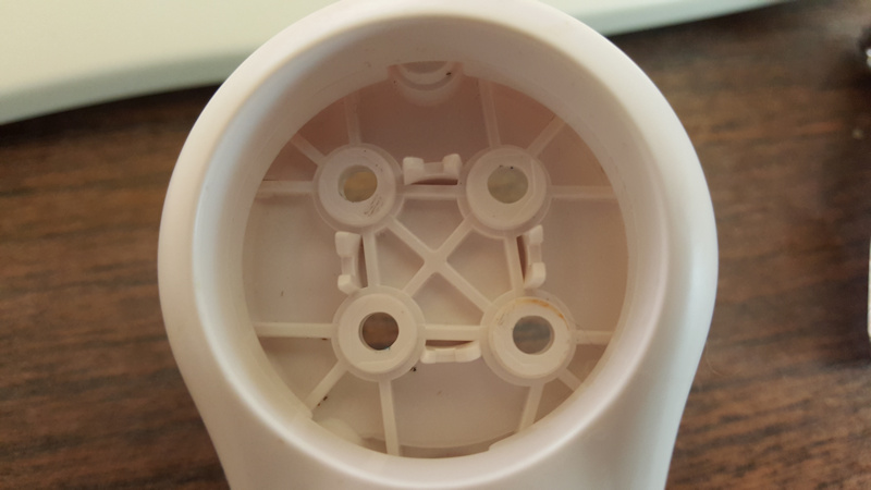

The new version shells look like this under the motors (there seem to be at least one or two intermediate versions out there as well with other X brace patterns). As I'm reassembling mine, I'm also going to fill around the braces with Plast-aid. And perhaps install the external reinforcements as well (every time I convince myself doing both is overkill I see something like this).
+1. The shell you have has the notches in each the tabs that look like devils ears. This is the shell that everyone should update to.
I requested lower a shell to be sent from DJI and they supplied me one like yours but without the X brace in the middle.

this is know problem with the shells cracking. This is why I went ahead and reinforced all my arms with plast-aid.
removed shell , motors and filled with plast-aid.

I did the same. Just don't ever want to worry about cracks. But now this! Wow, glad no one got hurt and that the drone and motor ended up where they could be found. It would be tough getting DJI to believe that the motor separated, without having the pieces.
Just speculating that maybe a prop went bad or was way out of balance and the vibration from that is what helped crack the plastic and dislodge the motor. I say this because the crack surrounds the bolt pattern exactly...

I been flying my phantom 3 pro since November of last year, 35 hours total tiime, 210 flights and over 400 km total distance, with not one issue..ever ..no crashes no close calls, nothing.
This morning I went out to the beach with my wife and kids. Went up, out to the ocean to do a video of a sailboat just cruising, on the way back got really close to the water, right on top of the kids with the camera looking down, went straight up and at about 150 feet, I stopped recording and gained more altitude, to about 300 feet i started to decend, i was looking at the screen since the drone was over my head, all of the sudden the view was rotating very fast and going from sky to ocean, immediately I went to att to regain control, got a couple of error messages and shortly after the drone came down in to the beach really hard, one of the engines was missing, we looked for it and founded about 60 yards from were the phantom 3pro hit the sand, total lose. It was definitly a separation of one of the motors from the phantom, thank god nobody was hurt but this is very very scary to have something like this happen, This morning I did a very meticulous check of the phantom, look for craks, loose bolts, etc all seem to be ok and this happens. I'm contacting DJI service to file a warranty claim for a catastrophic structure faliure.

Did you ever use Loctite to secure the screws to the motors? This product has been know to cause deterioration to the plastic therefore, not recommended. Not sure if it's the blue or red that is not recommended for use with plastic.
Thats an interesting potential issue. I see what you mean. Downward pressure from a case pressing on the motor shaft or propellers while the motor is still hot could make the plastic in the area underneath more brittle as it heats and cools time after time. Had never even considered that. Glad I have my arm reinforcements! They will serve as a heatsink as well and dissipate heat that is headed down to that area.
After seeing the nice big clear images posted I feel pretty confident the plastic becoming heat soaked plays a large role in this. The breaking points were also the weakest points if it were due to heat. The areas that let go were from pure torque as if the A/C was heavy and having to be full throttle as it climbed upward.
