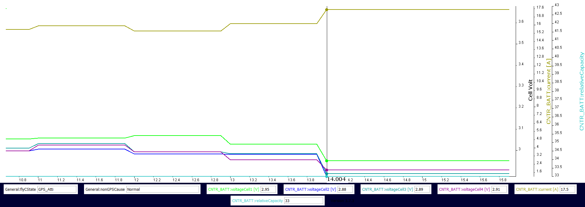

Simply for the sake of stating the obvious, ~3V is the battery cell shutdown point. If you note in the graph below at ~13.9 seconds, Cell#1 was the last remaining cell above 3V. Once that cell dropped below the shutoff point the battery completely shutdown ~2 seconds later. That is the cause of the incident. This is why you should never takeoff on a less than fully charged battery. Not only the charge itself, but the process rebalances the cells.

I believe that's the behavior if you have balanced cells. In my case (Hi! I'm OP with the unintentional submarine!) my cells weren't balanced, and I took off at ~30%, so the inbuilt intelligence to prevent this event didn't have a change to kick in before the remaining cell above 3v dropped below 3v.
And I think 3v is required to keep the blades spinning. Not an intelligence shut off, but a "lack of energy makes circuitboards go dark" kind of thing. To put it in MMA terms, the drone didn't submit, it was KO'd.
Your cells were probably balanced - (you can see that there was very little displayed voltage deviation between cells during the flight), but the lack of recent charge to 100% and the incorrect displayed overall percentage of charge gave you an 'inappropriate feeling of drone battery well-being', if I can put it that way... :)
If a lipo battery goes much below 3v on one or more cells, then it's most likely (but not always) a write-off thereafter. I've recovered some 'normal' lipos that have suffered that way, but I've lost a few as well... Below 3v there is not much useful and usable power left.
