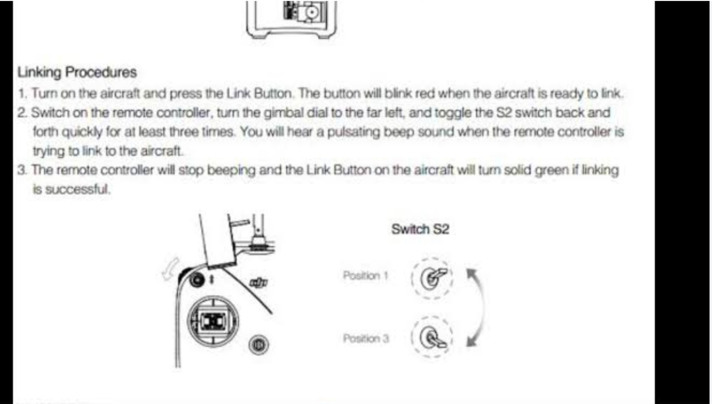

--> manual link: gimbal to the far left, s2 stick up and down several times

There's a manual linking aswell for the p3s ,that's if app times out while trying to link,and that if link button is working so have good look at that
Manual link method
Manual link method

Ok well flashing is good ,its working,yeh they do break,did you try manual link method,and yes it still link if compass ,GPS,motors not plugged up,you'll just have onscreen errors but AC will communicate to RC ,those parts mentioned wont stop linking,since you logged off I mus well too

Thanks. My phone is not compatible with the app so I only use manual linking. Honestly, I prefer to see the craft flying and not the reflections on phone screens. Cheers for confirming that the rx and tx should bind with just power. I tried two remotes on both p3s swapping them and trying to link with same result on all combinations. I will try and find a phone that is compatible but hard to get the DJI go app as they've changed everything. Wonder if you have a working Phantom and would test the battery voltage of the little brass tabs of the battery. I am only getting .03v on a new fully charged battery.
