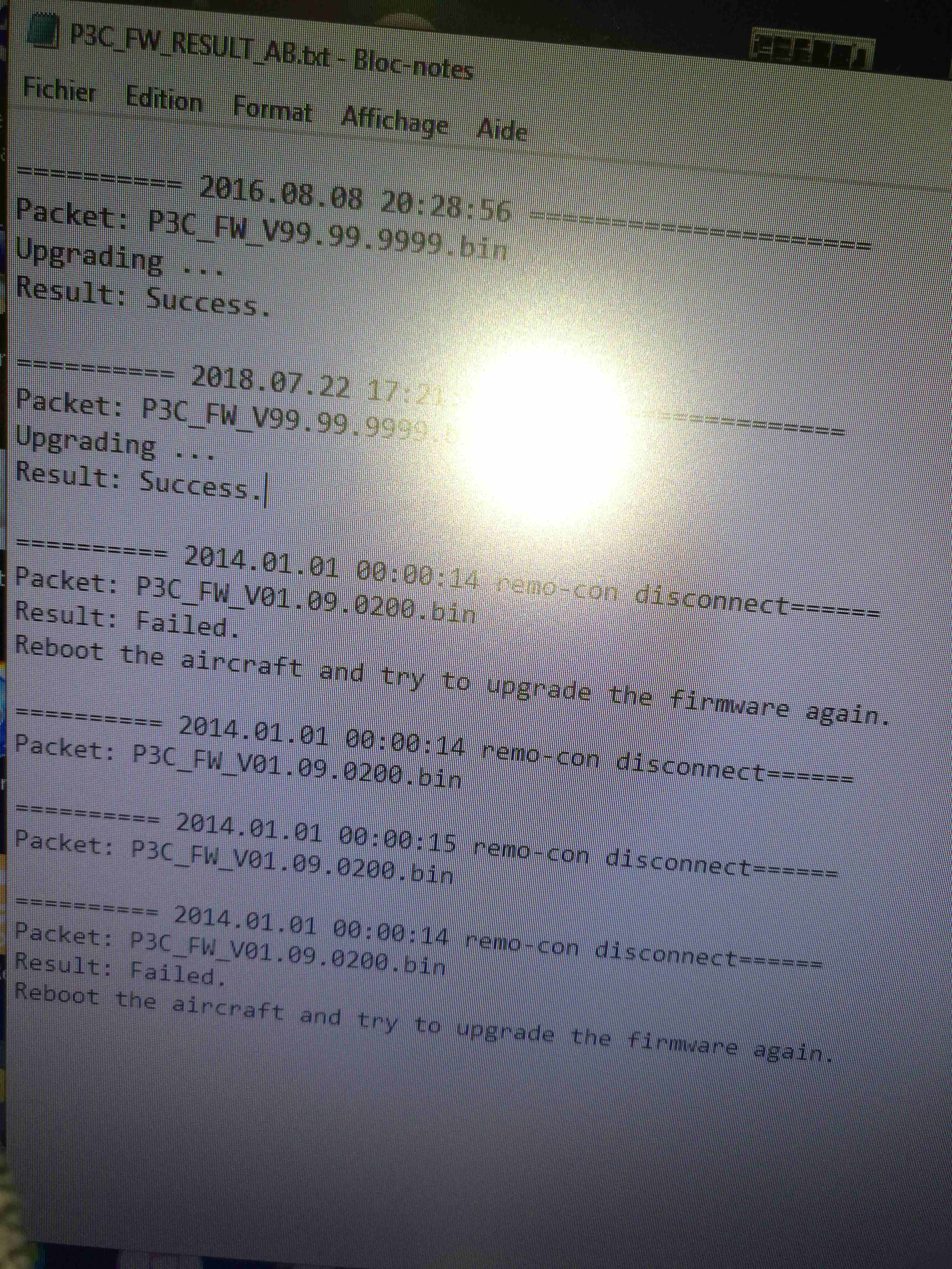

Also, I did try to update the firmware on the aircraft yesterday, this is what it told me from the log on sd card:
112753
The first 2 attempts (2016 & 2018) are not from me.
The version of the firmware is weird --> V99.99.9999 ...
All the next ones (from 2014) are from me yesterday, trying to update with latest version I found: P3C_FW_V01.09.0200.bin
What it tells me: somehow the aircraft thinks it lives in the past. And second: well it failed.
Of course I followed the rights steps:
aircraft and RC switched off
put the firmware on camera's sd (after having formatted it)
push and hold the synch button on aircraft
switch aircraft on
release synch button after 10 seconds or so
--> the lights on the camera blink red and green. After a couple of minutes only the red stays.
On my first attempt I waited 20 minutes, but I think the process is done when either light stays red (failure) or green (success).
Second and third were aborted.
Fourth I only waited until the light became only red.
I haven't tried with another firmware yet.
Any one you would recommend?
Hoping this would give you a hint of what is happening.
Thanks in advance
BR

Also, I did try to update the firmware on the aircraft yesterday, this is what it told me from the log on sd card:View attachment 112753
switch aircraft on
Thanks in advance
BR
The V99.99.9999 is the transfer file versions number of the 1.09.0200 to upgrade the firmware on the copter and remote as the battery. This number tells the system that ´s all in one file.

I tried several firmwares for the drone, and each time I get the message that it fails.

When I try changing the firmware it fails but the log is written --> that means that the motherboard successfully pairs to the camera, right?

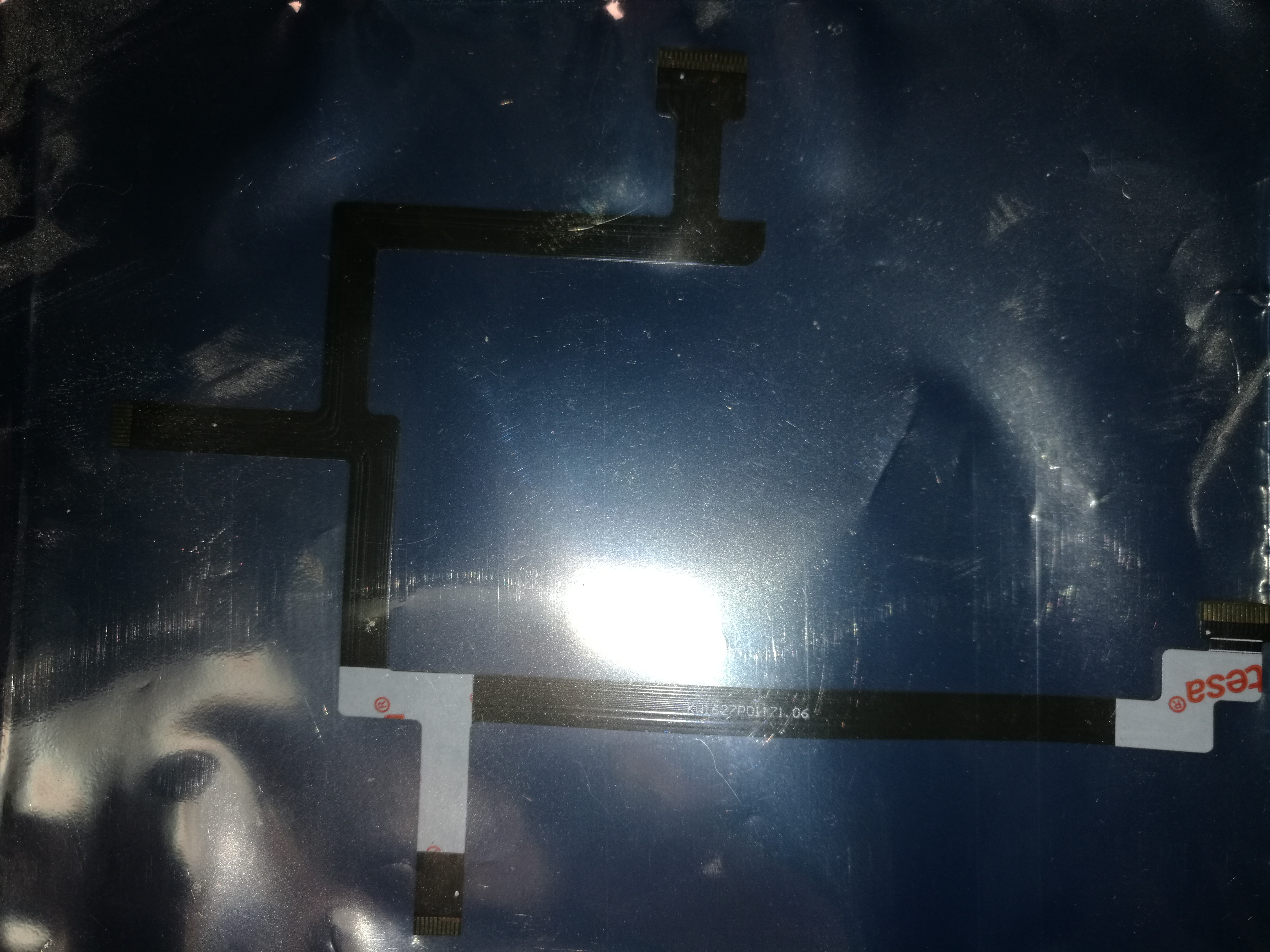

Reminder: I had a crash with the drone (30m high approximately). The motherboard was changed along with the small camera cable (which goes from the gimbal to the camera --> I attached a screenshot of it below).
Any suggestions?
