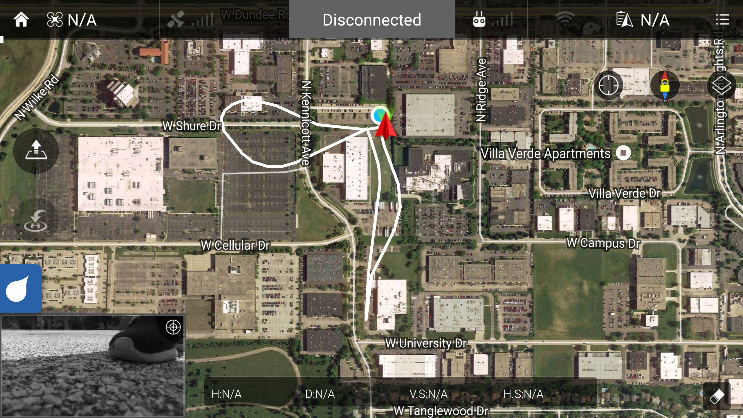

Ok cool,
So I enabled telnet and added the line for the TX power. I edited both rcS's (Controller and Drone).
Things I noticed....
I am not sure if an update came out today, but after changing the file and going to test, I got an alert that there is an firmware update I need. Strange as I flew this morning and didnt see that. I did not update it yet.
Second, when I first booted up to do a test flight, I didn't get any video signal at all. everything else was responding. I went to the Home screen in the DJI GO and back in to my drone and the video popped and worked.
I would have to say, as this being my first test, it went great. I did get a little hiccup in video around 1600ft out and at 200ft up. It could have went further but I brought it back. I usually dont get even that far in this area. As you can see from my pic, I am in the middle of a lot of stuff that kills my signals.
This SS is after my test flight just now.
