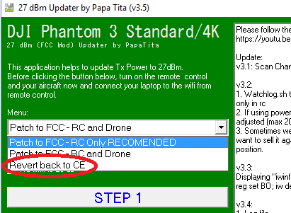

Hi PapaTita, does it mean that a backup of original files is stored in the directory where the app is running and when apply restore to ce, the original backup which was made before is written back to drone and RC?
Both options were the same, increasing the signal to 27 dbm both in rc and drone's. the difference is on watchlog.sh file which first option is only exists in rc while the second option in drone's as well.
Which one is used up to you. Currently the second option that I use with additional "scan channel".
There is no information after use this application make brick, I hope no.
"djiled.sh" file that changed and it was the same contents for all P3S, so the app just copy and replace "original.sh" back into devices

Tried to update, but the app failed oddly. And advice welcome!
Here's what happened (I'm using Windows 7):
1. Opened app.
2. Connected to RC Wifi.
3. Selected "RC Only" and "Scan Channel (13). Didn't select 20dB limit.
4. Pressed "Step 1"
5. Update gets this far then does nothing for about a minute:
6. I get this error message. Pressing OK dismisses the error message, and I'm just stuck with the screen above.
