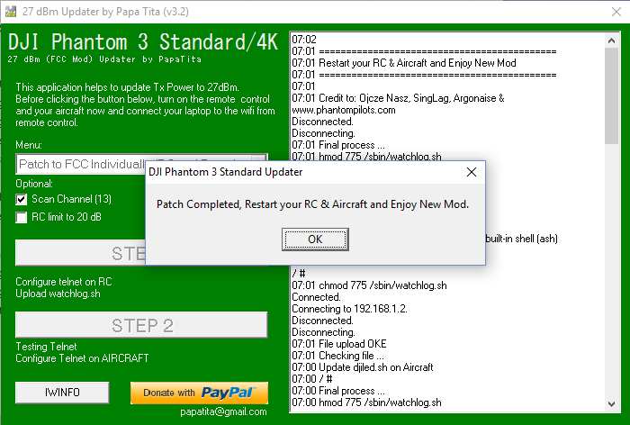

Hi papa I did exactly how you described from your video and downloaded the djiupdate and the code seems to say its still in 17dbm what have I done wrong? I have the P3S and clicked 13channel option. I am also in Australia.

Hi papa I did exactly how you described from your video and downloaded the djiupdate and the code seems to say its still in 17dbm what have I done wrong? I have the P3S and clicked 13channel option. I am also in Australia.....
Many misunderstandings occur so that the information box at the right be interpreted as the end result mod, whereas the modification results will only be known after the restart.
I try to revision the application *** by displaying "iwinfo" again at the end after sending command to rc: "iw reg set BO; iw dev wlan0 set txpower limit 2700"
***DJIUpdate v3.3
