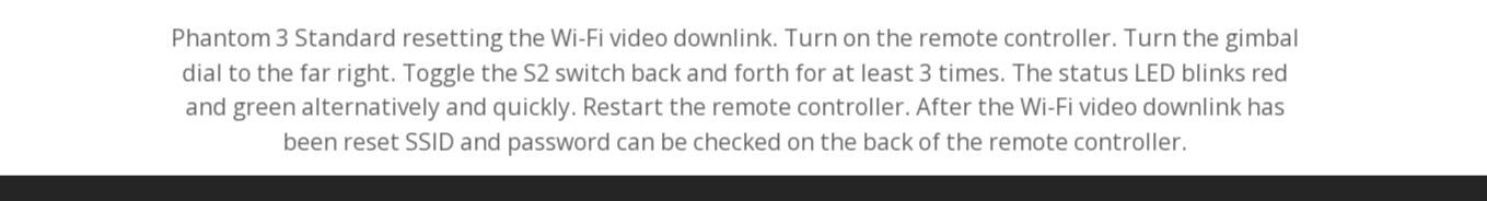

I’ve tried doing the whole “wheel turned up and flick S2 switch 3xs…”. Also tried going somewhere more remote and seeing if that helps.

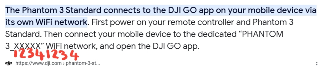

As I recall the WifI Signal, comes from the remote you don't need the Phantom turned on, I may have a remote that still powers up, I got a link of somebody made of the RF signals of the P3S. Confusing but I think its real.

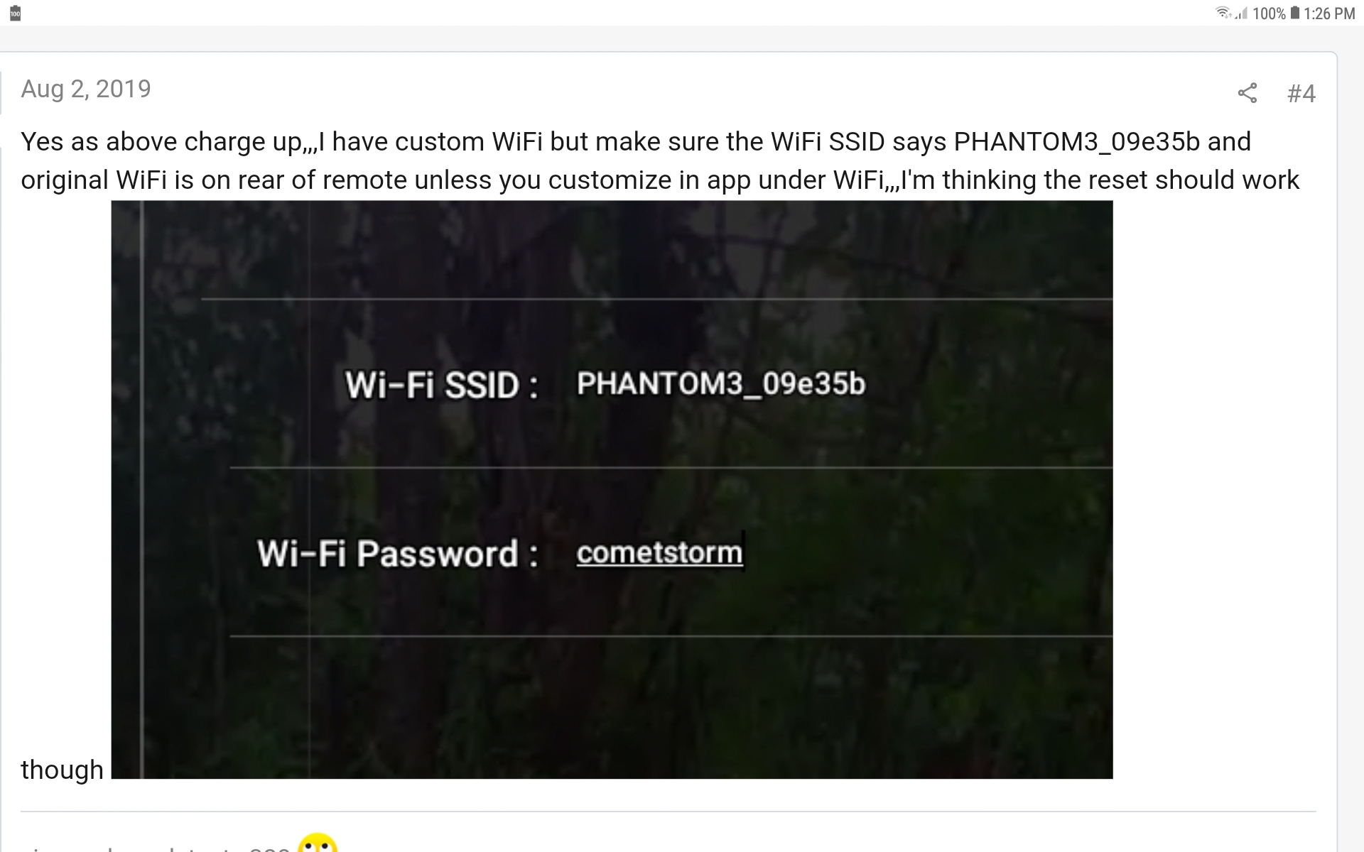

Found this from old post,,,factory password is 12341234 but can custom it.....
bit odd this actually because it should do all this by itself everytime its turned on if I remember right so make sure you save

Another question for @rughead04 is when you flick switch does the remote give a long beep ? That will confirm its reset,,The method above I post not mention that part

When I flick the S2 switch to do the reset, I get the flashing red/green light on the remote. I don’t believe there is a long beep though.

devices normally search for wifi,sometimes you'll get a list of nearby but because they locked they wont connect until password is given to connect,,see if refresh of your wifi picks up the phantom,if not ,enter it manually, have you tryed this,info on back of your remote,password,ssid,
I ask this before and pretty important part of it working
could guess all day long so need you to look at your device wifi list,,if phantom not there,put it in there
