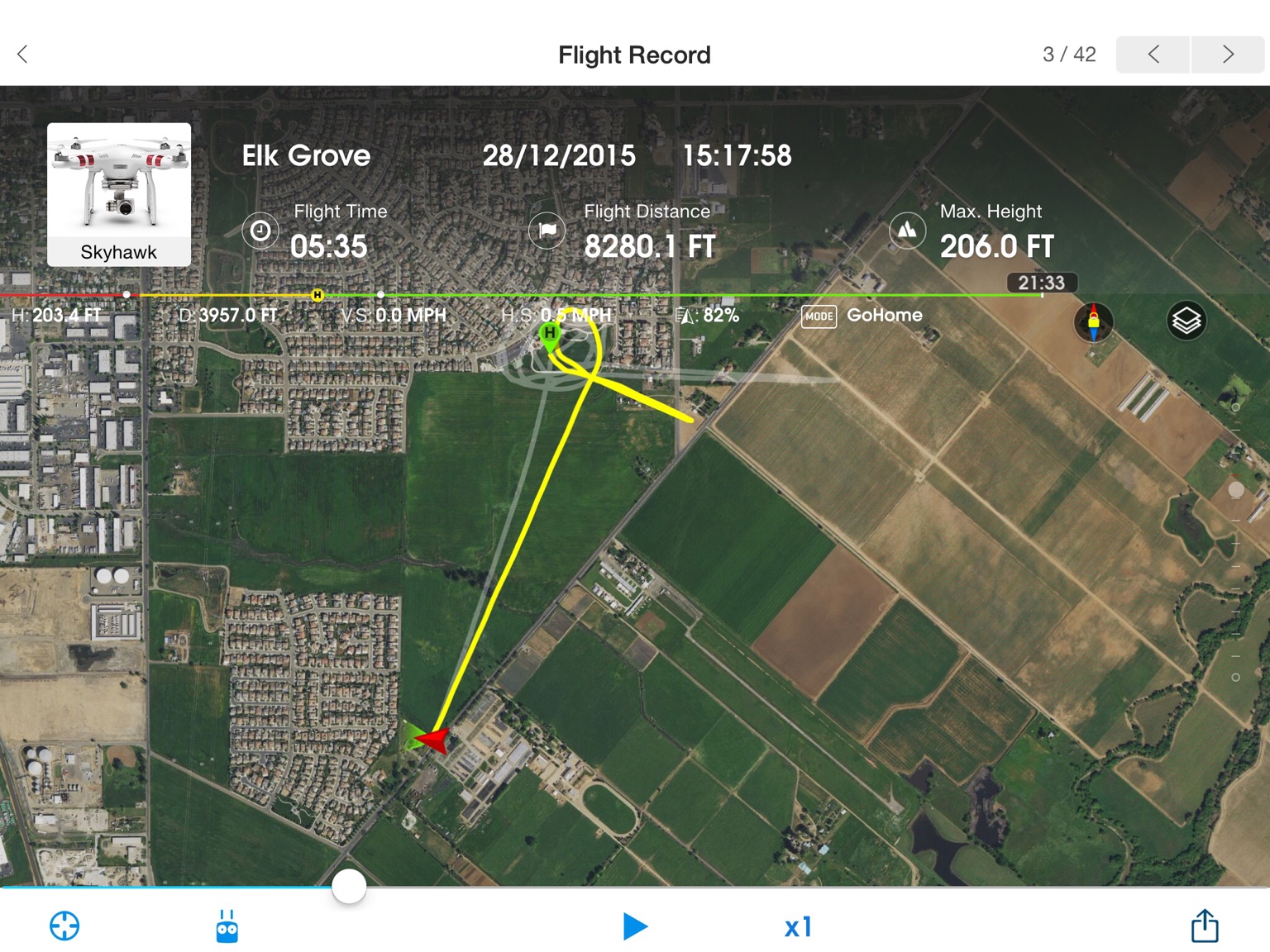

After switching to the thin cables that came with DBSmod kit, I took it out yesterday and today with a total of 8 flights at 2 locations. I was able to push it one time close to 4000 ft as seen; only 500 ft better than stock. But I could not repeat it even flying the same path a moment later. The rest of them were mostly around 2900 ft or less. I currently do not glue the connections since I'm still testing it. Do you think this helps? The connections look tight without the hot glue.

I'm getting frustrated since I would expect to double the distance with the mod. I'll probably put stock antenna back on tomorrow and test it again. The connections look really clean as you can see. I'll also contact @DBS but it seems he has not been to this forum more than a month.
Am not really sure what this issue is but it looks like you are going towards the most interference out there . Can't you go towards the fields .
