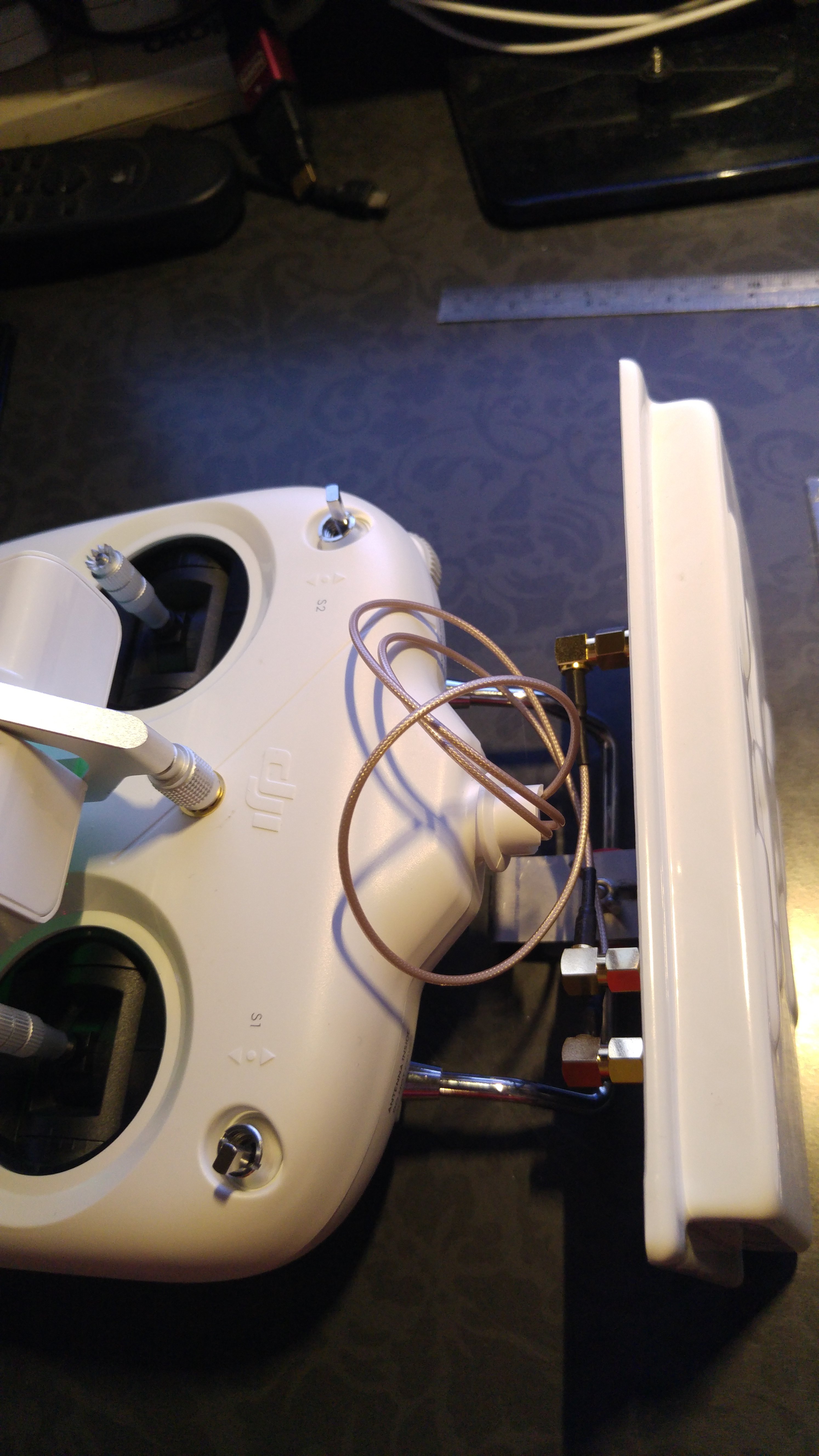

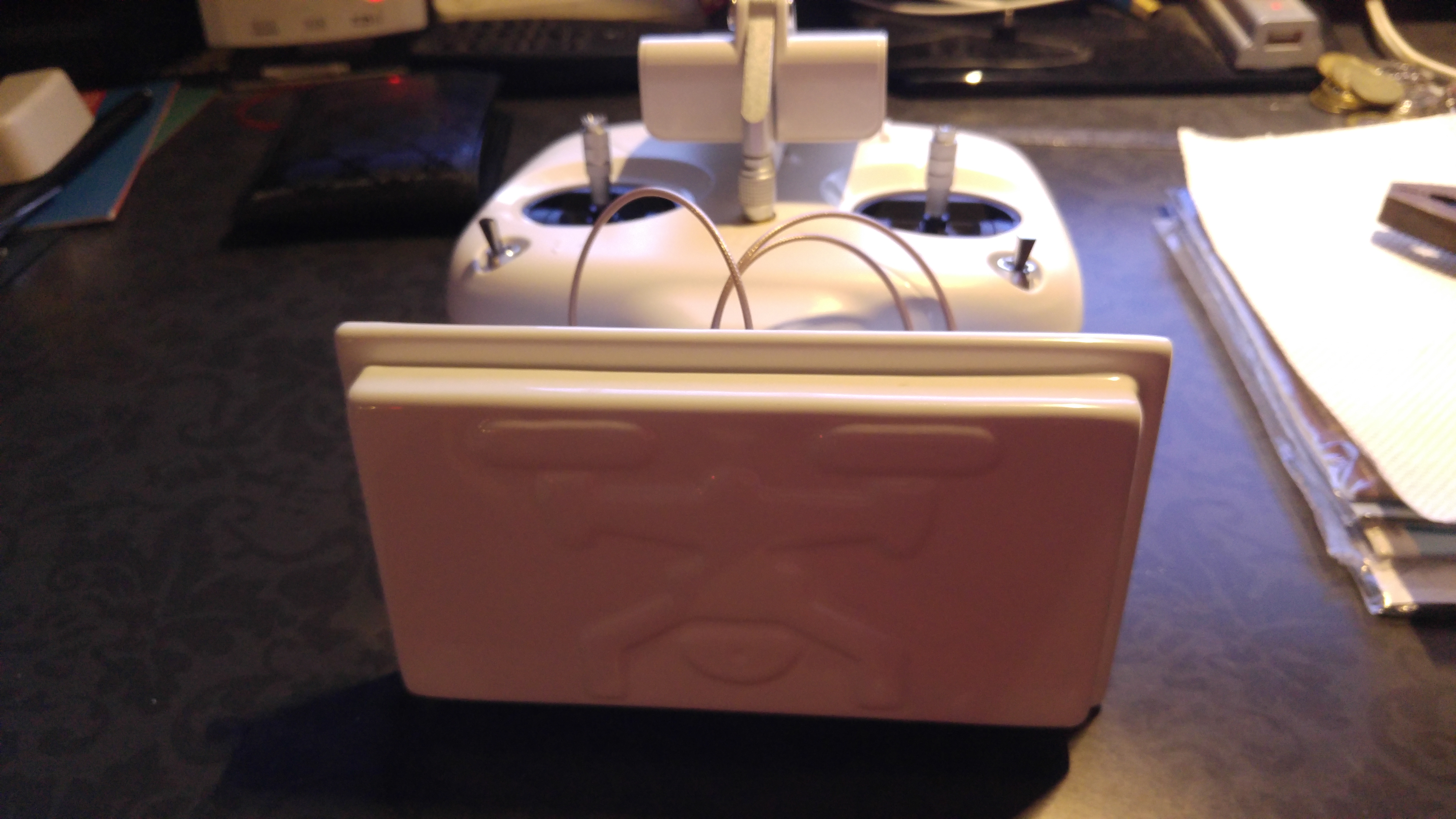

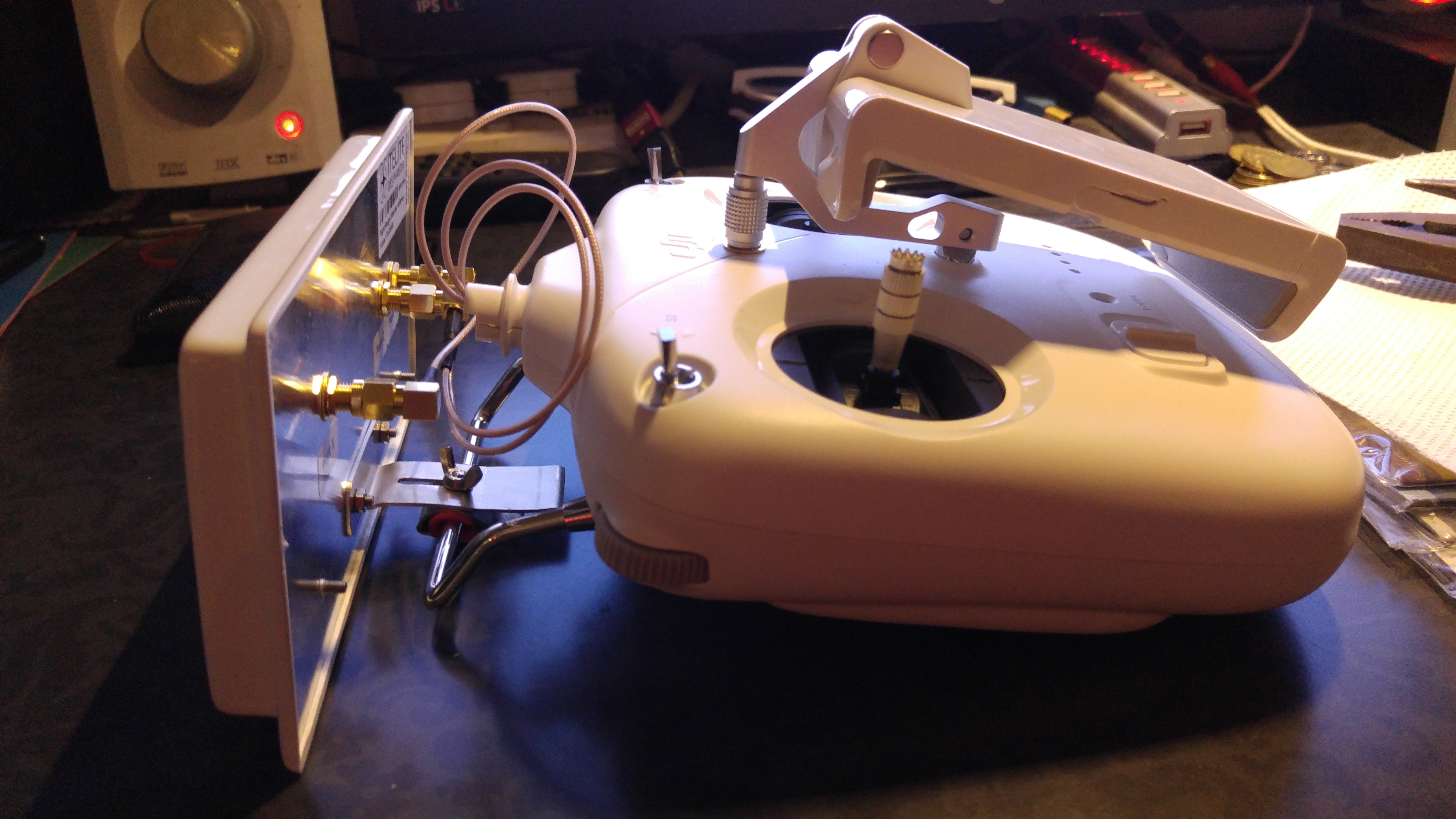

After reading this thread, I decided to take the plunge to install DBS01 antenna.
Here's some picture of the finished product, no drilling involved.
