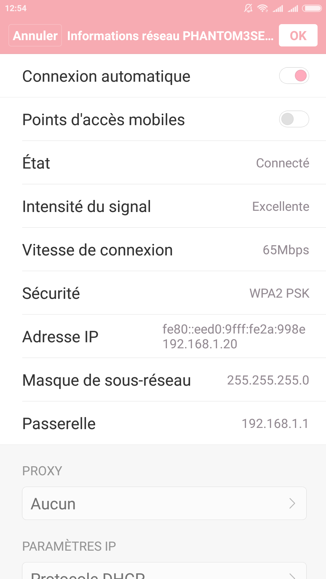

Hi phantompilots, im in french polynesia, i've a PH3 SE new, my phone is a xiamoi 6.4" MAX2, i've installed the modded 1.3.18 v of DJI GO because the version of the playstore gave me "wifi" problems, now that all seems ok i try to fly but the drone doestn't do it, i attach you some caps and video, help me please

Neon Euc, i think as you, the problem is not on the phone. Well, according to the fact of linking the controller to the drone: IN P3 SE is not possible, you find the option on the DJI GO, you can click it, it give it 60 seconds to introduce something and push a bouton on a small hold but THERE IS NO BOUTON, when i introduce the thing i dont find any bouton, it doesn't exist. It's not possible to link the controller in P3 SE. I'll try to send you pictures now.

Verify that drone is well connected on Wifi Settings of SP
