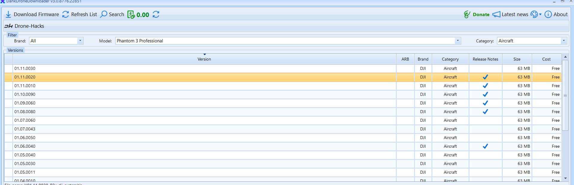

Just an FYI you can find all the FW's using Dankdronedownloader tool.
It also will need debug bin file
A full set of these can be found in this thread
Reactions: RodPad
