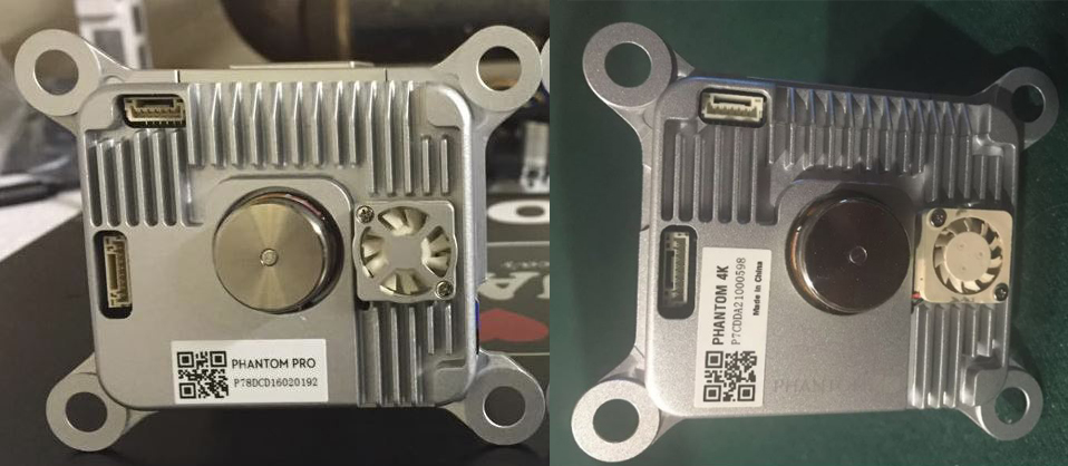

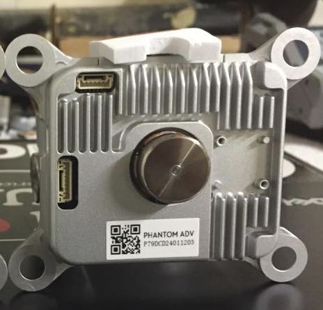

The labels are one example of something to look for when deciding. Of course, the labels are probably not too difficult to swap for a nefarious seller. Here are a few examples.
