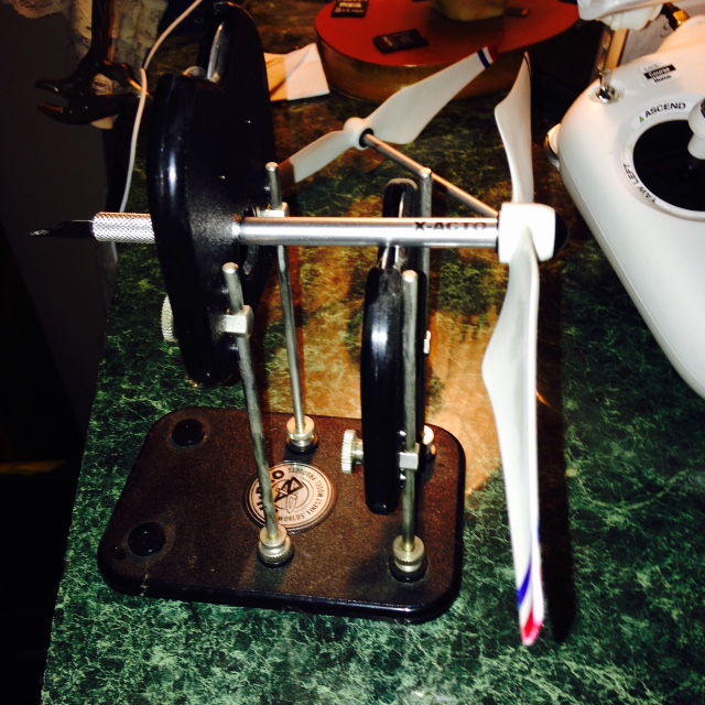

Yep..ya need one like this http://www.ebay.com/itm/DJI-Phantom...Balance-Rod-/201411787133?hash=item2ee513f97d
I prefer the small X-ACTO handle over the pencil and would do it like this FullSizeRender.jpg in a jam but sometimes ya just got to improvise !
