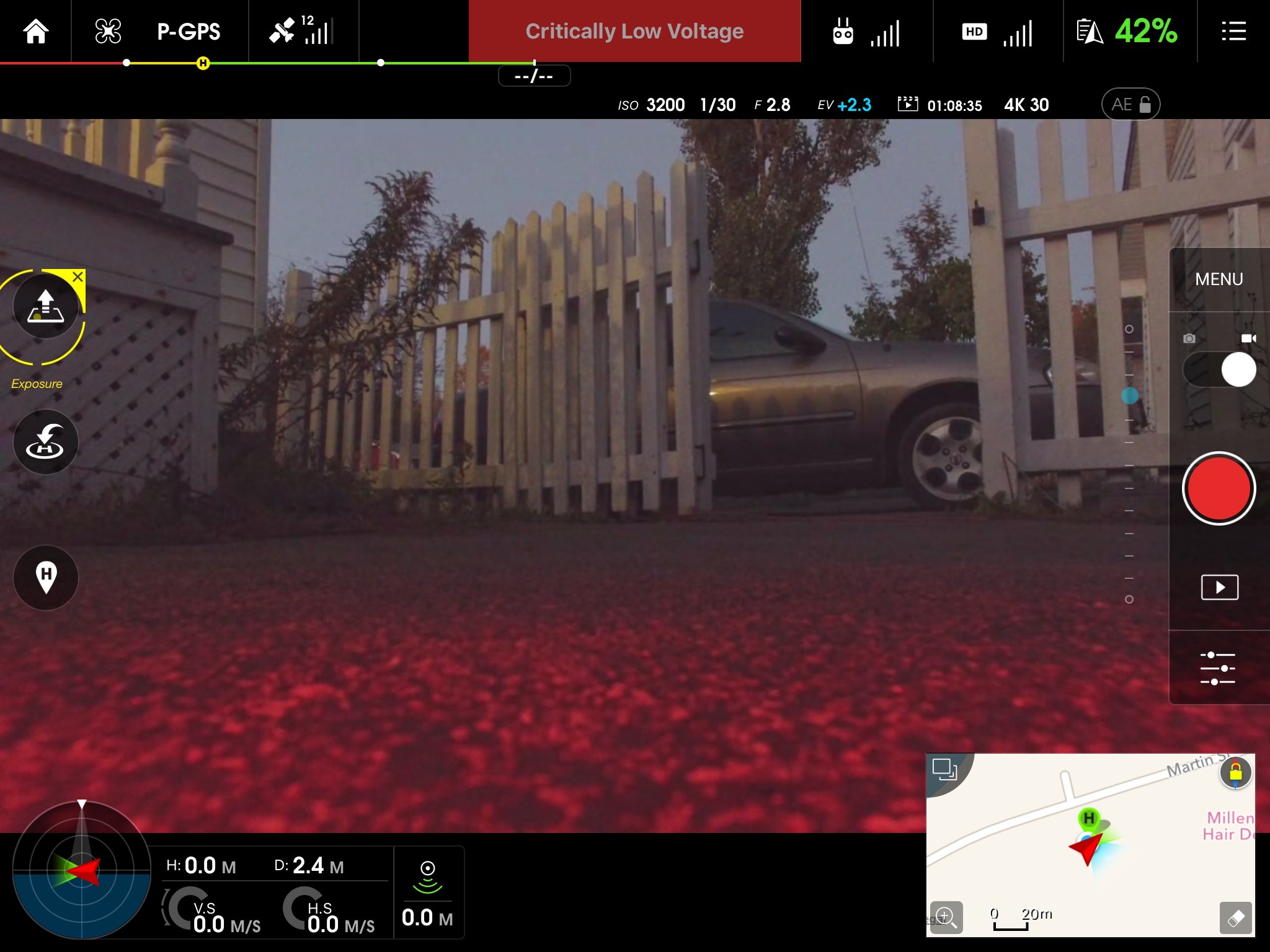

This just happened to me an hour or so ago. Luckily I was able to land. Not leaving me very confident to fly this thing now. There's obviously an issue here somewhere.

not sure whats going on there. Did you recently update the controller fw curious to know

How can it say critically low voltage at 42%?

Did you check the cell balance on the battery telemetry screen? A low cell may produce this error.

Could you please tell us how to go about that? To me, they just look like a bunch of cool green bars [emoji4]

Anytime you get this error go to that screen and see what the voltage is on each cell as indicated by the cool green bars. They should be all relatively equal-- if one of the cells is .10 or greater lower than the others then there is a problem with the battery cell balance. In the case of the critical battery error, I would suspect to see one very low cell, maybe as much as .30 to .50 lower than the other cells. If the individual voltage on any cell close to 3.0 volts-- then don't use the battery unless you can balance the cells by recharging it.
How many flights do you have on that battery and how low do you usually fly it?

All my cells were fine. No problems on healthy drones. This was before the transmitter update, but right after the latest app update.

Put the battery in the drone, take the props off and run it down and see if you get the critical battery message. If you do, check the battery telemetry screen and see what it tells you.

Yeah...good capture and lucky you got it landed. What was your battery % when you took off and how long had it been since it was charged.
