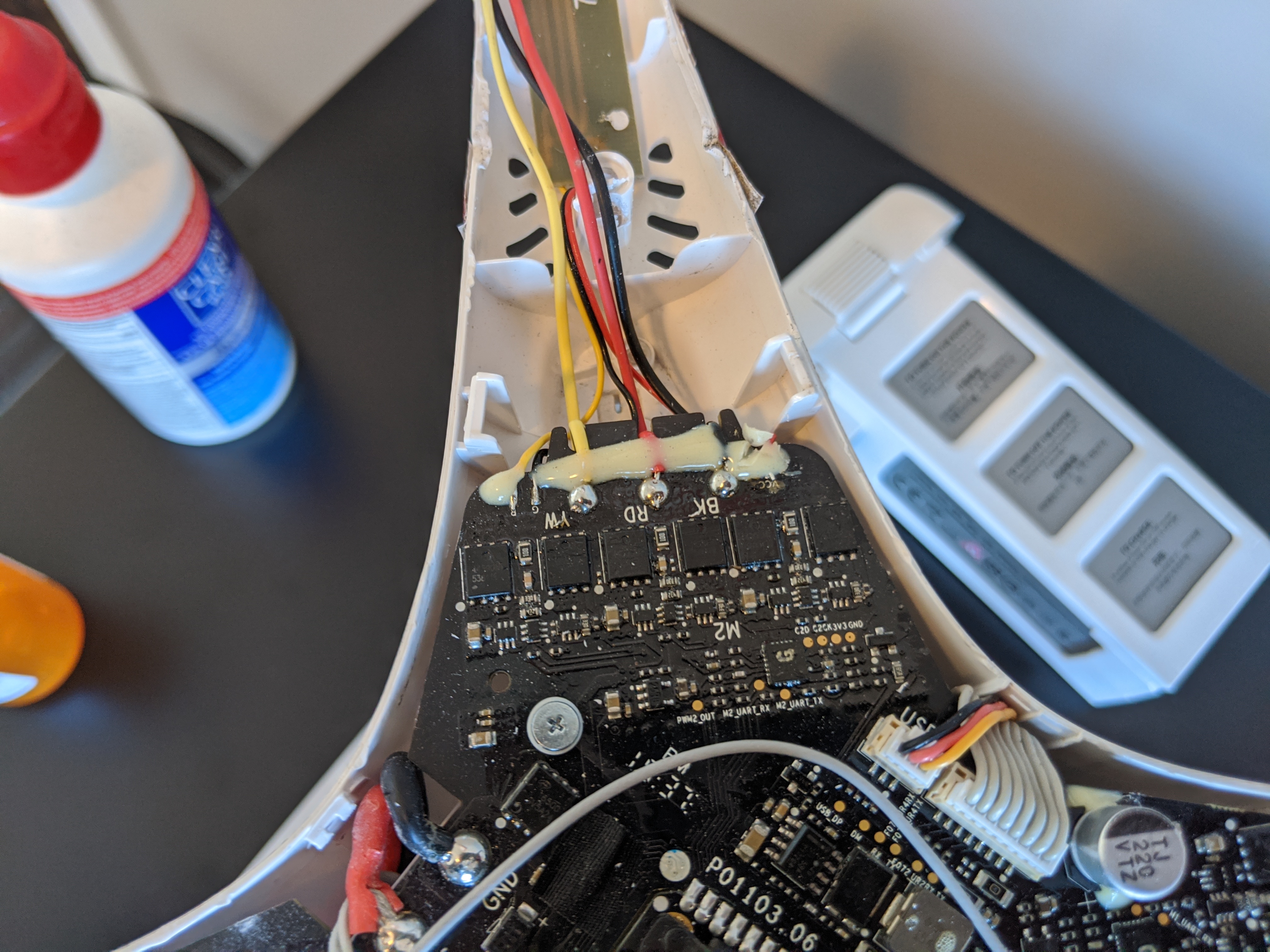

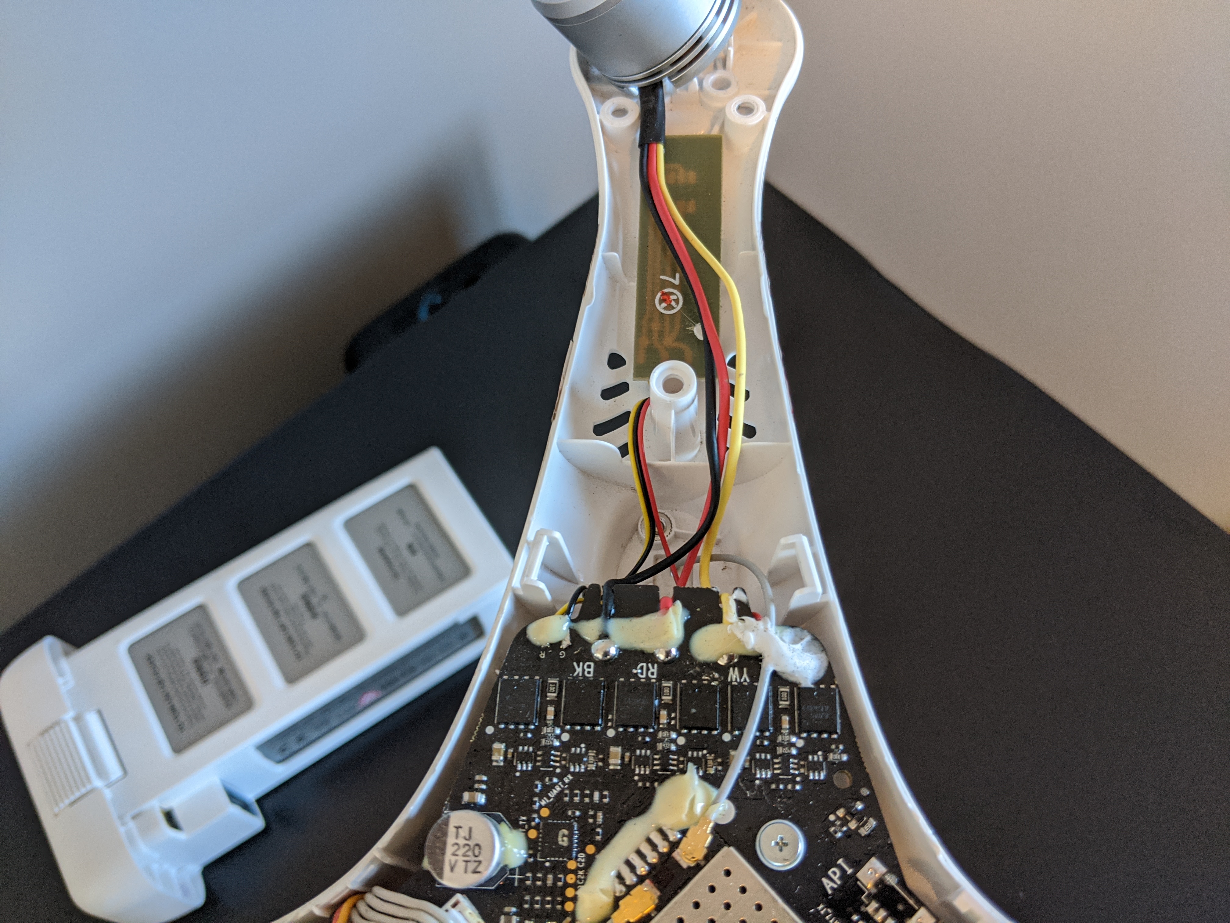

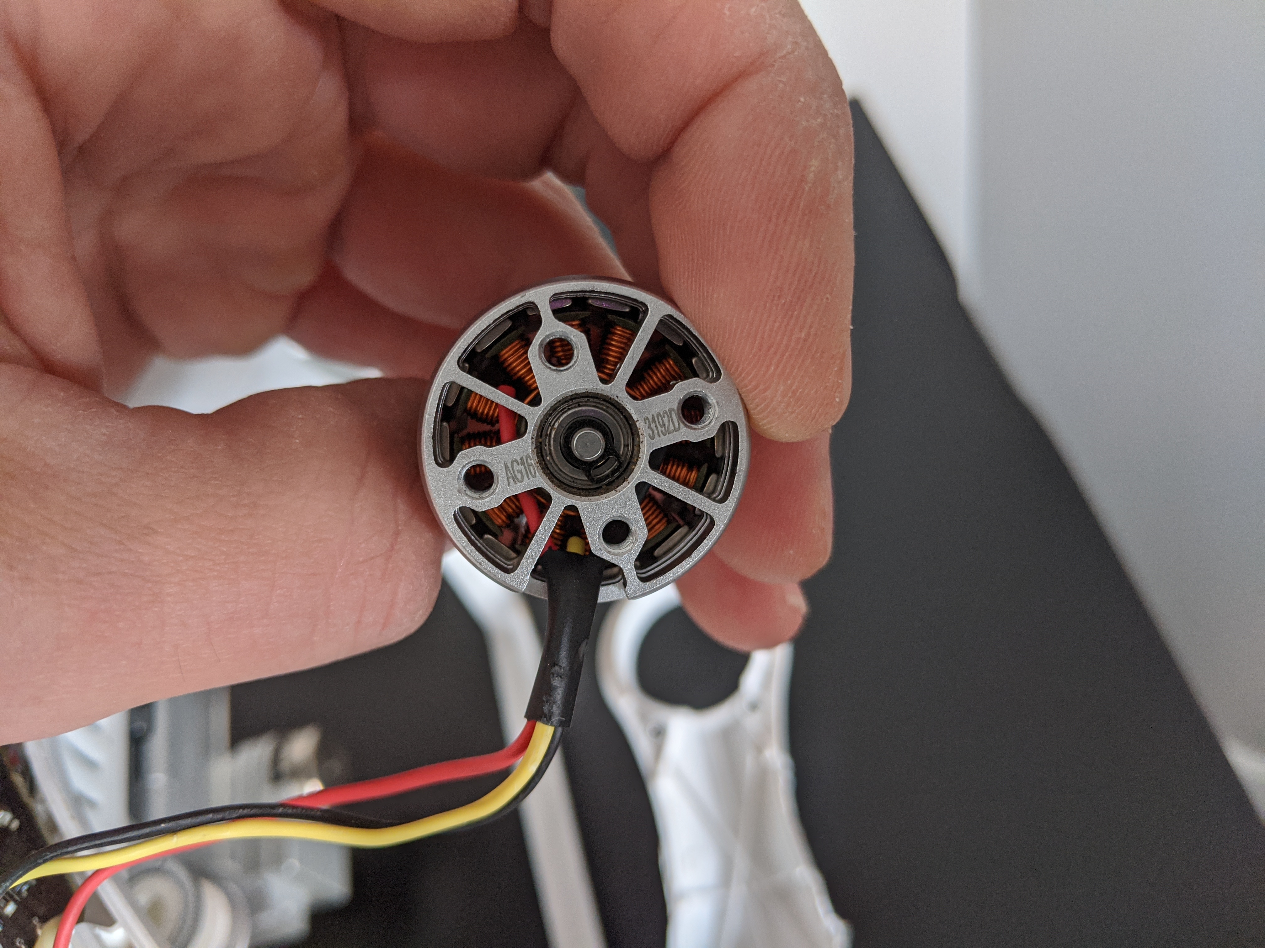

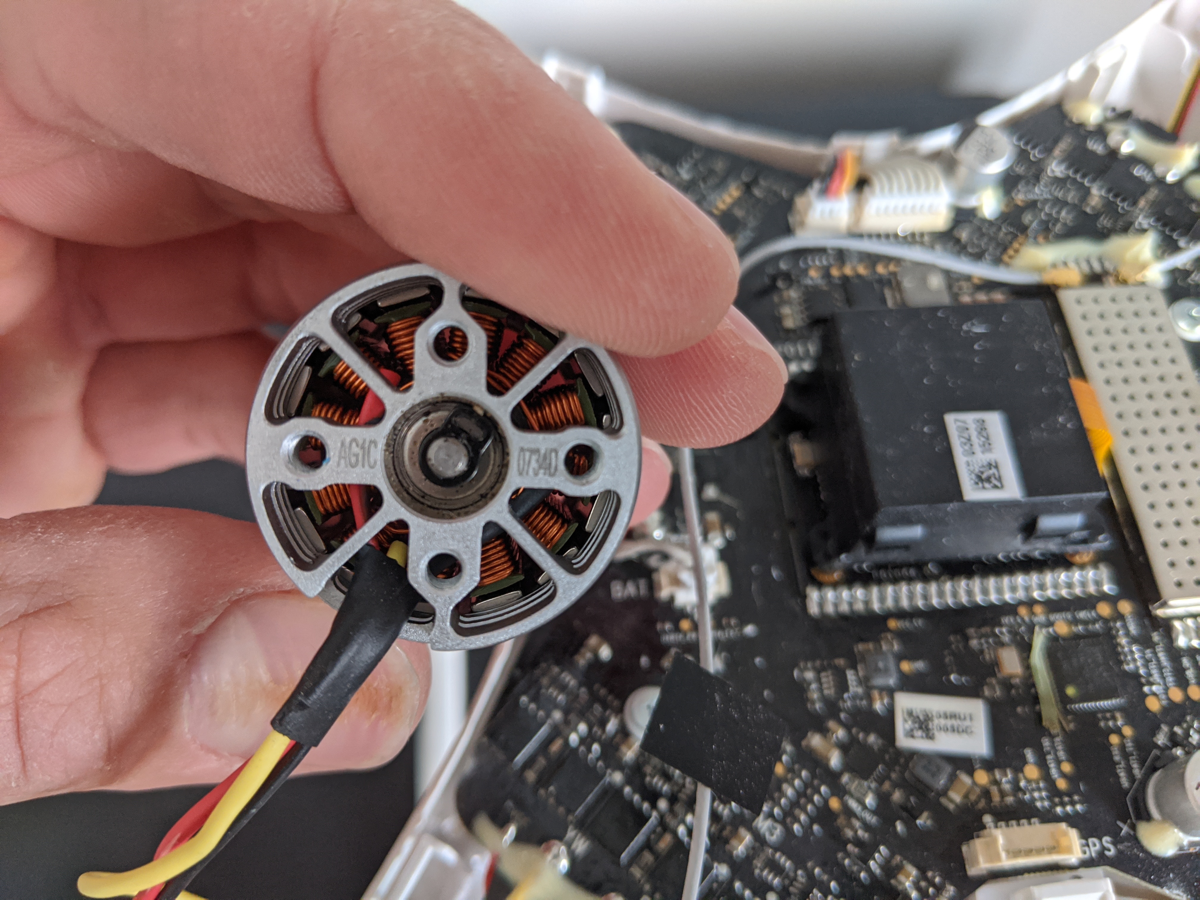

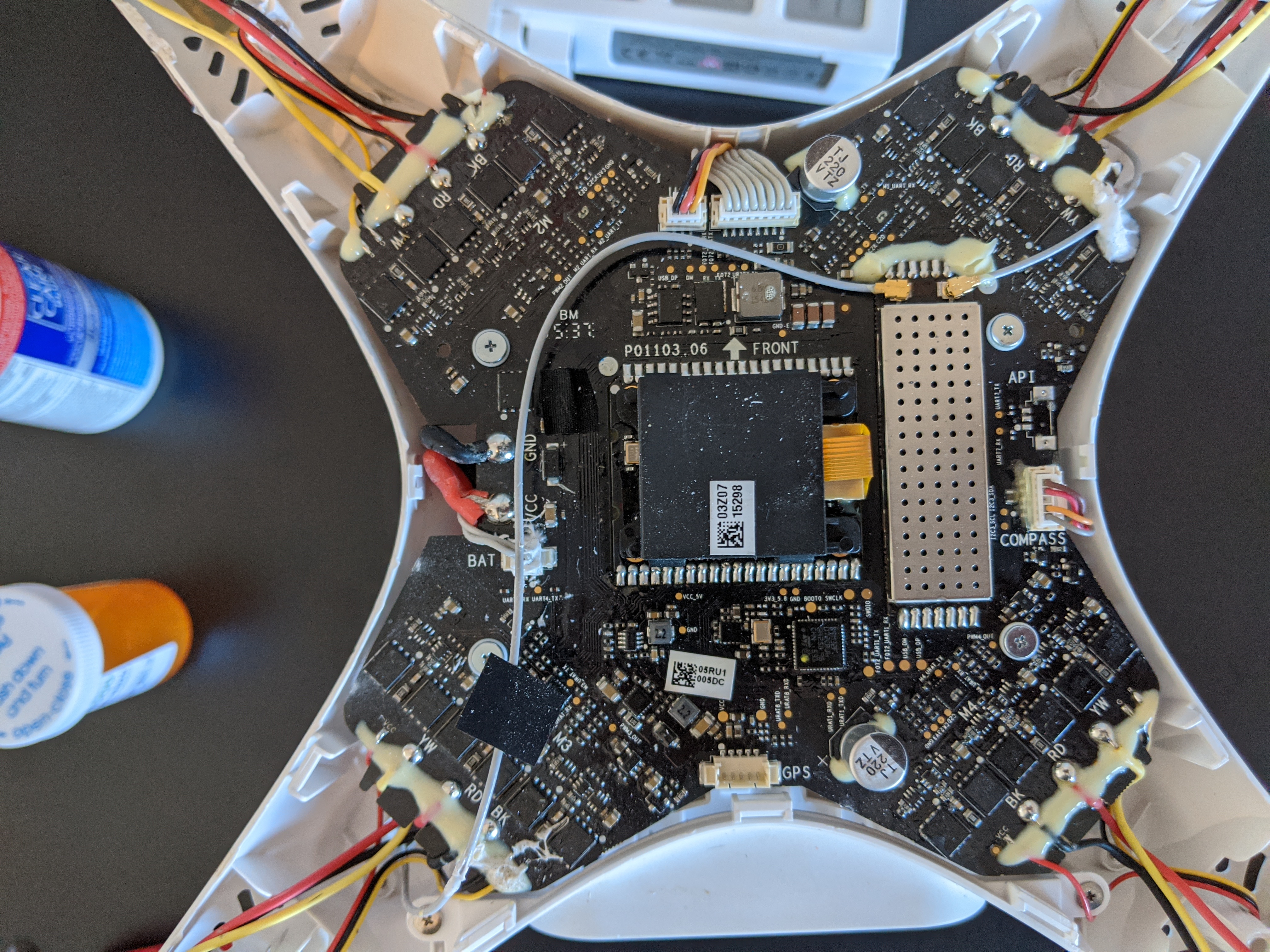

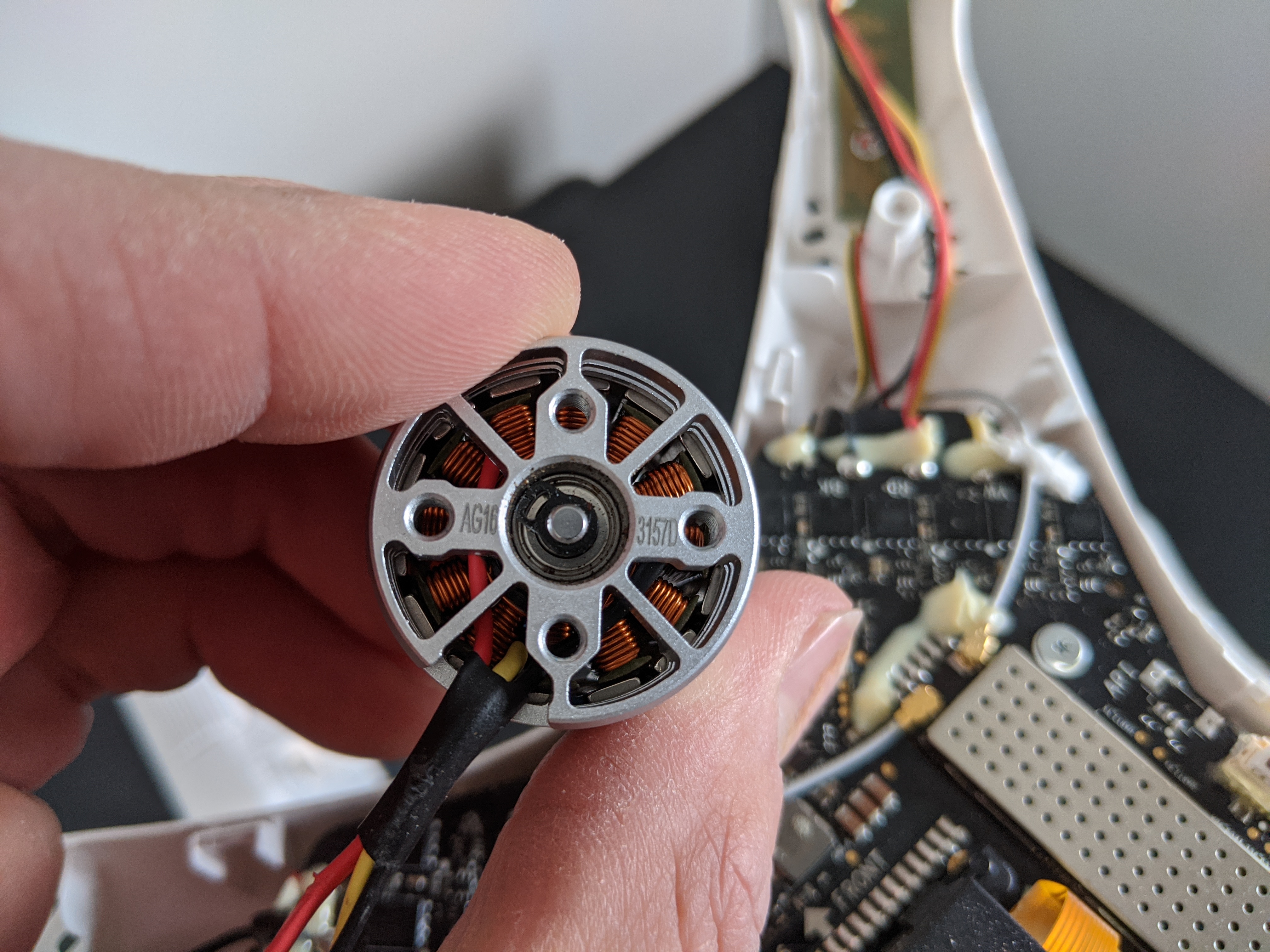

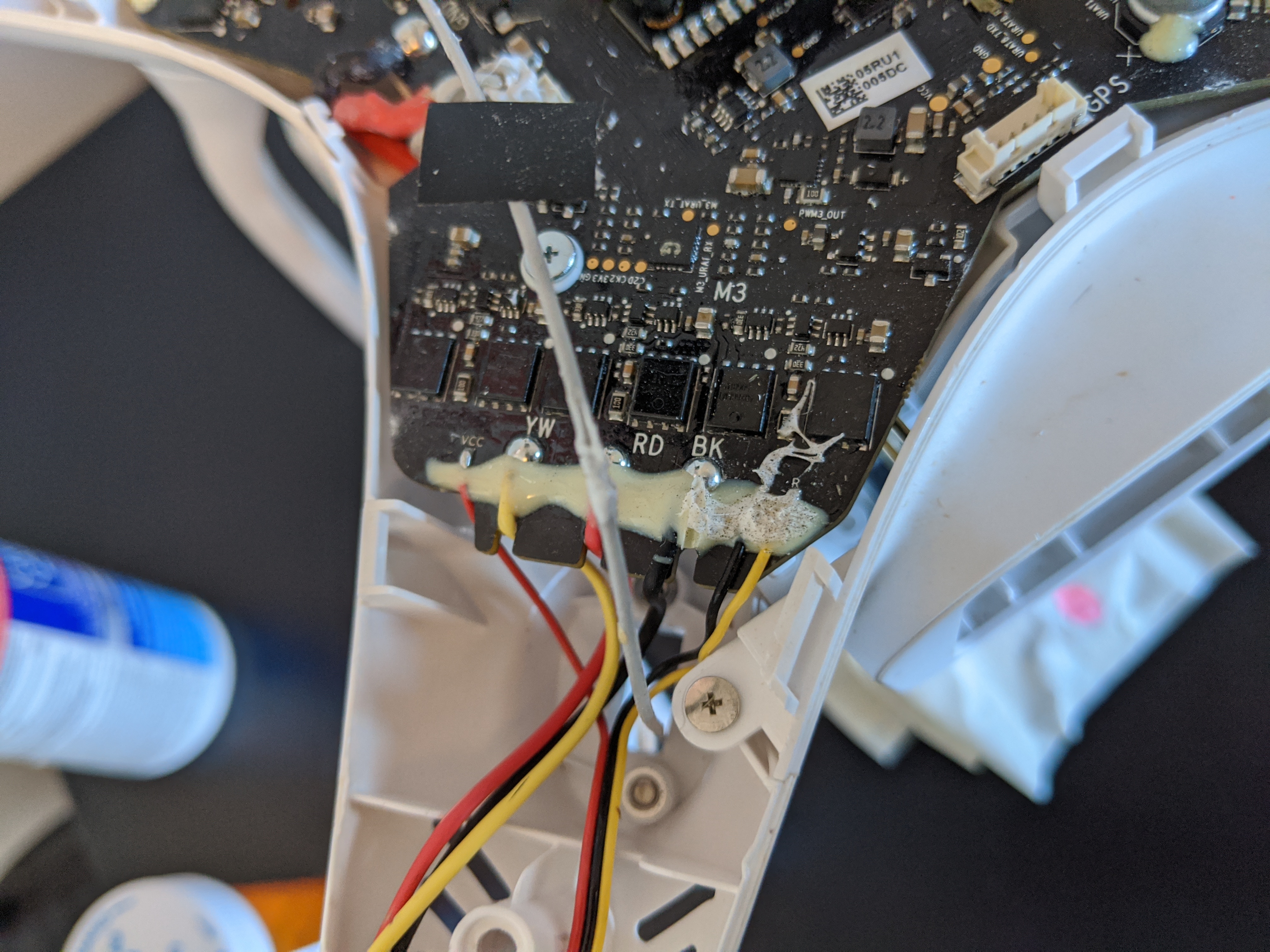

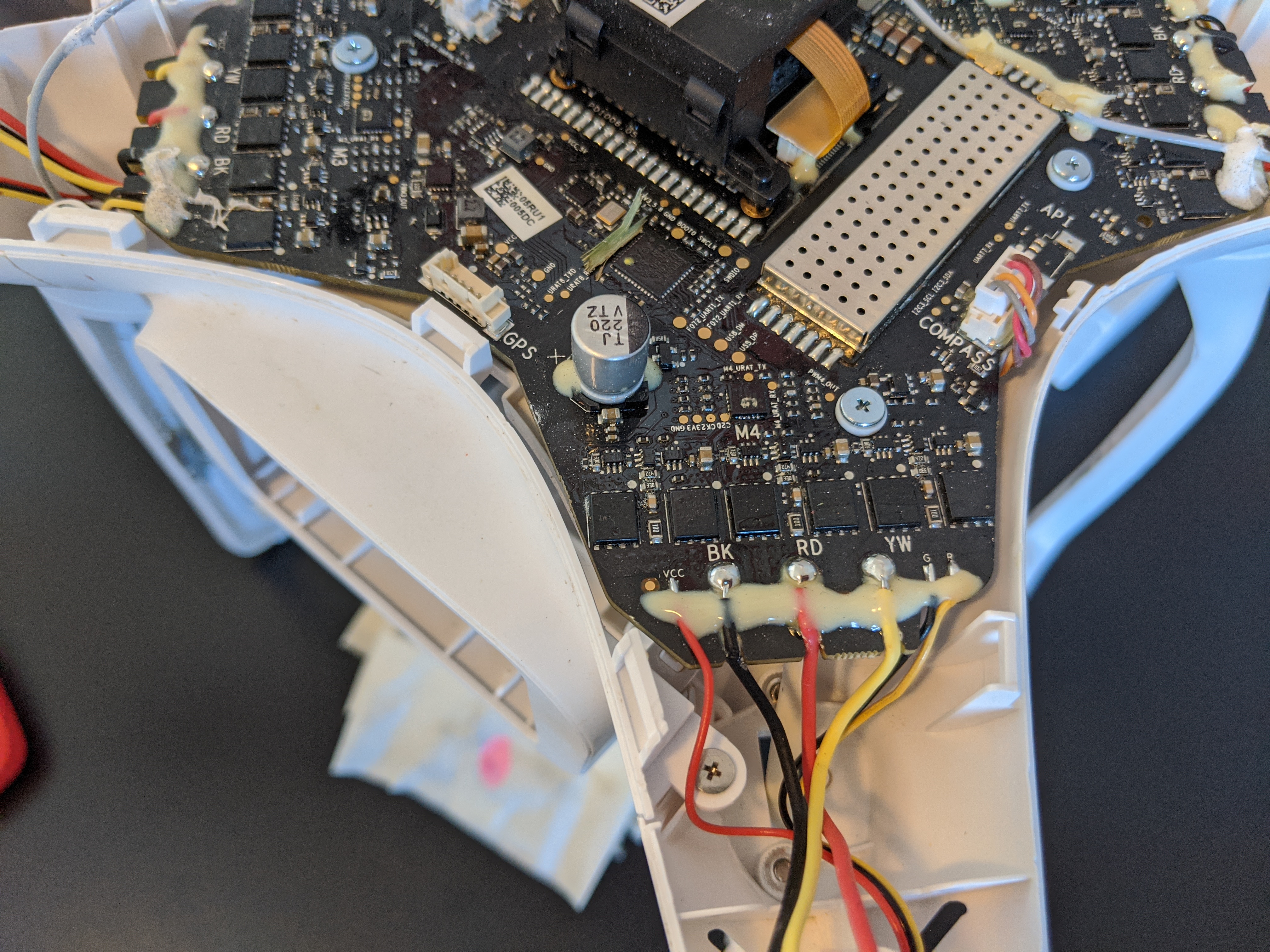

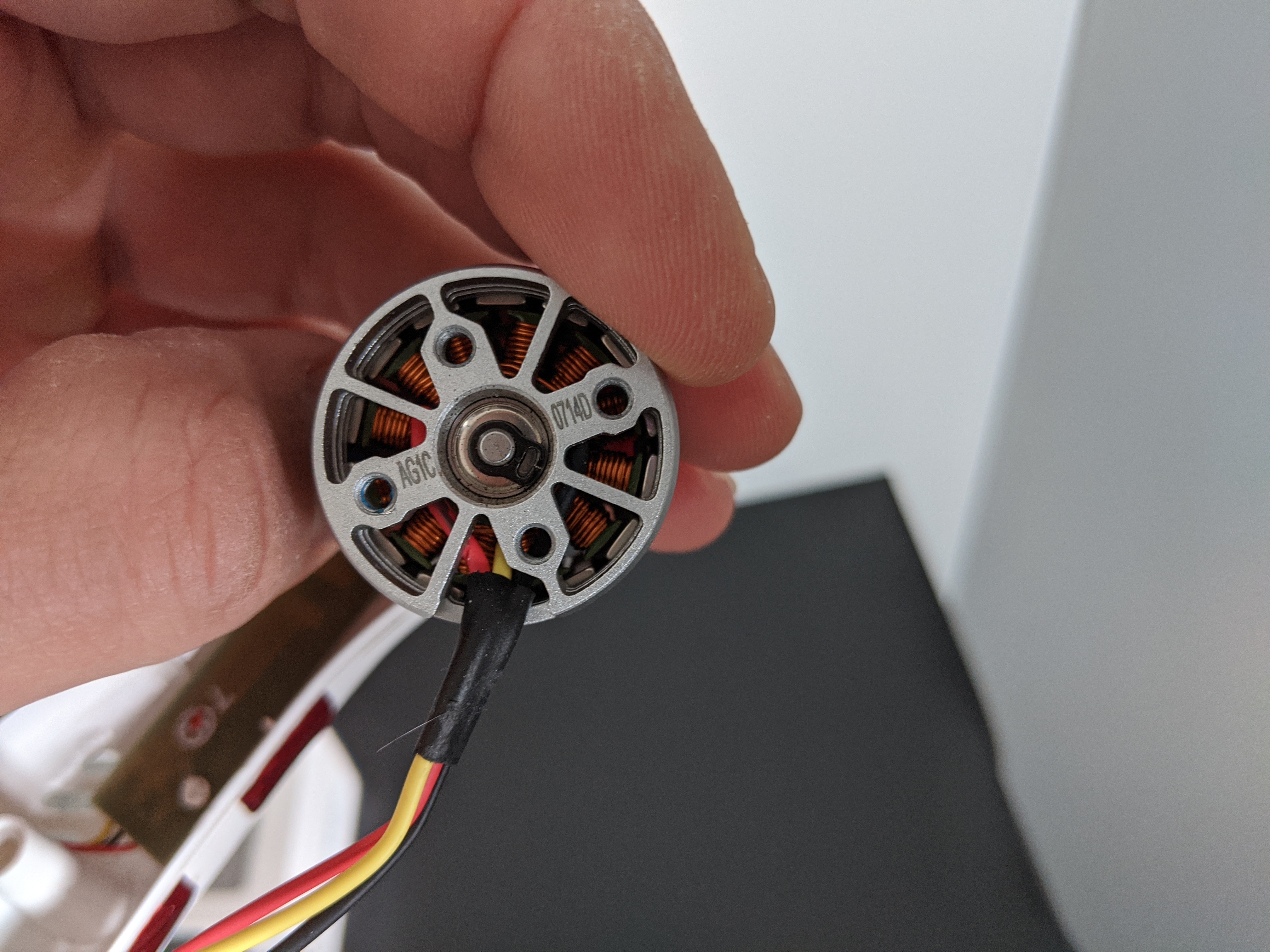

Thanks for the help so far. May have been just my ineptitude, but when I tried to run the motors without blades, they spun quickly for a second then wouldn't try again. I opened up the housing to see if I could see any obvious signs of damage on the motors themselves. One makes an audible clicking noise as I manually turn it but I was thinking I might just replace all 4 for simplicity sake. In the pictures attached it looks like there are a couple corroded spots.. is there anything else obviously wrong with the board? I'd hate to replace the motors just to have the issue end up being ESC related or something similar. Also, does anybody have a link for these particular motors? It appears there are many different kinds out there and apparently lots of fakes, even if you do find the right ones.

IMG_20200925_134941.jpg Possibly a bit of overheating on the RH connections.
Motors shouldn't "click", they should be smooth and silent.
IF you are going to change out the motors make sure of your SOLDERED joints.
Make sure you get the right motors - those look like 2312A.
As long as the joints onto the PCB are solid, not gone "dry" (possible problem where there is evidence of overheating), you can just cut the wires off midway between the PCB and the motors (saves trying to remove the glue), and then remove a short length of the insulation, SCRAPE THE VARNISH OFF the copper wires. Before twisting/soldering slide a length of heat-shrink tube along one of the wires and then once soldered slide it over the joint to insulate it.
Twist the ends tightly together and then SOLDER them - slide heat shrink over the joint.
If you're going to completely remove the old wires then you'll need to remove the glue from the joints first and then unsolder each of the three THICK wires making note of which colour goes where (you've got the photos so no problem there) and then re solder the new motors in making good clean joints. Try not to overheat the PCB.
