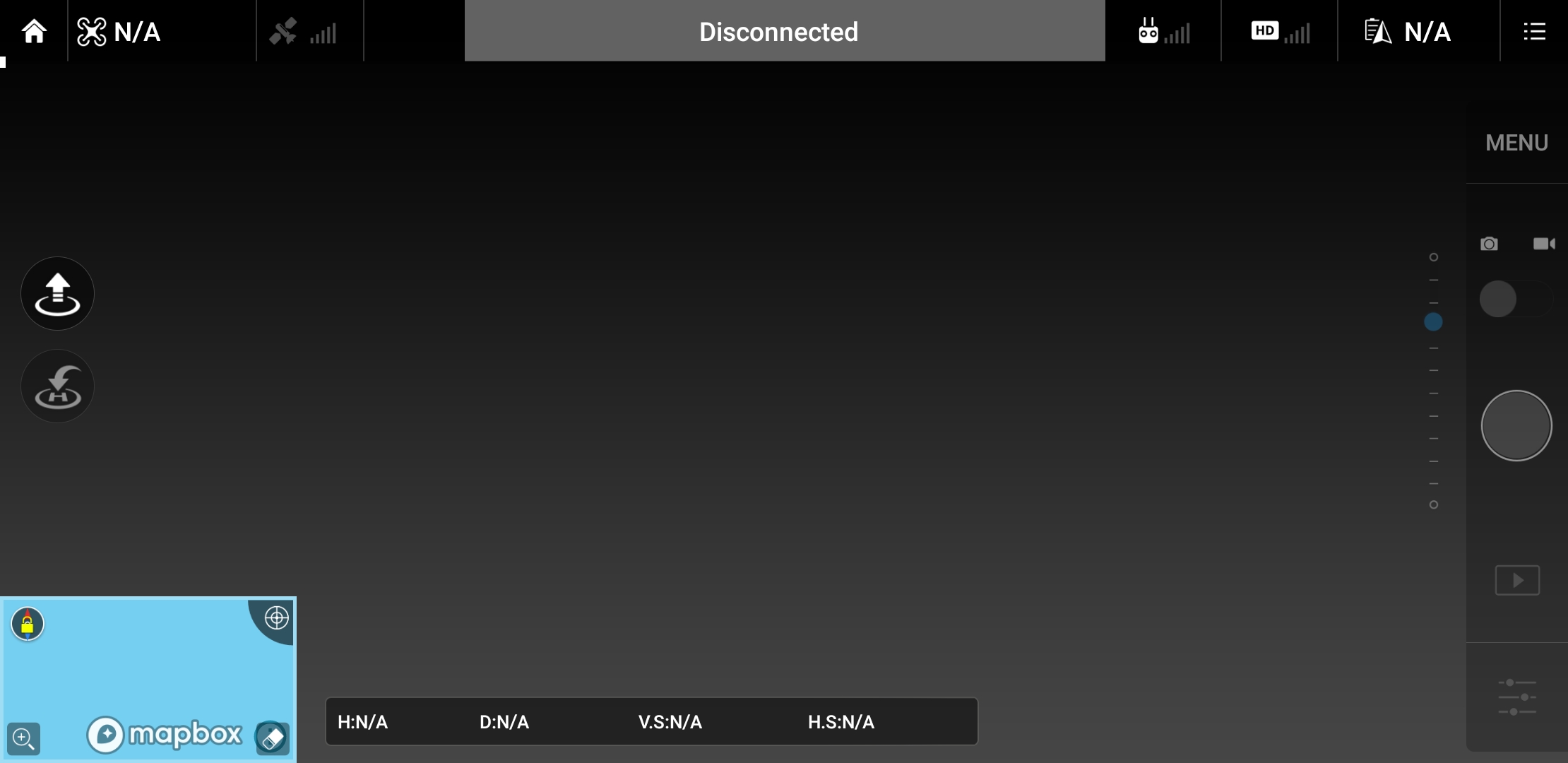

Hi after getting my old trusty p3p out of hibernation it isnt seeming so trusty anymore. I am getting this app disconnected message on both ipad air 2 and galaxy s9.
The motors start and i am able to work the gimbal but no video feed? Any help would be great thanks.
Sound to me like the USB board on the remote controller is faulty. For whatever reason, it happens. What model of remote do you have? GL300A’s was common for this to happen after long periods of inactivity.
Have you tried a different data cable from remote to the tablet? Start with the simplest things.

Sadly, it's not entirely surprising. Along with the overheating issue with the gimbal board, we have seen reported many times that memory chips (NAND) used by DJI develop bad blocks during a period of inactivity. It seems like that whenever we see someone start a new thread with, "I haven't used my P3 in a long time. It was working perfectly the last time I used it....," the very next sentence is often, "and now I have no image transmission" or something similar. The issue with NAND could be the root cause in these cases.
As @KachemakDiver noted, first start with the simple stuff.

Hi thanks for taking the time to reply. Yes its a GL300A and heve tried different cables and ipad and android.

I have jyst fitted a used but supossed to be working order usb board but still same issue. I can control the quad and take pictures but no video feed or aircraft data battery status, sats etc?
Is the “used usb board” that you installed, specifically for a GL300A? It is a very different board than the board for the Gl300c and GL300B.
Well, with it not showing any telemetry and any other aircraft data,I’m wondering about the OFDM module under the vision position sensor. It not only has the antenna connections, but also gets other information from the aircraft motherboard.
I had a bad OFDM on a P3P I bought a while back. It just showed a no signal error message. Not sure if it would interfere with the image transmission problem though.
