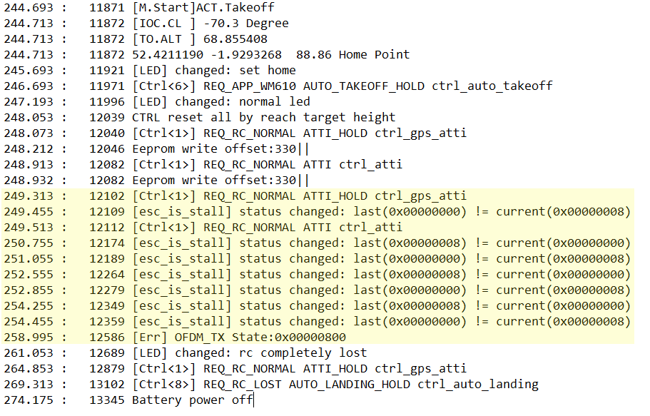

The ESC stalled messages are all after it has toppled over and the props are blocked.

Time is shown as the first field on every line in the eventLog stream, E.g.
187.058 : 11632 [Ctrl<1>] REQ_RC_NORMAL ATTI ctrl_atti
That part I knew. I was looking at the .dat file directly in CSV View and judged the timing wrong. Reloaded the .csv file instead and it lined up perfectly. Just looked at the data timing wrong.

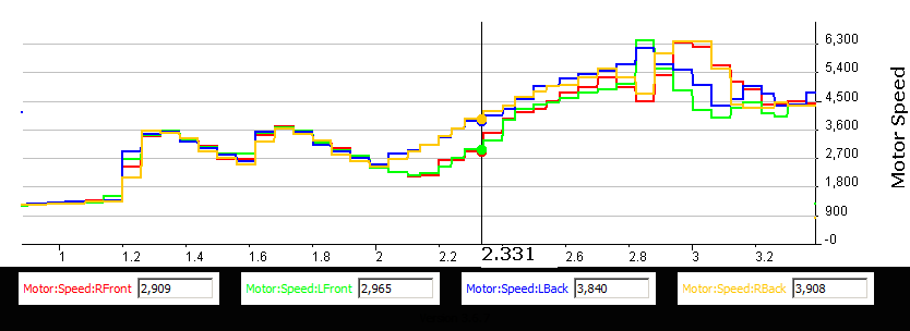

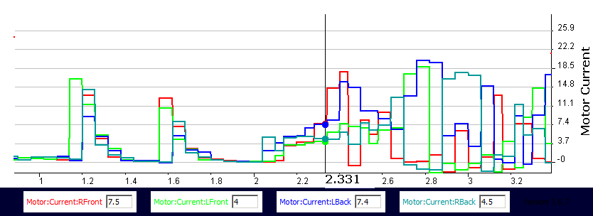

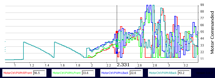

I would. It's almost certainly some type of HW problem. I noticed that at 2.3 secs the FC is commanding the motors higher and the response is higher currents
113116
113115
but the speed increase isn't what you'd expect.
113117
There is a normal response for the 2 burst startup but there isn't the expected spike at 2.3 secs.
That’s sad. Apparently one motor is either not spinning or not spinning fast enough on your crash side. Looks like the back one on the far left, to me. Don’t know how to read that on the charts. Hopefully they’ll send you another one, or you can buy another one with your refund I guess. Have fun fly safe.
