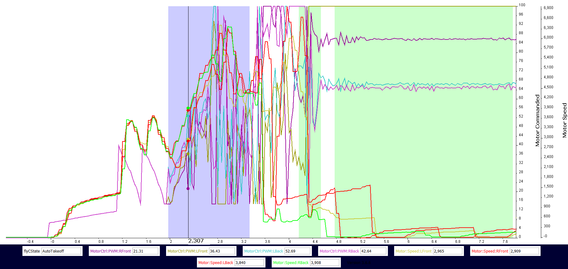

FLY249 looks correct. You definitely have a motor and/or ESC problem. I would have to do more detailed looking to descern which since this log is so very short. But I would ground the aircraft for now most assuredly.

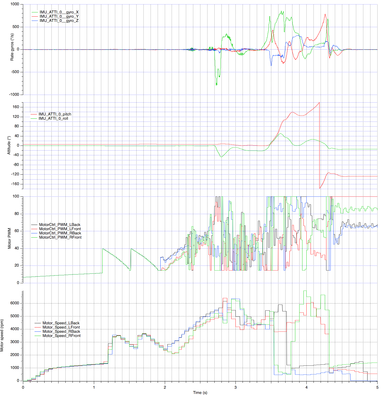

Whichever it is, it must be an intermittent issue with one or the other and those are almost impossible to isolate with data alone. @sar104 any input on this one from FLY249?
Well for starters the motor control signals look very strange - they are all over the place. The motors look okay. The rate gyros are correctly detecting the aircraft attitude change.

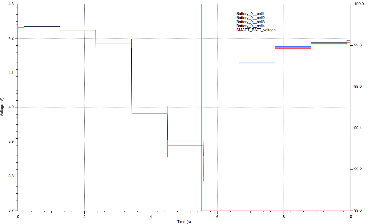

The cell voltages also drop rather precipitously on takeoff, but whether that's enough to cause the problem I don't know.

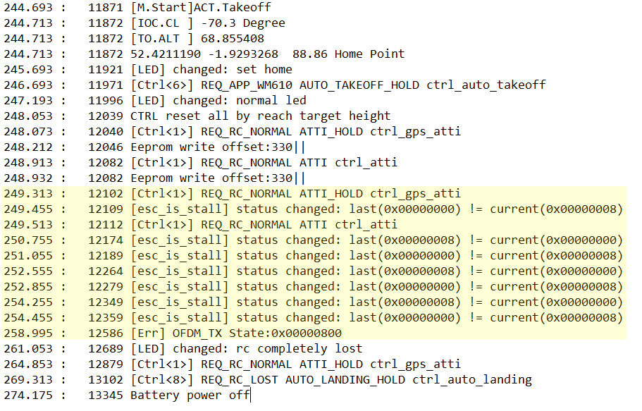

@Chickabump Going by the event log along with the data as it is. I would suggest an ESC issue as opposed to a motor.
