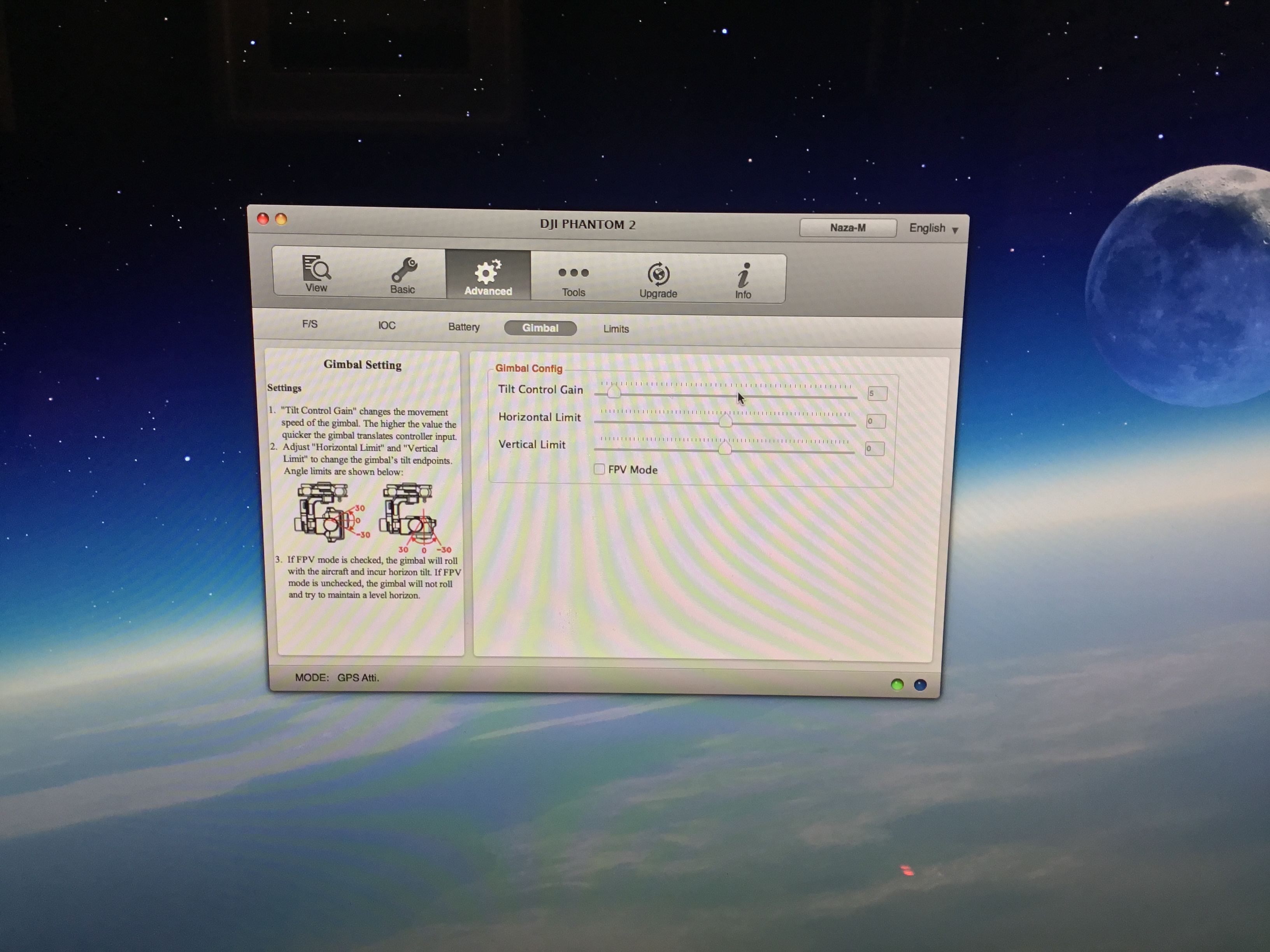

So it does work but not as smooth. Connect the P2 software and send a screenshot of the gimbal configuration to see how it is set up. The controller has to be on when you do this.

oh Dear.... how do I put this? Just now I have calibrated the remote in RC system software and now the gimbal is working like a great. I am very very sorry for wasting all your precious time but I still appreciate the support!!!!
