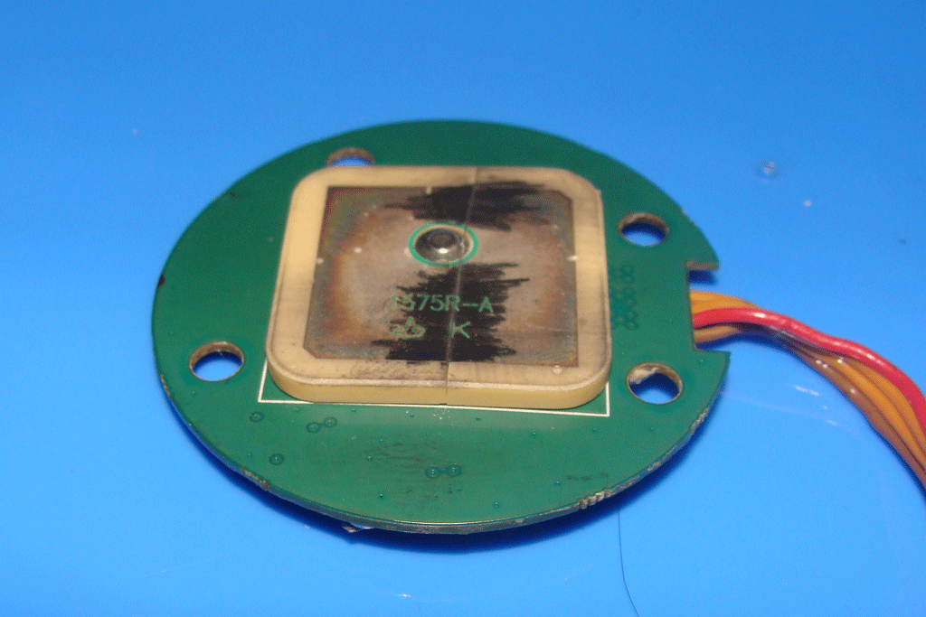

Hi people,
Congratulatios for the excellent work helping a lot of people with info.
I have some months ago had my PV2+ falling from near 30 feet high and as resolt the bird had lost almost all sats.
Taking a closer look at its GPS i found that the antenna craked almos mear its half.
As i do not liked to stay withot flying the bird, i tought how i would workaround this....
After several ideas... came on mind to fulfill tha crank wit graffitte from a simple pencil, letting in this way the antenna area working again with the same area...
It worked fine ...again 10/ 12sats all the time, without failures.
I did not researched enoug and bought an 25x25x4 ceramic antenna.... but in delivered i noticed that the original one is 25x25x2 mm ... so there is no room to put the 25x25x4 mm it in PV2+
Can someone inform if there is a wat to workaround this ?
Thanks in advance : Juan

If I recall correctly, you need to trim off any plastic fins in the top shell that are in the way so it will fit.
Oops.. I see RoyVa already mentioned that.
MapMaker53
Ok, tks
Searching for info regarding 4mm antenna i found someone that modifyied the upper shell with a Dremel tool..... to fit a 4mm antenna.
Excellent idea ! I will try it in few days... I do not have a Dremel at hand now....
Best regards and tks a lot. Juan

It will fit with a little maneuvering or as others have done a small amount of trimming on the plastic in the cover.
you can use a simple knife or even needle nose pliers. I did not cut anything on my 2 phantoms .
You did well with the 4mm antenna , it has a somewhat higher gain so you will most likely pick up more sat or at least lock GPS faster
good luck and have fun flying!
