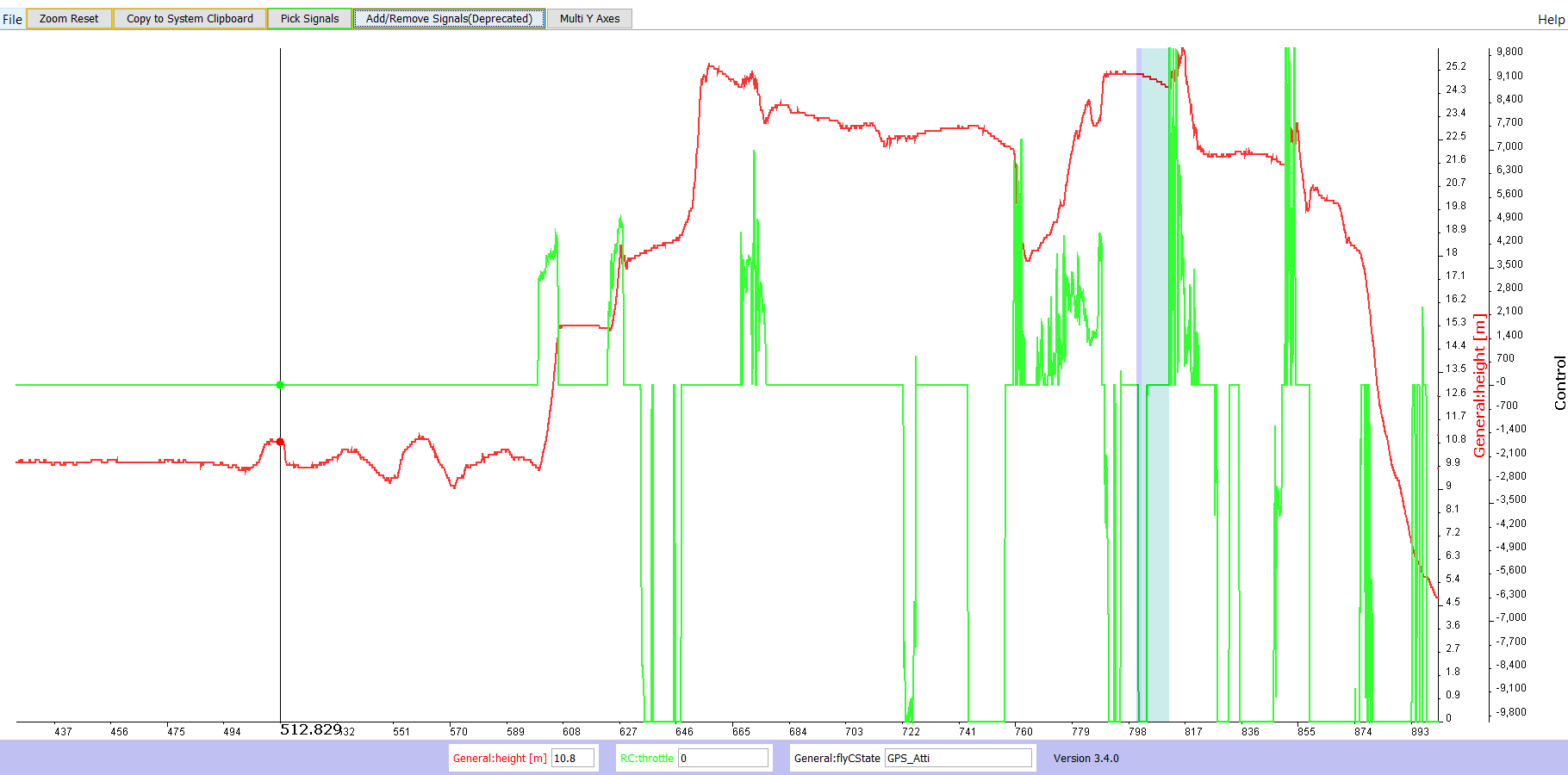

Looking at your data, it appears to be your throttle is sticking. By sticking I mean like something interfering with the movements internally to the RC, or possibly an RC cal could help. I have seen this happen before, but only once and the throttle stuck full up.

Thank you. Sounds like you are talking about the component that digitizes the analog stick movement for the "throttle". Appreciate the input. You mentioned you had seen this in only one other instance. Can you tell me if the RC Cal I assume was done eliminated the problem completely?. Guess what I am looking at is: what are my options. To me if the data (I only knew how to see the flight track and spreadsheet of altitude speed, etc) shows the throttle signal as increasing during the climb, even though I had the stick in the down position, then I need to send the unit back. As I think I said, this was my first flight of a brand new and newly activated unit. (Sorry, but I cannot read the legend on the chart. but I am looking forward to understanding how to view this data to solve future problems)

If you look at the graph above, in red is your altitude in meters.In green are your RC inputs to the aircraft. The center line for the throttle is zero input. As the green line goes up, you are increasing throttle, down is decreasing. It appears at times it followed your inputs. Other times are "choppy" but it is sometimes hard to tell if these are actual very quick inputs of short duration, or simply "Noise" from the sticks as they are moved one way or the other. And yes, the logs provide very useful data. The aircraft itself also has a data "black box" for lack of another term that has even more data than the device logs provide. And no on the other question with the full throttle stick. The aircraft was lost due to that.

OK, so at 646 I see the throttle is at zero deflection and the altitude increases sharply... This would clearly be an ucommanded climb. Also, not sure what the blue vertical column at about 800 seconds is. think it may correspond to my RTH initiation...

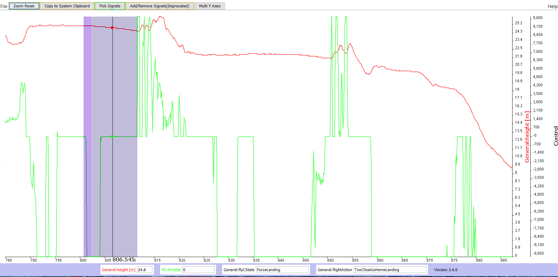

Correct, that is the Go Home reference. However, you were too close to the home point so auto land initiated. Below is a better zoomed in view of the last 100 seconds.
