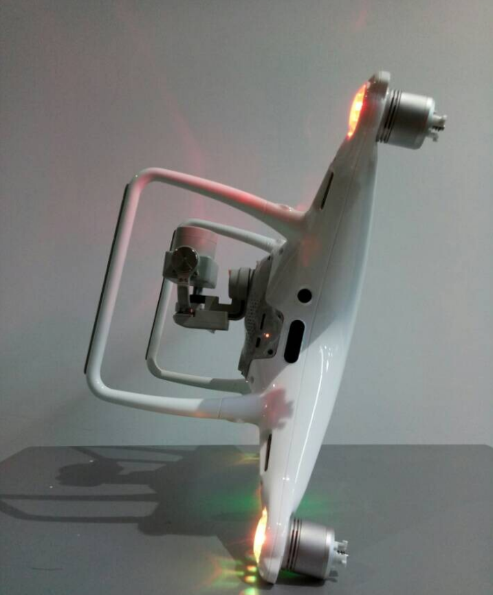

I know there has been a lot of talk around here about the common yaw drift problem with these units. I own 2 P4P v2 drones, updated the firmware end of last year, and both have the same issue. But not before that update! (typical DJI, thank you). Even after reading the numerous threads here about this, none provided a real solution. I went through all the calibrations, but will do it again if I knew which calibration was responsible for it. Perhaps the stick centering position (neutral) can be fine tuned? Often I try to compensate with small movements of the stick, but it quickly resumes the movement. I've seen no current discussion, so I assume everyone found a fix or just learned to live with it. As a photographer, I really need my unit to be still, especially for bracketing and making panoramas. Thanks for any help.

Have you looked at your gimbal settings? I have definitely had the yaw problem before, but once I was able to stabilize the compass and IMU, I still noticed it... but then on further investigation I found that the gimbal was slow to react and would give the sensation that the drone was yawing. Might be worth a look.

Thanks Chris. Interestingly, that's what DJI just told me to do. I need to set the craft on it's side and run the gimbal calibration routine. Will report in after that is done.

Today I followed DJI's suggestion of calibrating the gimbal by placing the drone in this position and running the auto calibrate routine. I followed that with a controller calibration (moving the sticks around a few times and rolling the left gimbal wheel a few times). Todays flight was much improved, but I need another flight to specifically watch for the drift more closely. Still, it was way better.

So position it with camera facing UP?
After doing the Gimbal calibration on its side, did you then do another calibration in normal position?? Or left it as it was after the side calibration?
Also- when then doing the controller calibration, was the bird put back into normal position?
Yes, like the picture that DJI sent me. The stick calibration is only done in the controller so the drone has nothing to do with it.

Thanks, but to clarify, after doing the gimbal calibration with drone facing up - like photo- did you do another gimbal calibration with it in normal - landing gear down - position?
Or was the facing up calibration alone good enough?
