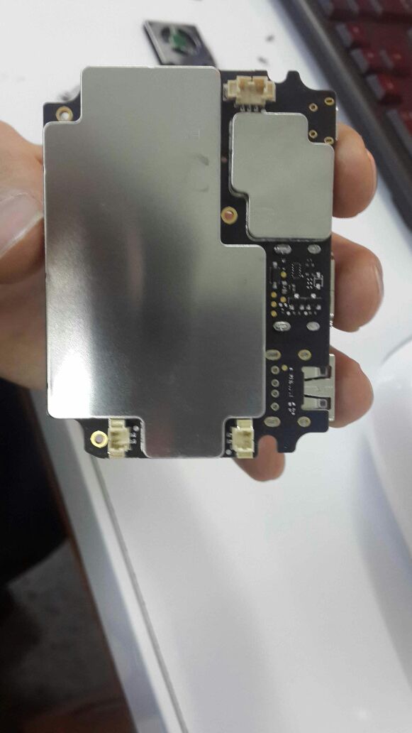

Hello Alper Suslu, I see that you have a lot of knowledge with the GL300e remote control, I would like you to help me I have the following problem ... restore the remote control and now when I want to activate it, it does not detect any wifi signal ... I attached the link or jpg to the problem for that you know the problem ... I see that here you explain how to do a reset with the adb could you please explain me better and where can I get the adb thanks

I miss Mr. Alper Suslu for his effort on doing Custom ROM for DJI P4P+ ... i am a liitle bit depressed with all the method
Not this procedure this is nothing I rooted p4p+ controller (gl300e) and changed something that is disabled DJI apps.
Then when I am changing something for prepare custom rom. It's gone. Not boot again.
I mean installing apps with adb is nothing. It won't brick your tablet.
