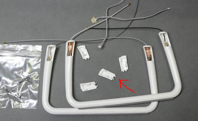

Anyone know what these are called or where to find replacements?
DJI does not sell that part separately. It comes with the landing gear.
