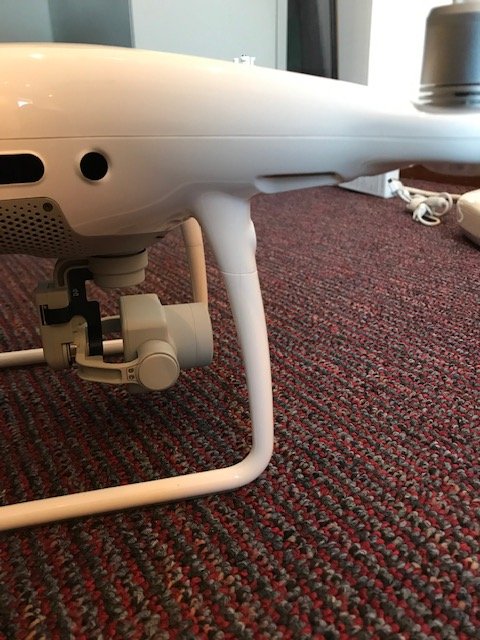

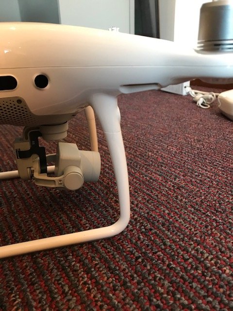

Hi Everyone,
I could use a little help.
I recently purchased a pre-owned pahntom 4 pro +.
the bird is flawless, except 1 problem.
I notice when the unit initializes, the camera is perfect dead on the horizon. after about 5 seconds, it drifts down a bit. no matter what i do this happens. indoors, outdoors, calibrate compass and IMU (as some suggested on youtube). im at a loss. the camera is facing perfectly straight, and not canted to the left or right. it is strictly the horizon drift down.
Im at a loss.
the 1st photo is after start up. the 2nd is after about 5 seconds after initialization
Thanks for any info.

when it turns on and initializes, the camera aims up (as normal), then aims down, but goes past the normal 180 degree mark, then returns to normal even horizon mark. after a few seconds, the camera shifts quickly to the left, then droops down, returns to the center while still drooped down, and comes back up "slightly", but no where near where it should be.
Here are videos. I have no idea what to look for. Has anyone seen this before?
