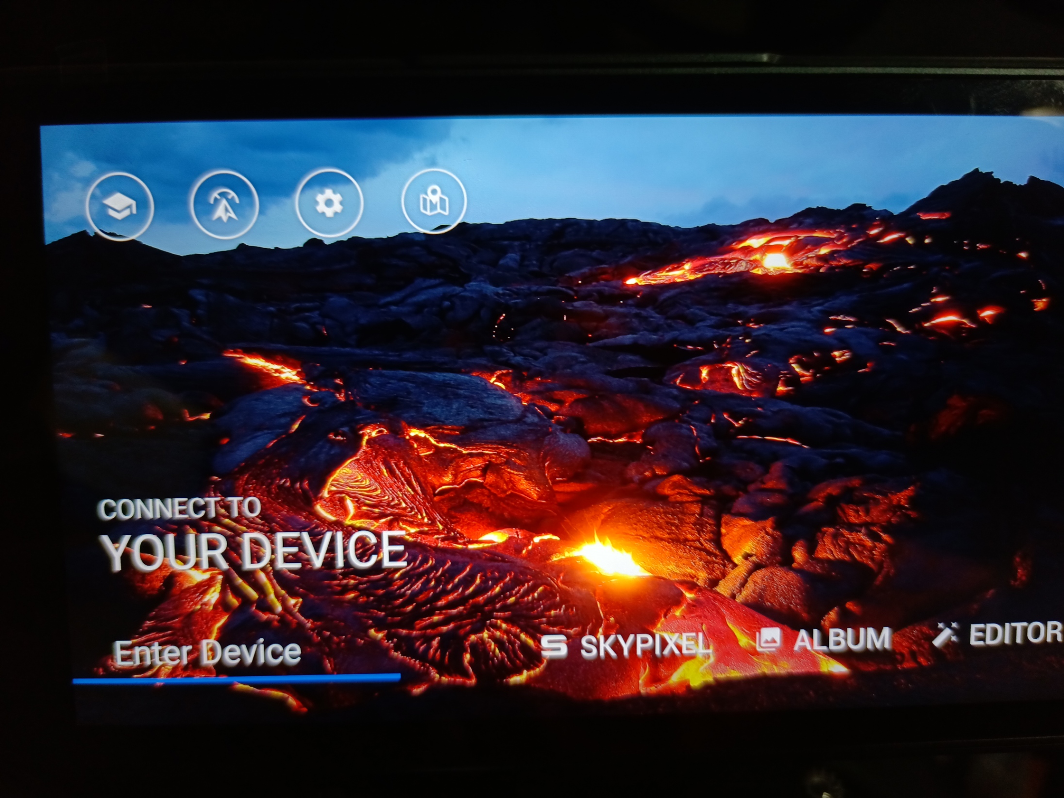

I still not able to download the offline maps. My map box is blank. I have the off line map icon on my home screen but nothing happens when I click it.

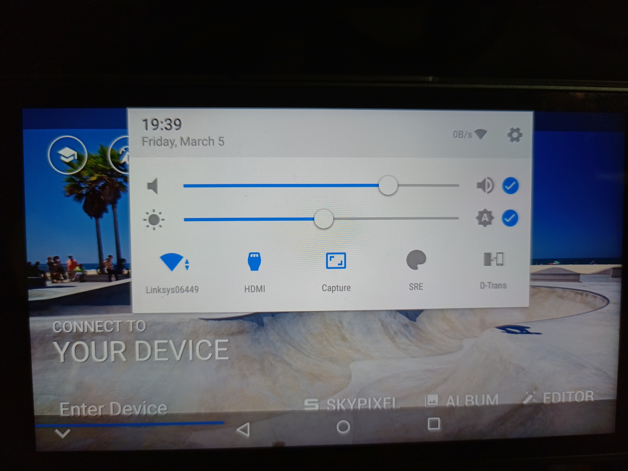

Did you pull down your screen (finger from top) and turn on internet connection? Also turn on 'cache maps' in gen settings. All I can think of.
Is your wifi config signed into your home wifi. It might have lost the wifi connection with all of the changes

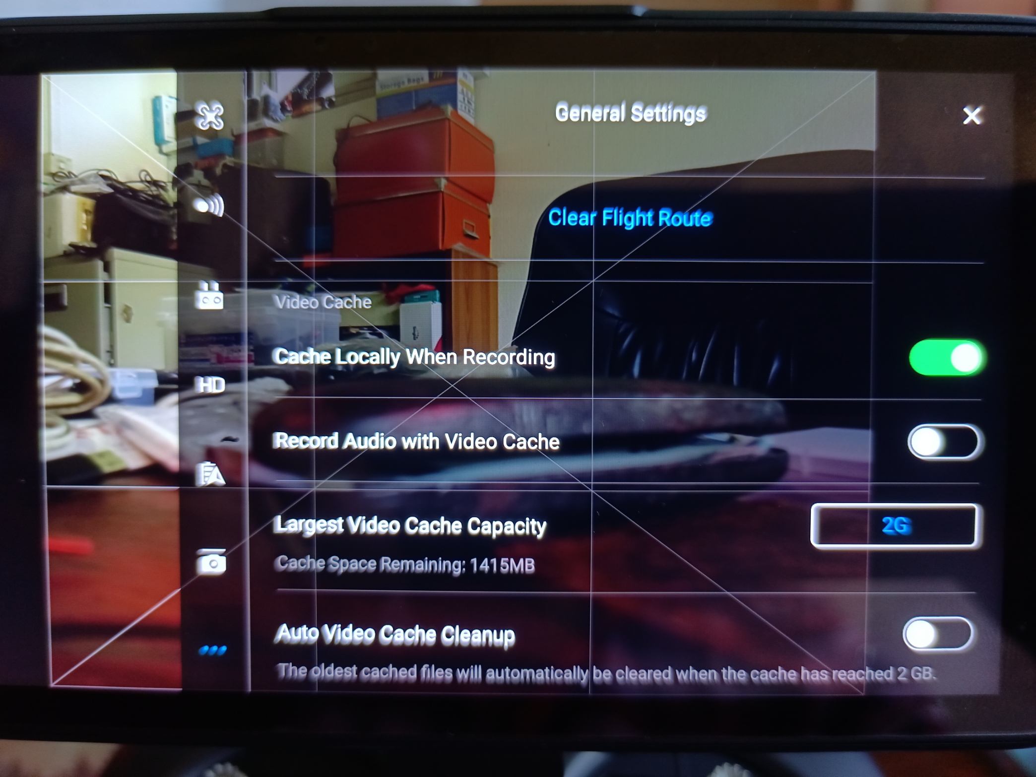

I did have the internet connection. In the general setting I do not have cache maps option. I have is Cache locally when recording. This is switched ON.
