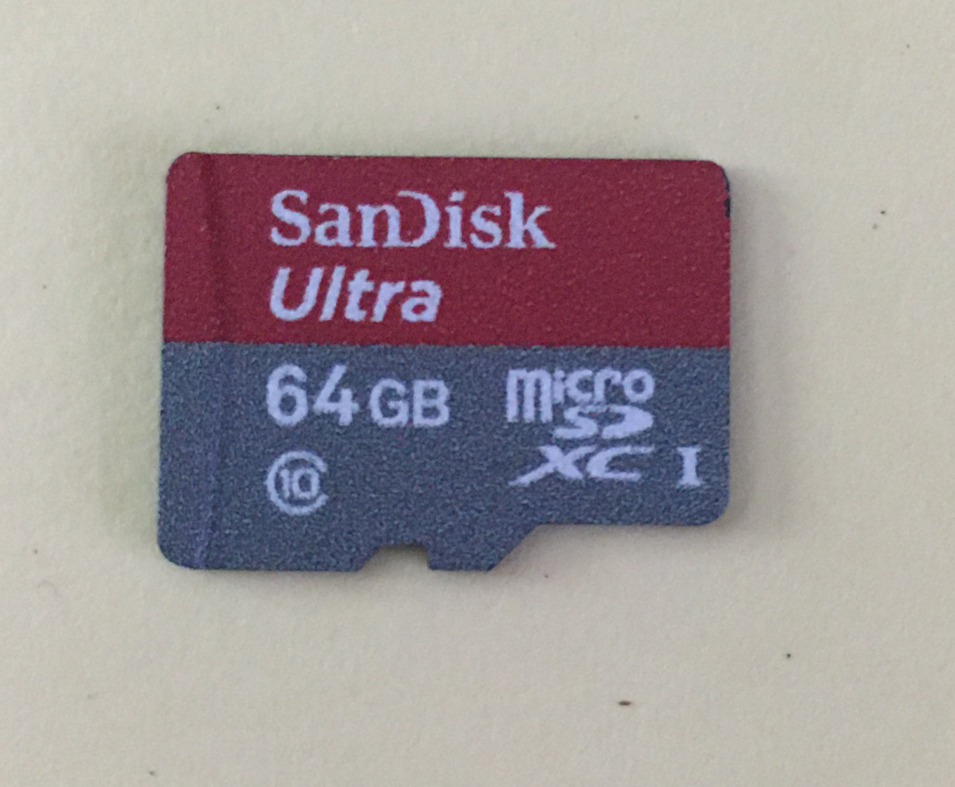

I don't think it is the SD card since they work fine in my backup drone (also a P4P). I am using the SanDisk Ultra 64gb (see picture)
