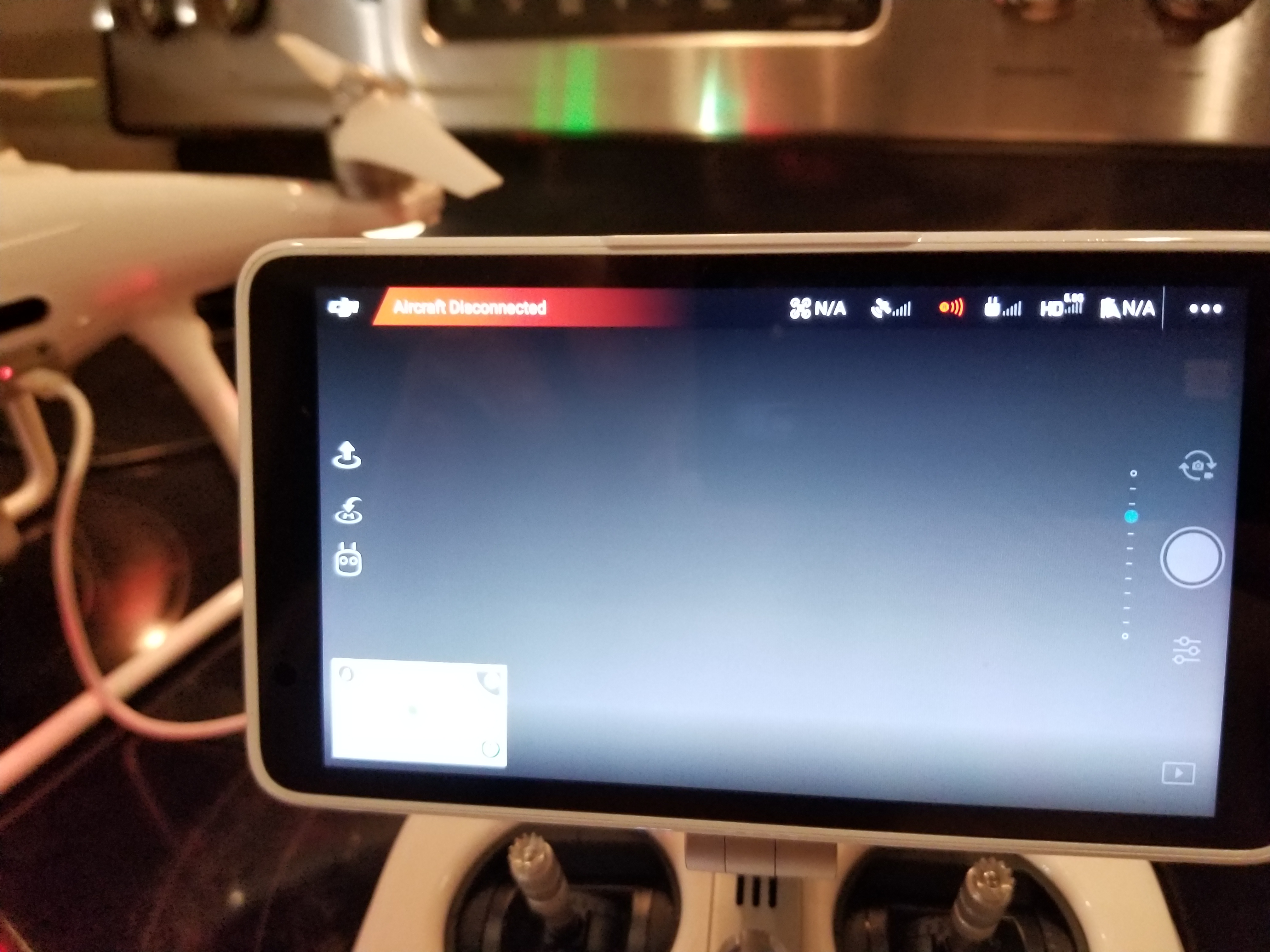

just got it back and i cant get it to communucate ...controller/aircraft. now i did upgrade my controller. and then turned on with aircraft. got a aircraft disconnected on my screen,,,, then looked on screen in settings and it said aircraft had latest firmware.....i love my drone but ****....turn them both off....connected the controller to the aircraft....got indication that they both had currect firmware....just not communicating...please help
Reactions: DHAirbus
I have plus so no screen shot but here is pic

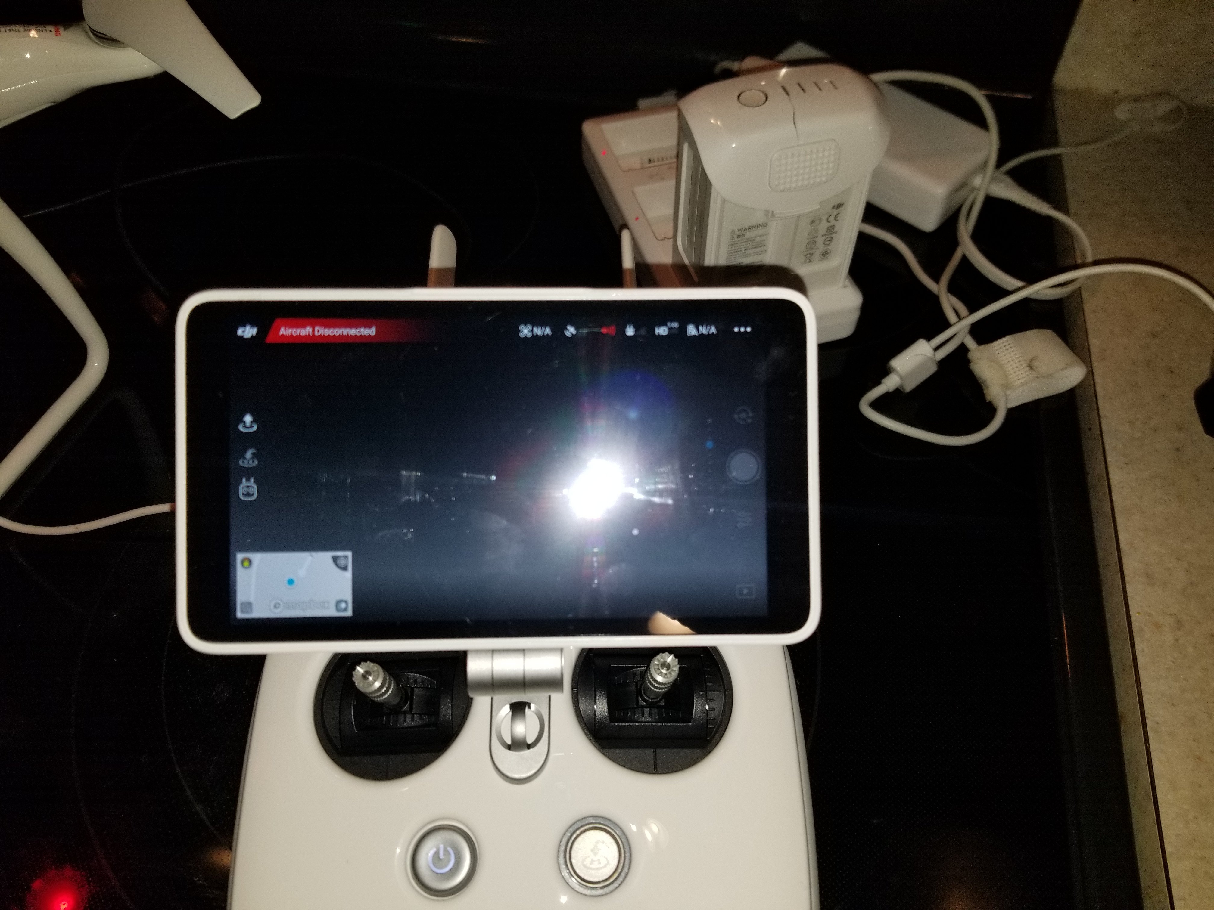

Here is another try

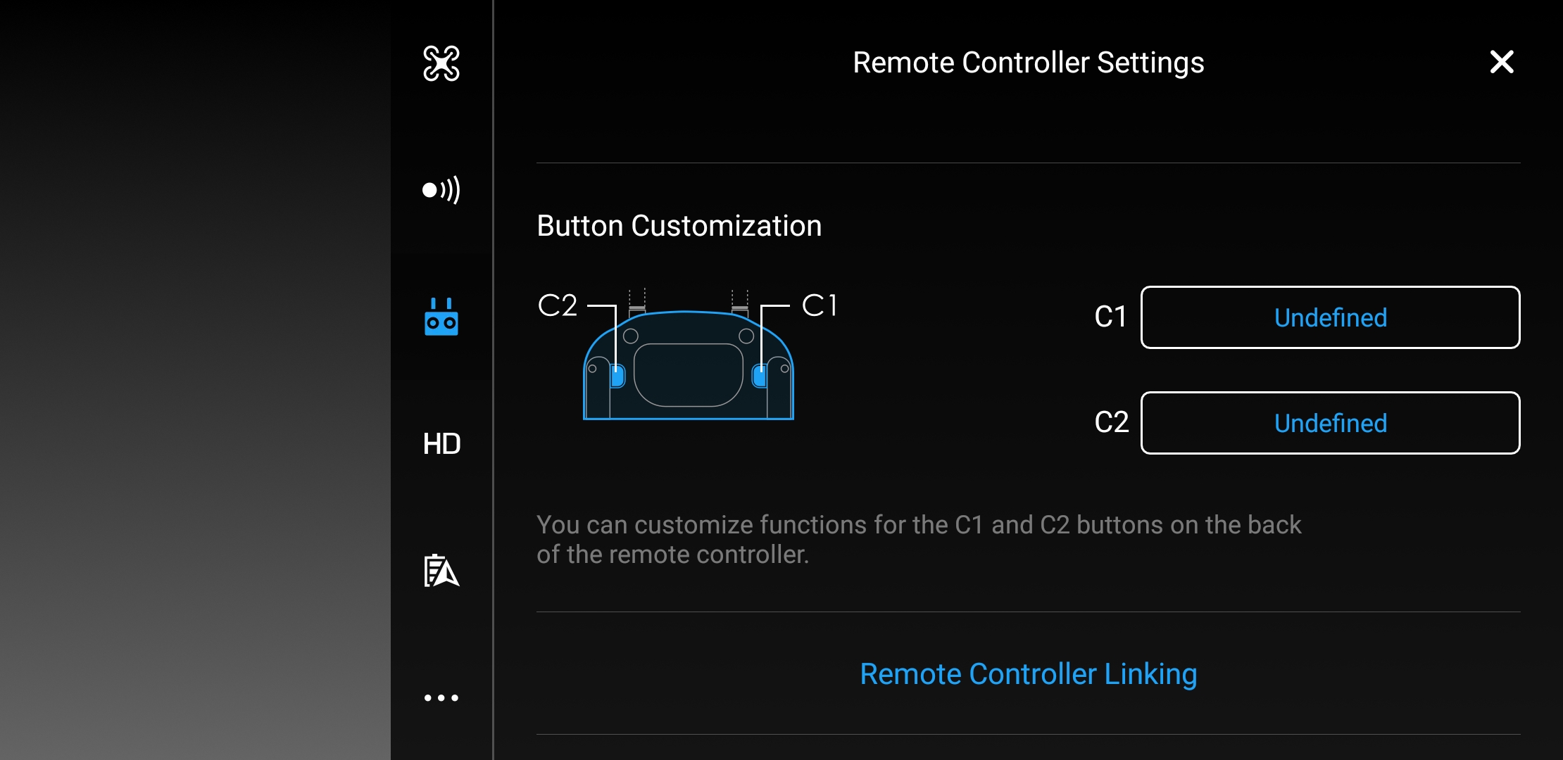

You probably just need to link the RC with the aircraft. There is a pin hole close to the sd card slot on the aircraft. Use a pen to press it. Then go in that app in the controller menu to link it (see attached screenshot).
If you sent it in without the RC, they would have had to link it to another to test it.
Re-linking will be the answer.
