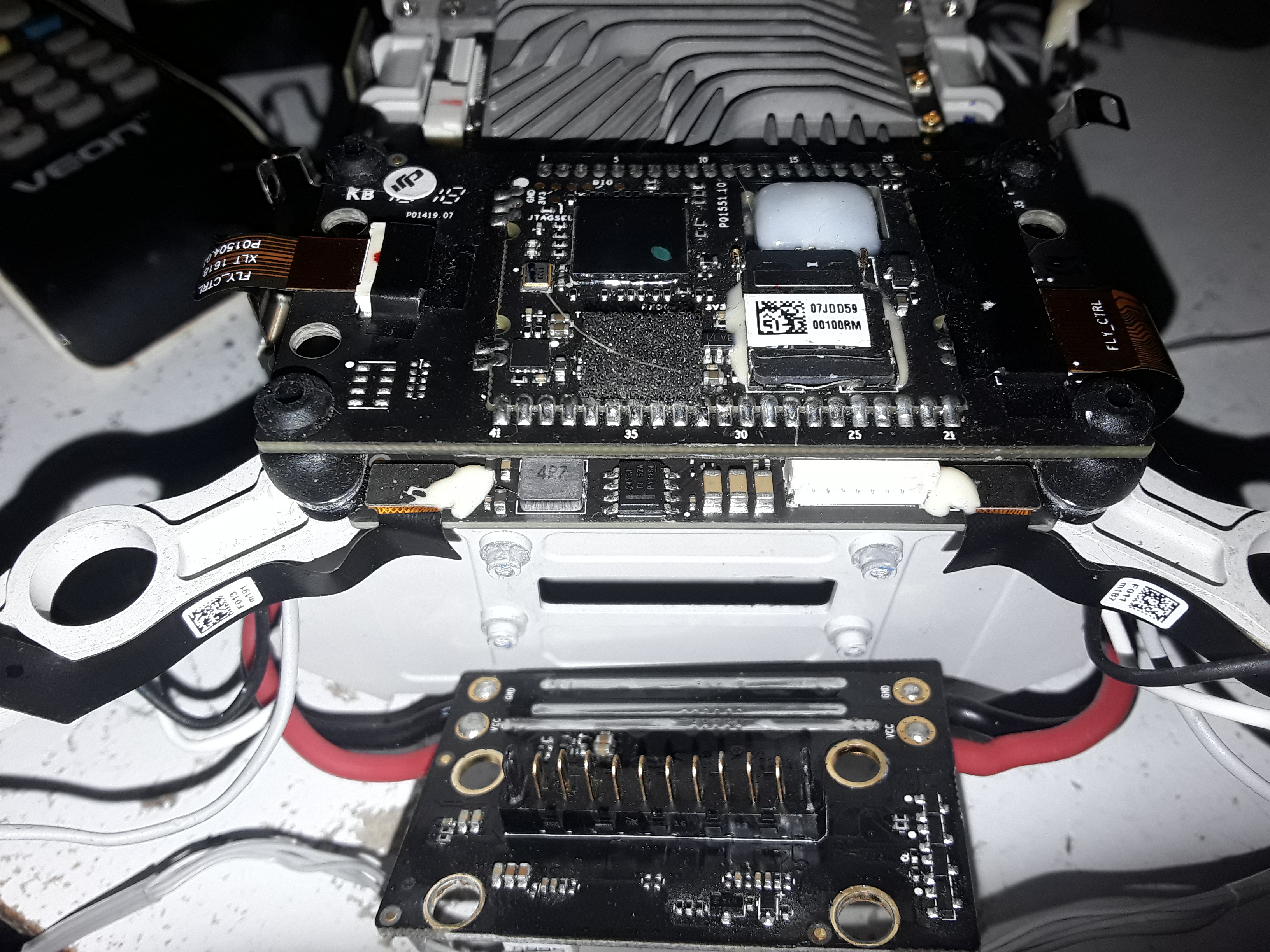

R the ribbon cables ok they can tear on impacts,,I'm not sure if torn or not because I think it should still power up but you will have error,,,,got multimeter and check what voltage battery is at,,you might need to open again and trace back,,something shutting your power down,bad contacts mayby,I it really clicked in when its clicked in,

I have the power board off just like you have in the pic. When I get home I will clean contacts with small wire brush and plug the battery back in and try it out again.

I just tried cleaning the terminals on the power board and battery,and nothing.

I have now replaced all the ribbon cables with new ones, and nothing. Should I now try replacing the power interface board?

This sounds like you have a short to ground somewhere near the main power distribution board on the main (vbat) line. The battery is detecting a massive amp draw and shutting down to prevent damage.
Check for short to ground starting with the main power distribution board. Once it’s confirmed to have a short, troubleshooting is easy, disconnect one component at a time (start with esc’s) until the short clears.

Thank you, the short cleared when I disconnected the left side esc. So now I disconnected the front motor , should the motor run if I connect it to a battery? I have the motor off and it won’t run when I connect it to a 9 volt battery.

No that motor needs an electronic speed controller (esc) which has special timing parameters and programming to spin the motor. That esc is actually both esc’s for the left side. (There are 2 individual esc’s in that board)
You will need to replace that esc board, extras can be found on eBay or amazon, usually pretty cheap. This should fix your issues.

Well thanks for all your help. I have purchased a new left esc board and installed it today. Yeah the phantom actually starts and connects to the remote. , BUT now I get the dreaded esc 1 and esc 2 error and won’t allow to run. WTH.

I would double check your ribbon cables going from the ESC to the main controller (the board that’s suspended over the 3in1 board via rubber dampeners).
When you power it up do the motors on both sides initiate properly (do the beep?)
