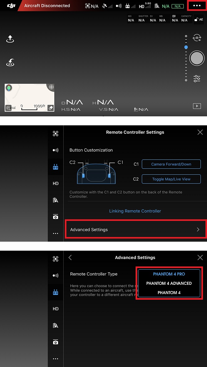

Both of those remote controllers will connect to the P4 (Standard) after you choose "Phantom 4" as the "Remote Controller Type" (see below) and restart the remote controller.

How come I do not see the advanced settings below the "link remote" on my GL300C while trying to link it to my p4 advanced coming from a p4 standard?!?
That setting is only available on the GL300F or the GL300E.
