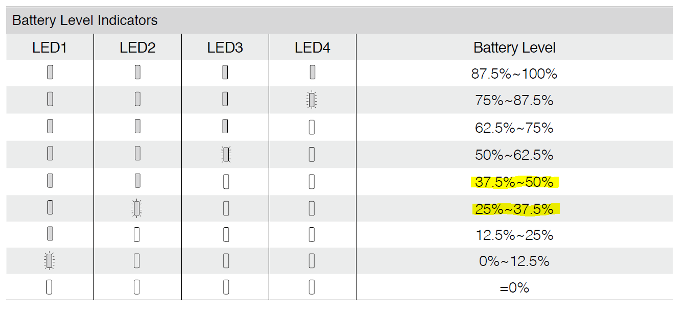

Personally, necessary or not, I check mine every 2 weeks for proper storage percentage. I maintain mine with the range shown below one step higher would be ok, but not lower.
