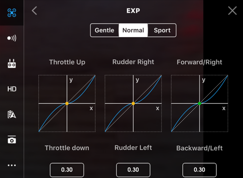

I finally had a chance to fly yesterday afternoon after updating everything last week. The updates went very smoothly for me. I updated the copter using Assistant 2, and I updated the remote using GO4 with my iPad Air 2 on WiFi. I then performed IMU, gimbal, and VPS (via Assistant 2) calibrations. I probably didn't need to re-link the remote and copter, but I did this as well.

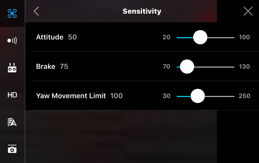

Poking around in GO4, I noticed that my Sensitivity Setting had all changed as a result of doing this update, so I reset them as shown below:
I set EXP of .30 for Gentle, Normal, and Sports modes.
Of these three values, Brake Sensitivity is the one that could get you into trouble. I found 75 to be perfect and gentle seeming for the sake of the motors and airframe, but it is muted, and you have to be very careful and aware when approaching an obstacle like a tree branch which Obstacle Avoidance may not see. Once you get used to it though, it works quite well.

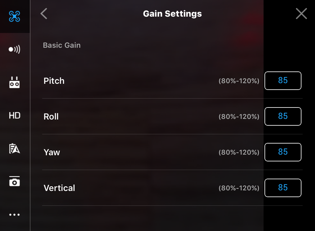

As I understand it, the Gain settings dictate how the copter will react - on its own - to environmental factors (such as wind and air pressure variables primarily) in order to maintain its stability while flying. Having these set at their maximum or even default values may be one reason that some folks are seeing and hearing the autonomous twitching in flight after this update. I found 85% to be very smooth and steady across the board.

You set exp the same for all 3 modes? You realise they are suppose to all be differnet?
I did. I rarely use Sport Mode, and when I do, it is only the added speed that I care about. An example would be to fly out to an offshore island approximately 1 mile away at 30 MPH where I want to do a bit of seal watching. Once I get there, I go back into 'P' Mode while on site - and maybe Tripod Mode now. This seems to give me the most time on site, and then it's back into Sport Mode returning home. It's all personal preference on the EXP settings really, and regardless of what you set, full stick deflection in any direction still gets everybody the same thing. It is just a matter of how quickly any change happens as you advance the stick(s), and I tend to be very gradual and slow with my stick inputs for the most part, so these settings seem to compliment that.

I changed all the settings in my second battery several days ago, when I realized the nervous behaviour of the bird in the first flight after the update, trying to make the flight softer. It didn't fix the issue. Even more, the braking distance was the same with brake sensitivity at 100 as brake sensitivity at 70, as if you hadn't changed anything.
EXP=EXPonential. Gives smaller response for same stick position around neutral. Then differential vs flat curve get progressively recovered up to max position.

Tried your settings really thought you was onto something there, but my drone still acts like a nervous horse.
I really feal uncomfortable flying it now since the update, previous to taking the firmware my drone performed perfectly.
