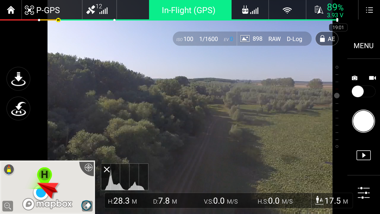

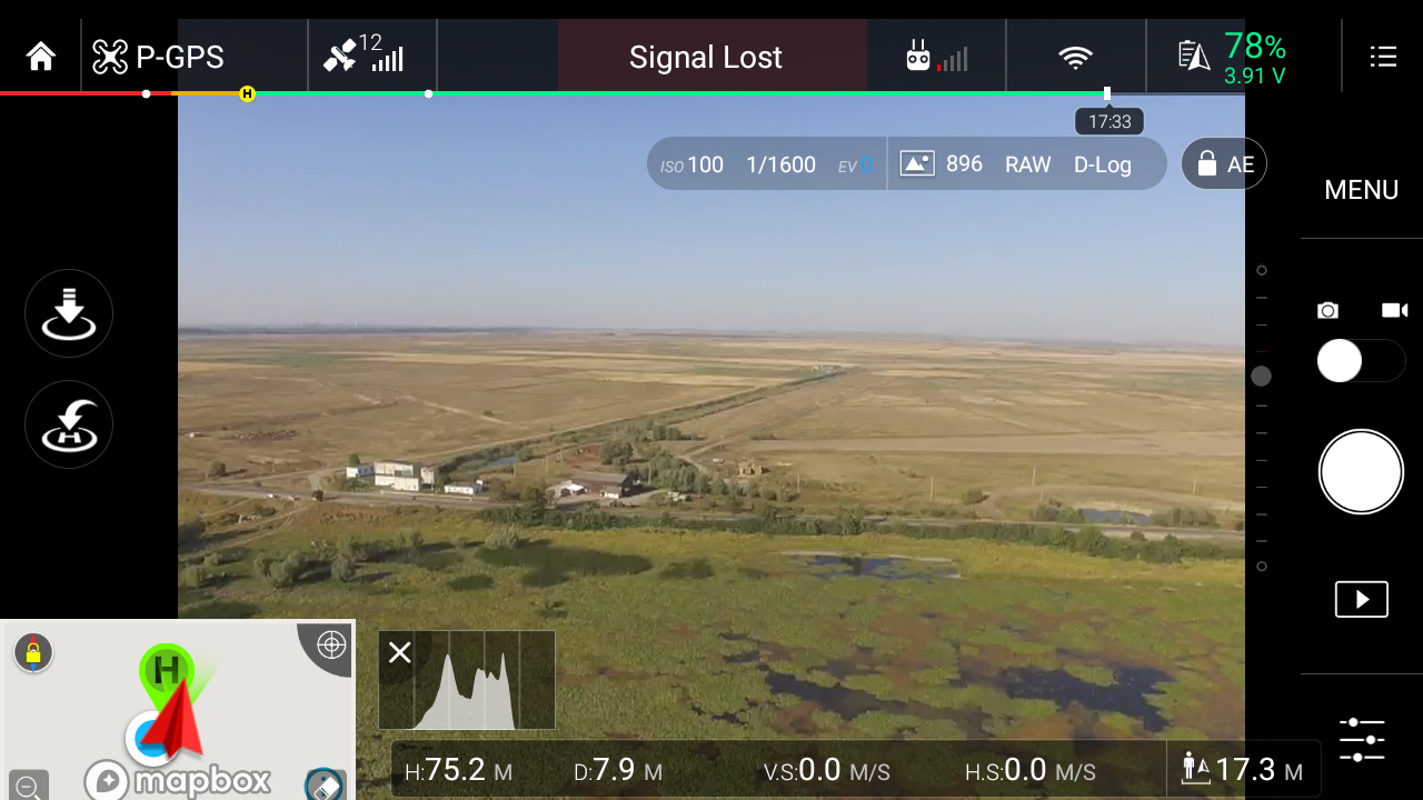

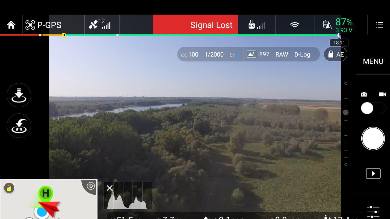

I have some trouble with signal lost

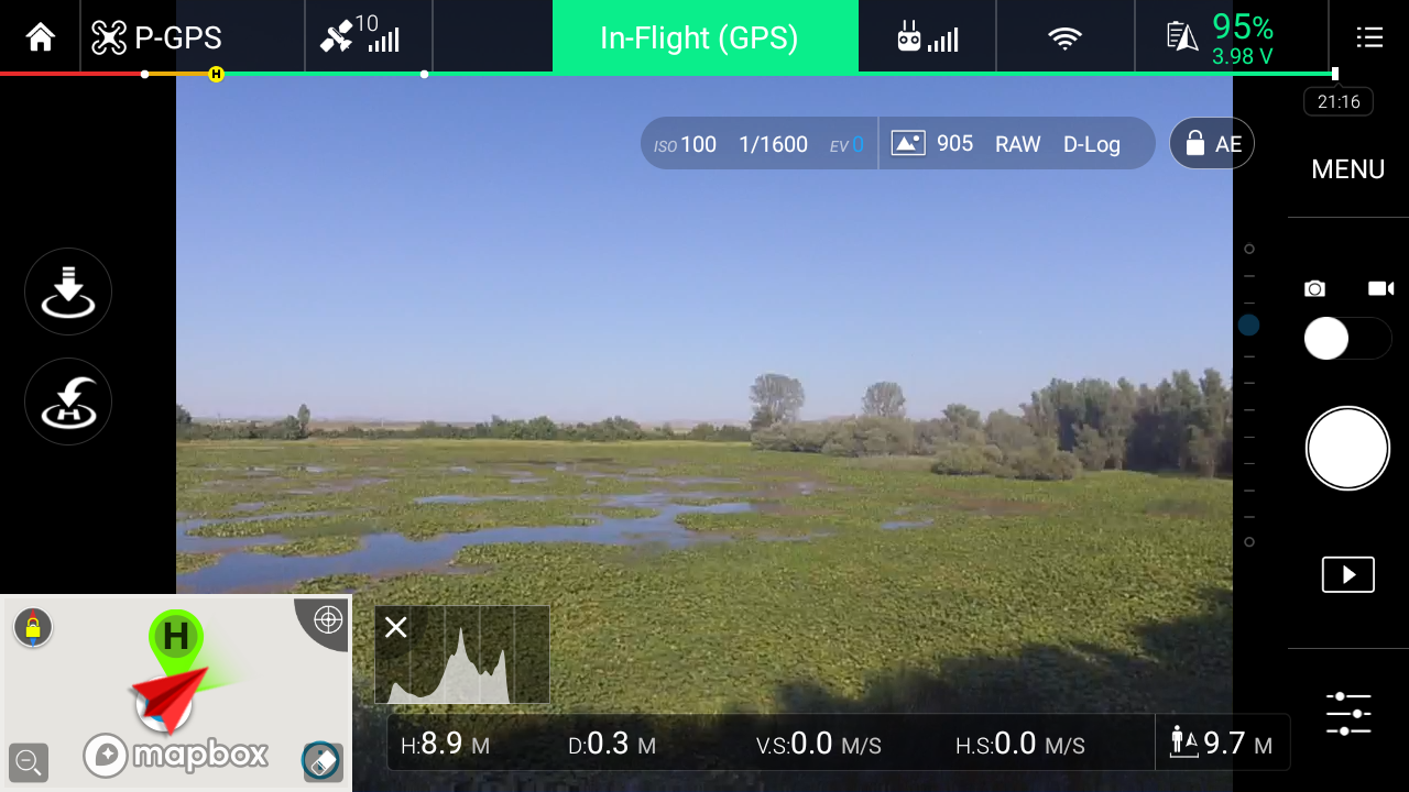

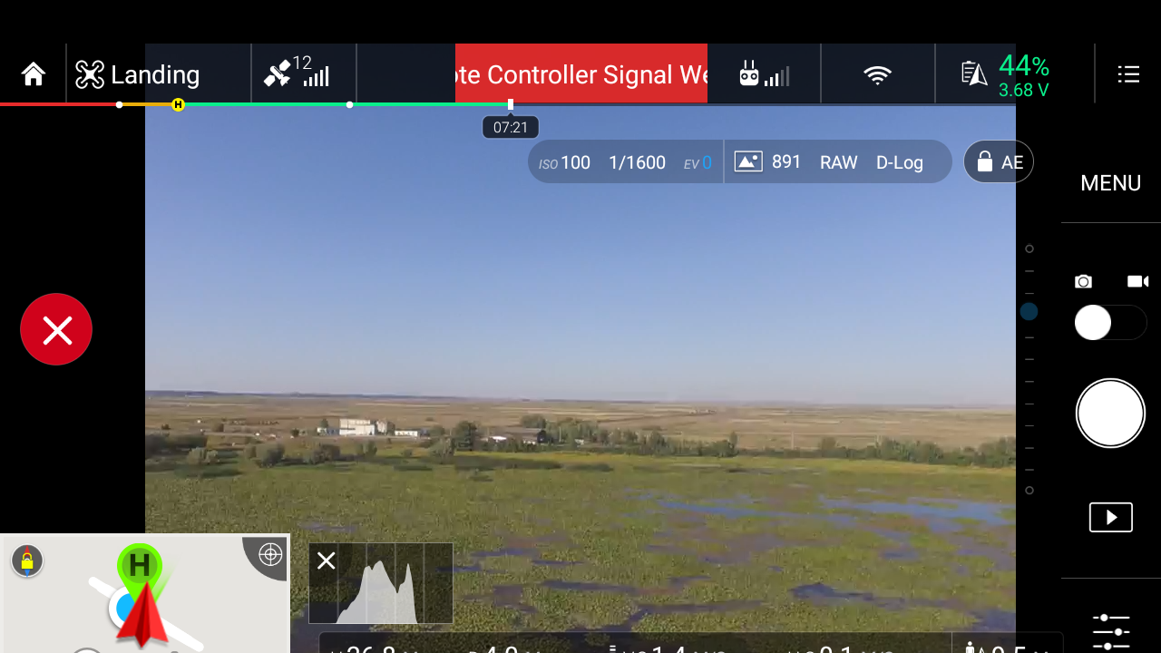

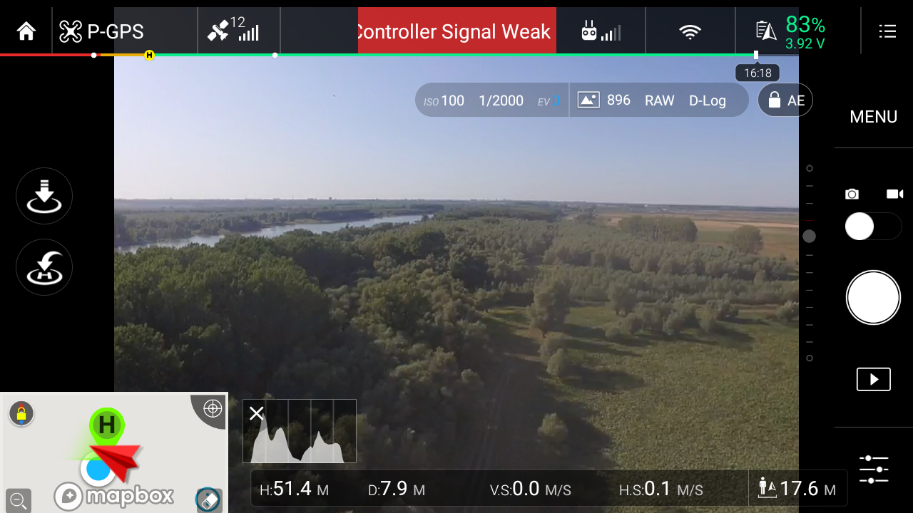

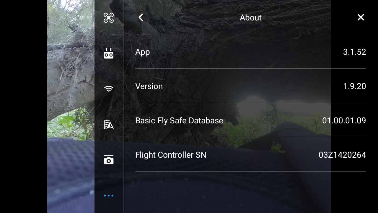

Attached some pictures. Sign in/out didn't resolve anything.

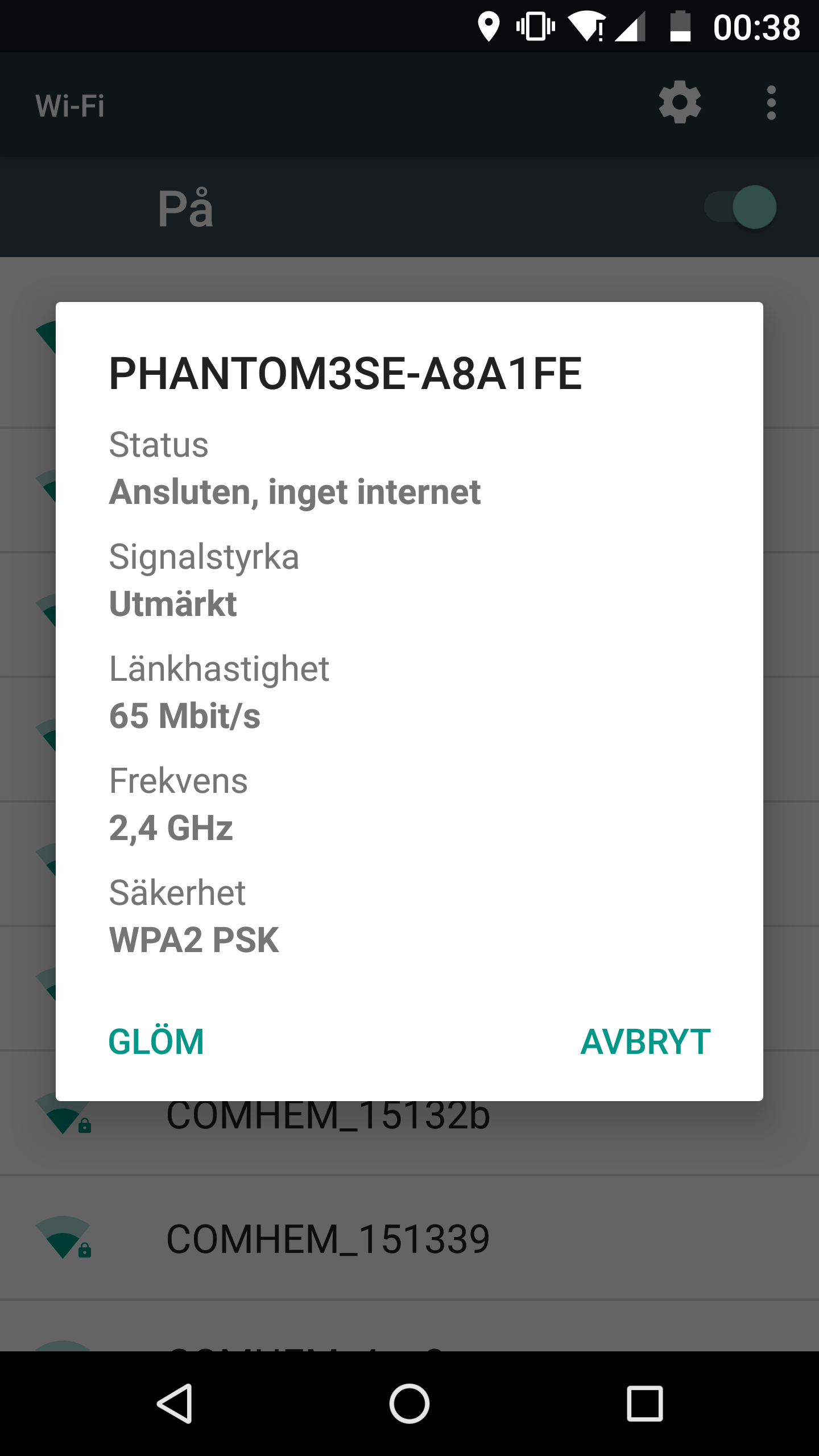

I got now a RC from p3se to a P3s drone and telephone conect but impossible to link drone to RC started link but not successful.
try the default password 12341234 if your phone has show the message NO INTERNET ACCESS and warning to stay or not to stay connect hit yes
For relink drone with RC fallow the procedure described in DJI Tutorials
I have recognised that i have Antenna for Television ,Radio FM and 4G internet in A distances at 500 m to 1500 m from both of places I fly at and should test now from longer distance.
One time it came warnings message of magnetic interference is it because of to near this antenna.
But most test fly no mes.. and weak signal comes and end lost signal.
Contact with DJI support recommend re-link,compass calibration,and IME cal.. as a std answer even if not app says it need it.
Is IME for magnetic interference.

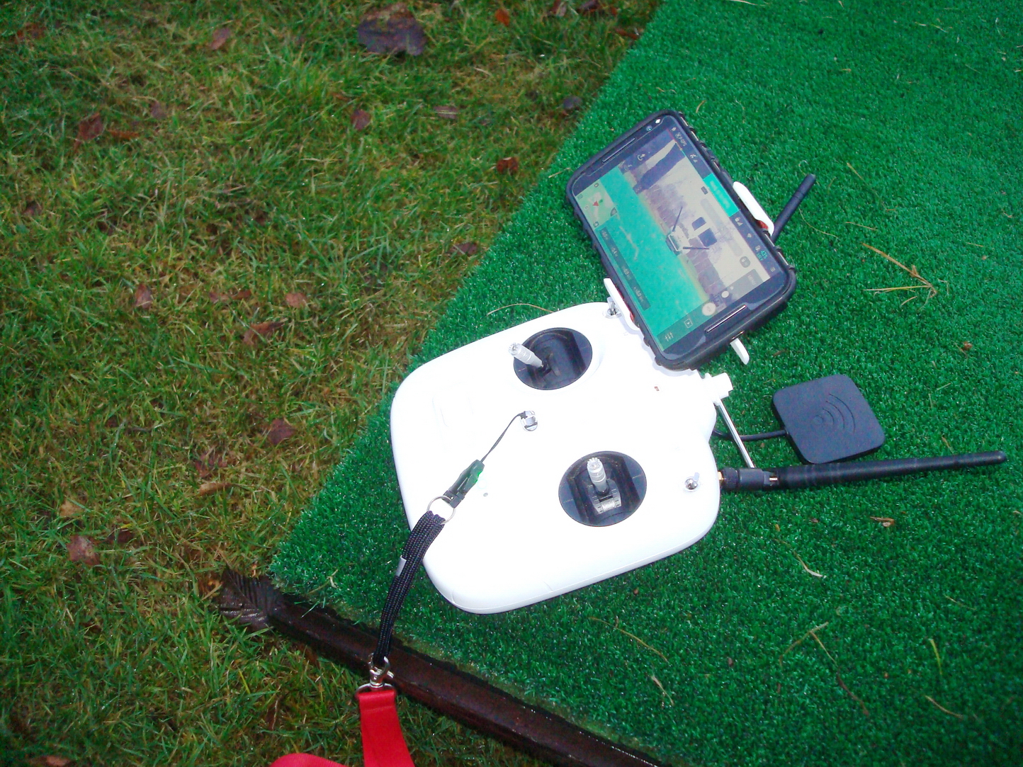

I have no bay 14 dbi 5,8Ghz antenna and 6 dbi for 2.4 Ghz original is it only 2,0 and 2,5 dbi and it looks good indoors and should now test fly with it and longer from big Antenna
IS drone /RC antenna ok until it is dead and be not slowly weaker before total broken to not function if it dont get any violence or broken cabel
I think my original RC antenna has cable damage in isolation and it get small shorter or longer band with so it be 5.7 or 5.9 Ghz and bee a little weaker signal it most bee A conmen problem because of bending antenna I have set A short bit of shrink tube on it but it could be broken isolation of shield.
I some one have Idea of my proposal and ask PEASE ANSWER

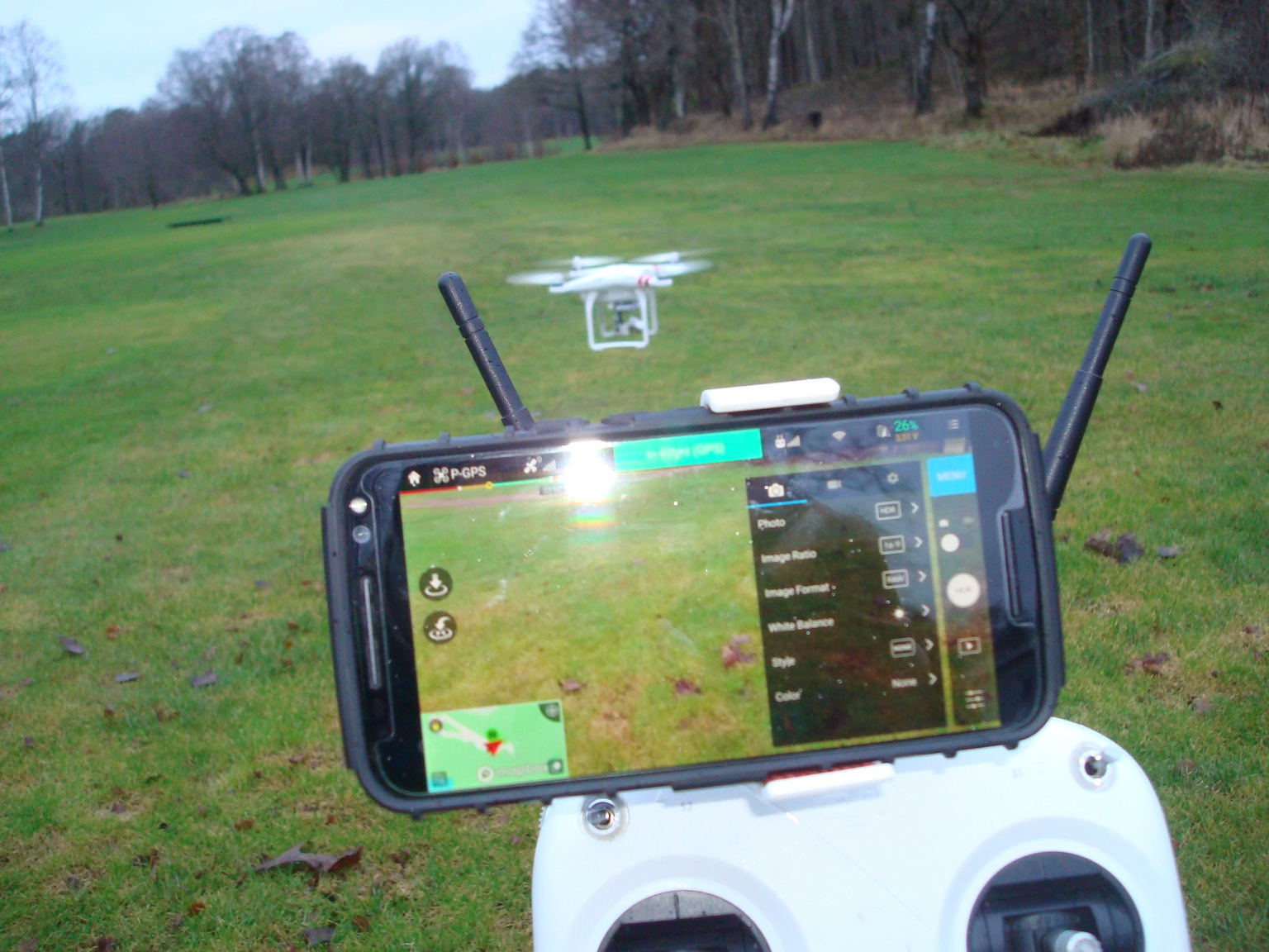

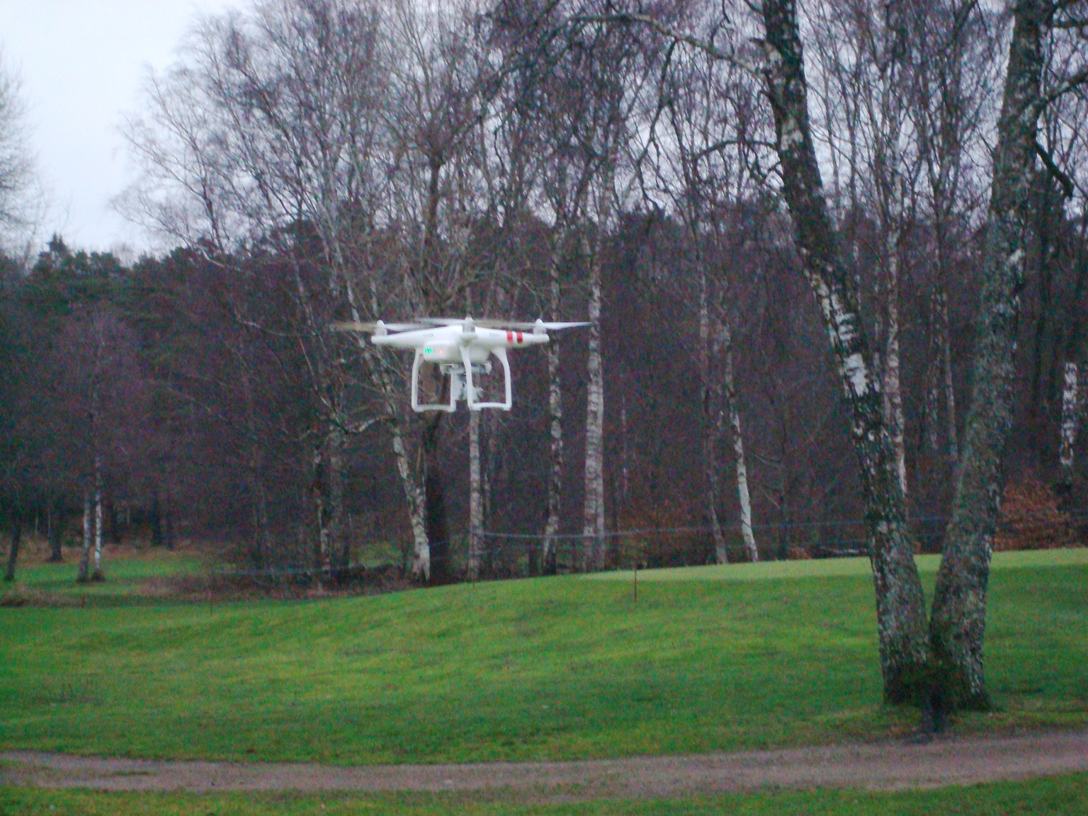

Set new 2.4 ghz antenna and 5.8 Ghz
Not test max distance because off trees on fields and longer distance from Large public Antenna and other wi-fi
Now test At ca 1 km from house and Antenna earlier 3-500 m.
