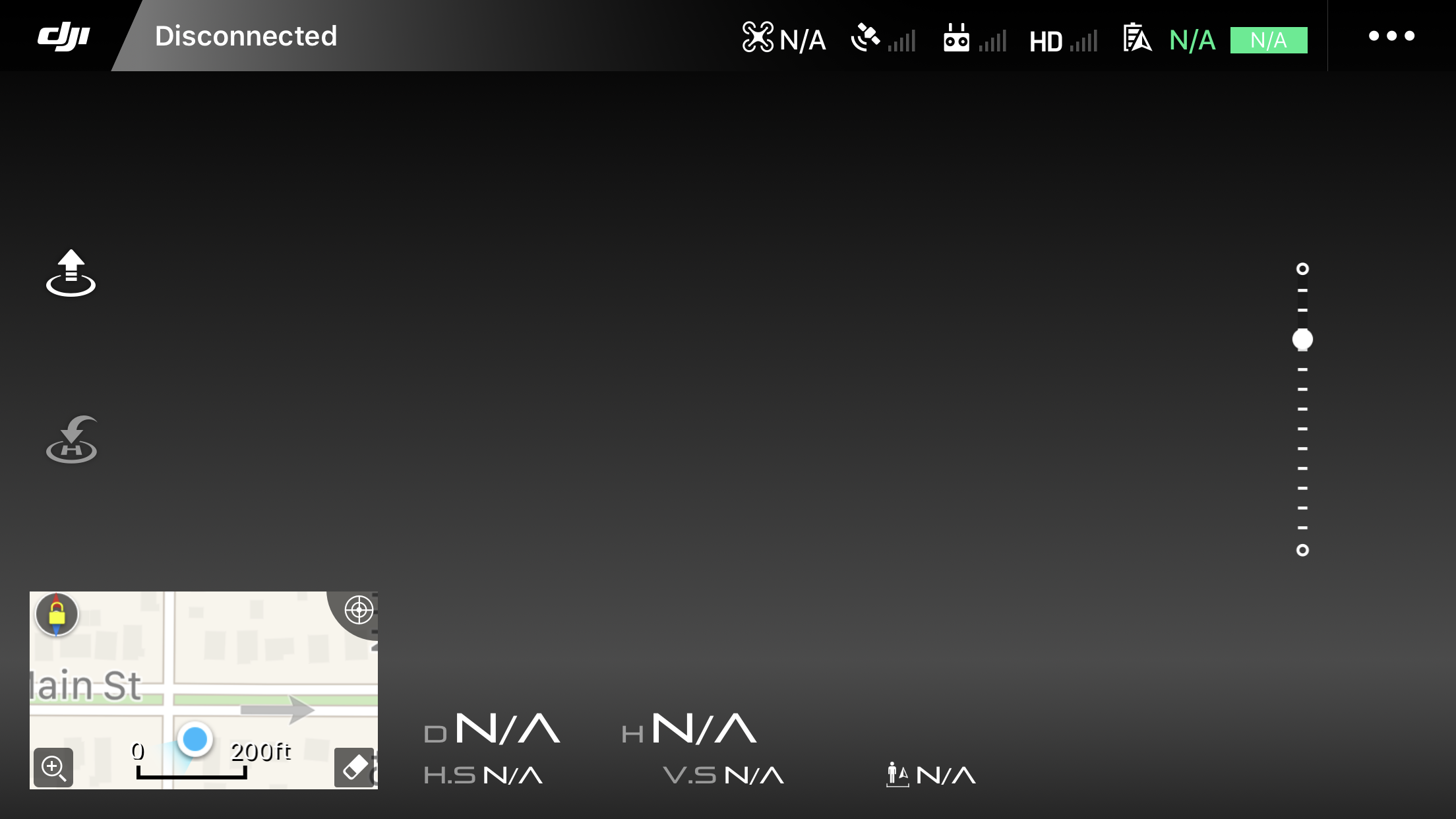

May be a problem of incompatible firmware versions of the remote and aircraft.
That screen looks like Dji Go for the P4. If so it will not connect to your P3P
Nope, that is the same DJI GO app I have been using since I purchased the P3P several years ago, and yes, it worked perfectly until this week. Last flight was in October of 2019.

Hello all!
It has been a long while since I flew my P3P, but today I was going to give it a go. My RC and Bird are connected, but my iPhone 7 Plus will not connect to my Controller. I have tried three different cables, and a plethora of other suggestions, but still no success. I can move the camera with the up and down camera roller. I can also start the propellers by holding the toggles down and in, as well as shut them off. I have looked everywhere for a solution, but I have found nothing. I even did a search here, and came up empty, so I apologize if this is a repeat thread. I just want to fly my P3P and take some photos, but that is impossible if my iPhone won't connect using the DJI GO app. As far as I know my app is up to date, as well as the bird and RC. I also hear that the Mavic Pro is having the exact same issue. Did DJI BRICK my several thousand dollar investment?
