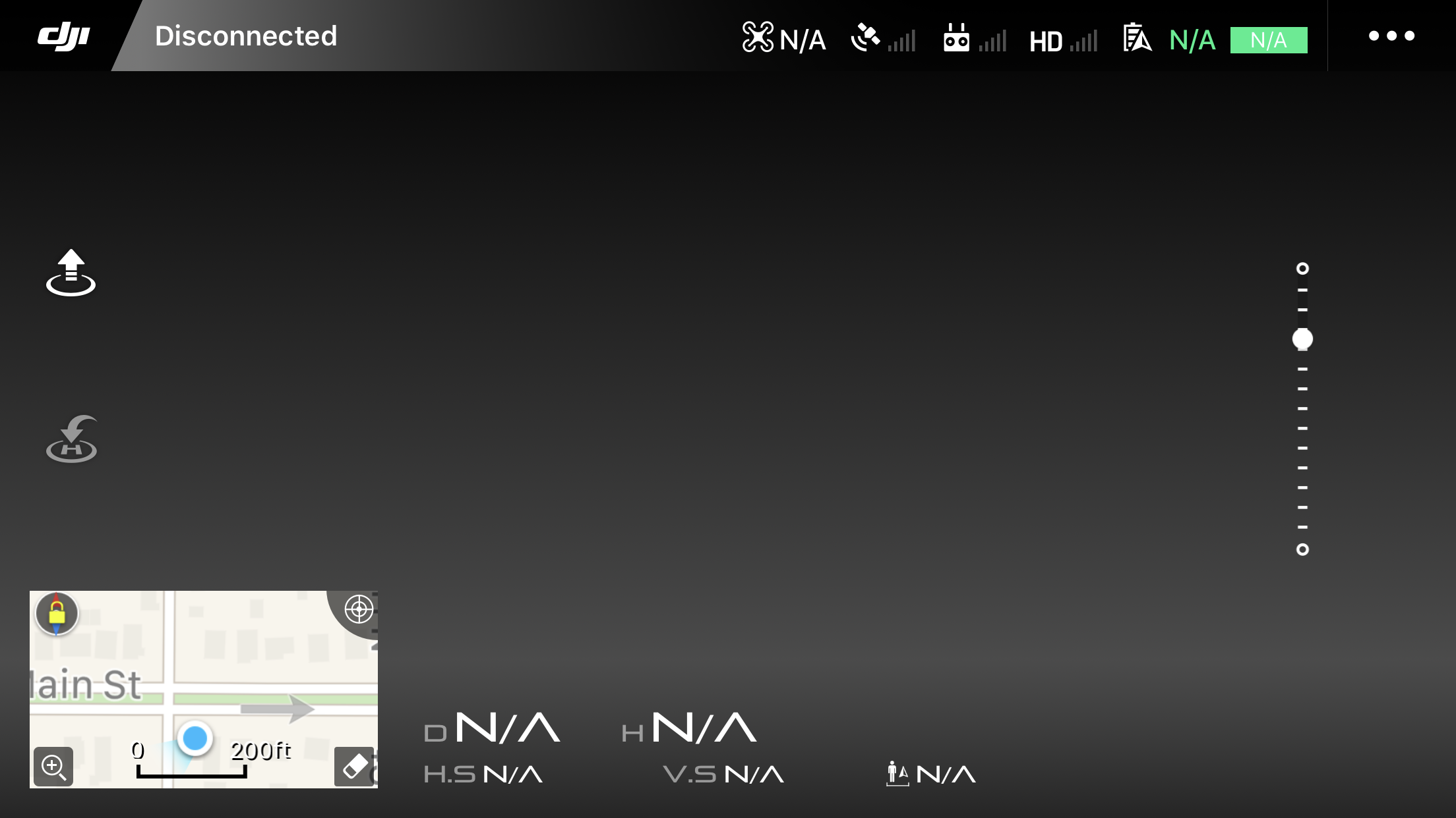

Yes, my phone will not connect to the RC. Nothing at all! I tried three known good cables too.
